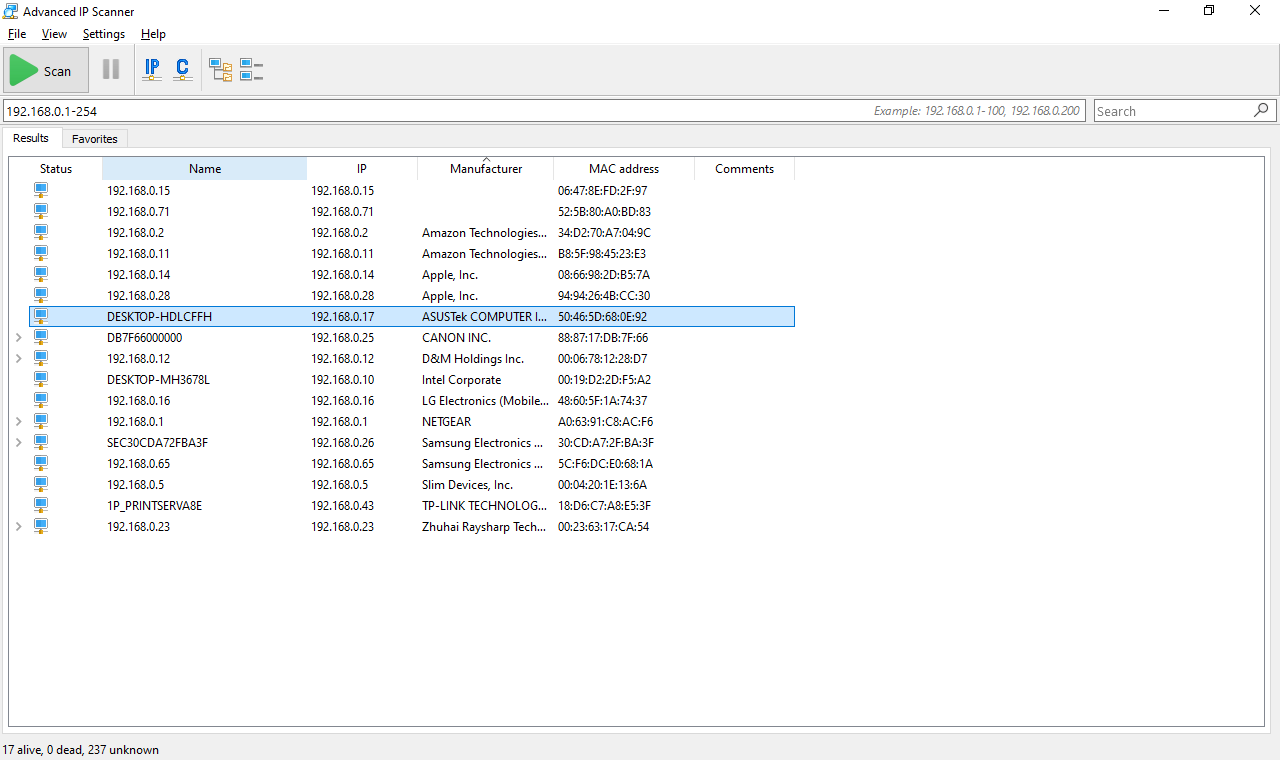

you probably need to install advanced ip scanner.
if you have a new ip address (in the same range [subnet] ) it will show. install the program, do a scan, sort by manufacturer.
(assuming you have a lot of devices on the network
if it doesn't show here it's time for a more advanced lesson, how we find devices no longer in our subnet, but, one thing at a time
