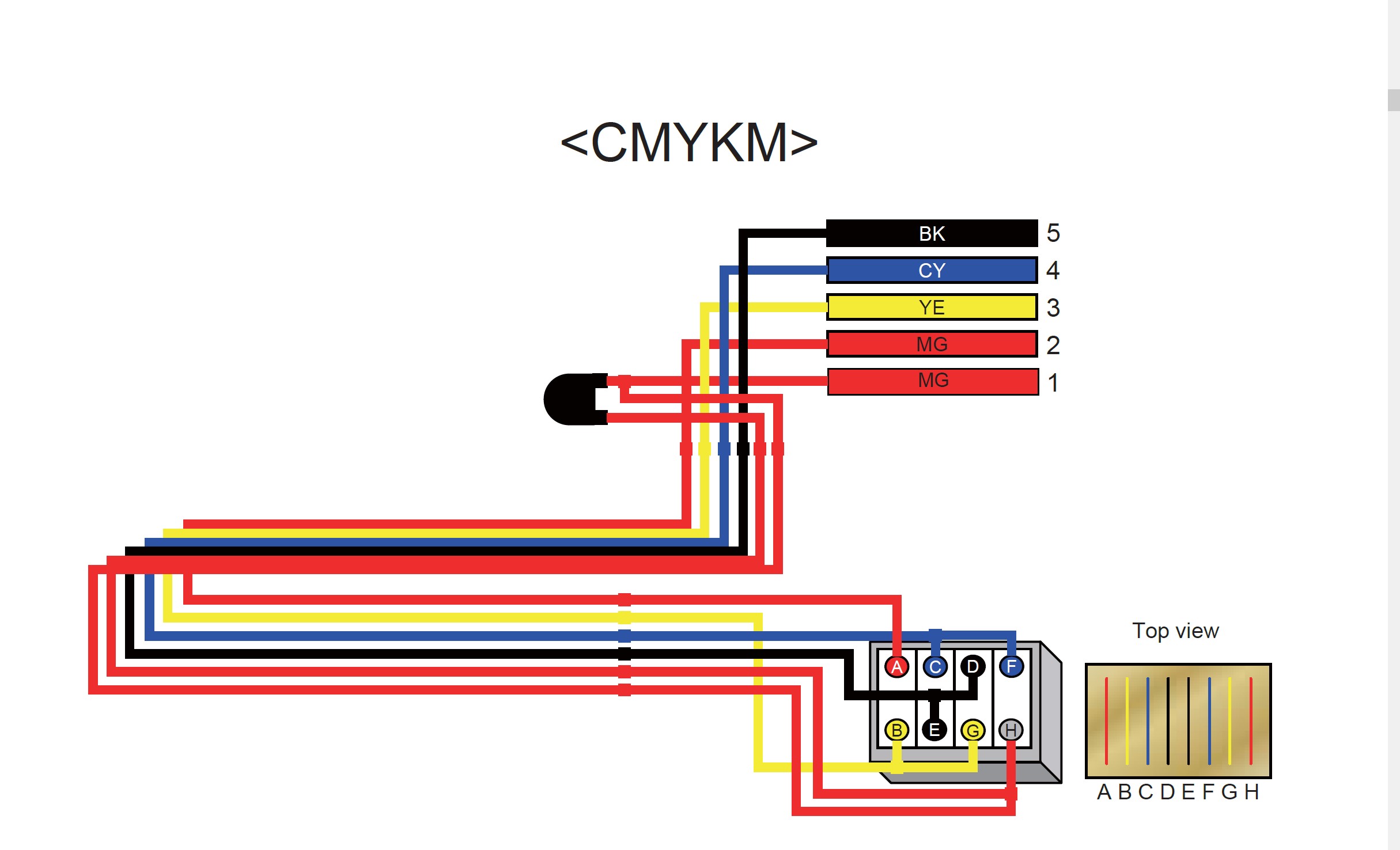

so the ripping software always tells me to remove inks and shake I did that once and now both my magentas register as 100% full. Will the printer just know when these run out? Aslo, do I have to run two magentas? i swapped them because the first magenta never went below 100% so i figured to swap them to get the old ink to be used. Does the bn-20 not require two magentas? and I can just leave the first slot empty with no ink cart in it? Please let me know what knowledge you guys have so I dont break anything lol

you have to match one of the preset " ink sets"

Another thought... I would bet your printer and software are configured as CMYKW. This would be why you get the "shake ink" message. That is usually when white ink is involved. The other inks should only be gently shaken when installing a new cartridge, and do not need to be shaken regularly, and I would actually not recommend it, unless the particular printer model recommends it, like on some of the newer Rolands that use pouches. The pigments in CMYK cartridge-style printers typically do not "settle out" like white ink does, and you could possibly introduce micro bubbles into them if shaken too hard. I would also venture that if you change the printer ink configuration in both the printer and VersaWorks to CMMYK, you will no longer see the "shake ink" message and you will start seeing the first magenta ink level going down. I would be curious to see a nozzle test print both before and after you change the ink configuration.

thank you for the reply. So never take the inks out unless its powered off only take them out when powered on to replace them? and I will double check the CMMYK. but since both magentas say 100 percent now will the printer just "KNOW" when they actually run out? and start beeping? I just dont wanna run the lines dry!!!

When you have two magenta channels, it doesn't print with one of them (except when doing nozzle test prints or other internal prints.) You'll want to swap the oldest one over to the active channel (the one that is magenta only) to keep your ink fresh. And as cornholio said, these printers go through ink very slowly, so it is important to keep the pigments suspended by shaking them when requested.

So, even if the ink configuation is set to CMYKM, the second magenta channel is not used during actual printing?
