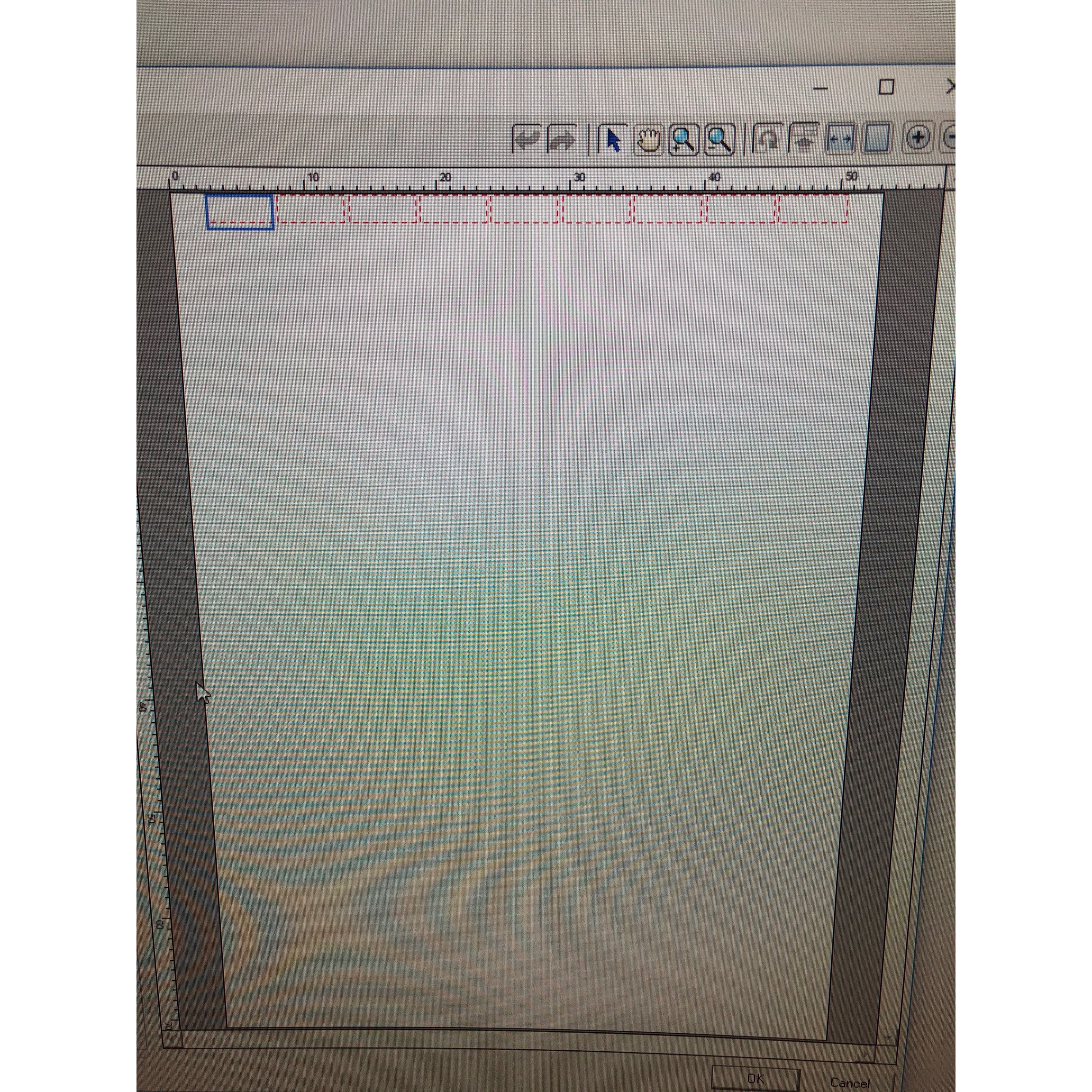

altereddezignz
Thank you everyone for all the reply’s. I didn’t realize it would cause additional wear letting it only print the image areas. I have no issues letting it print full width.
As far as the black I still have the issues.

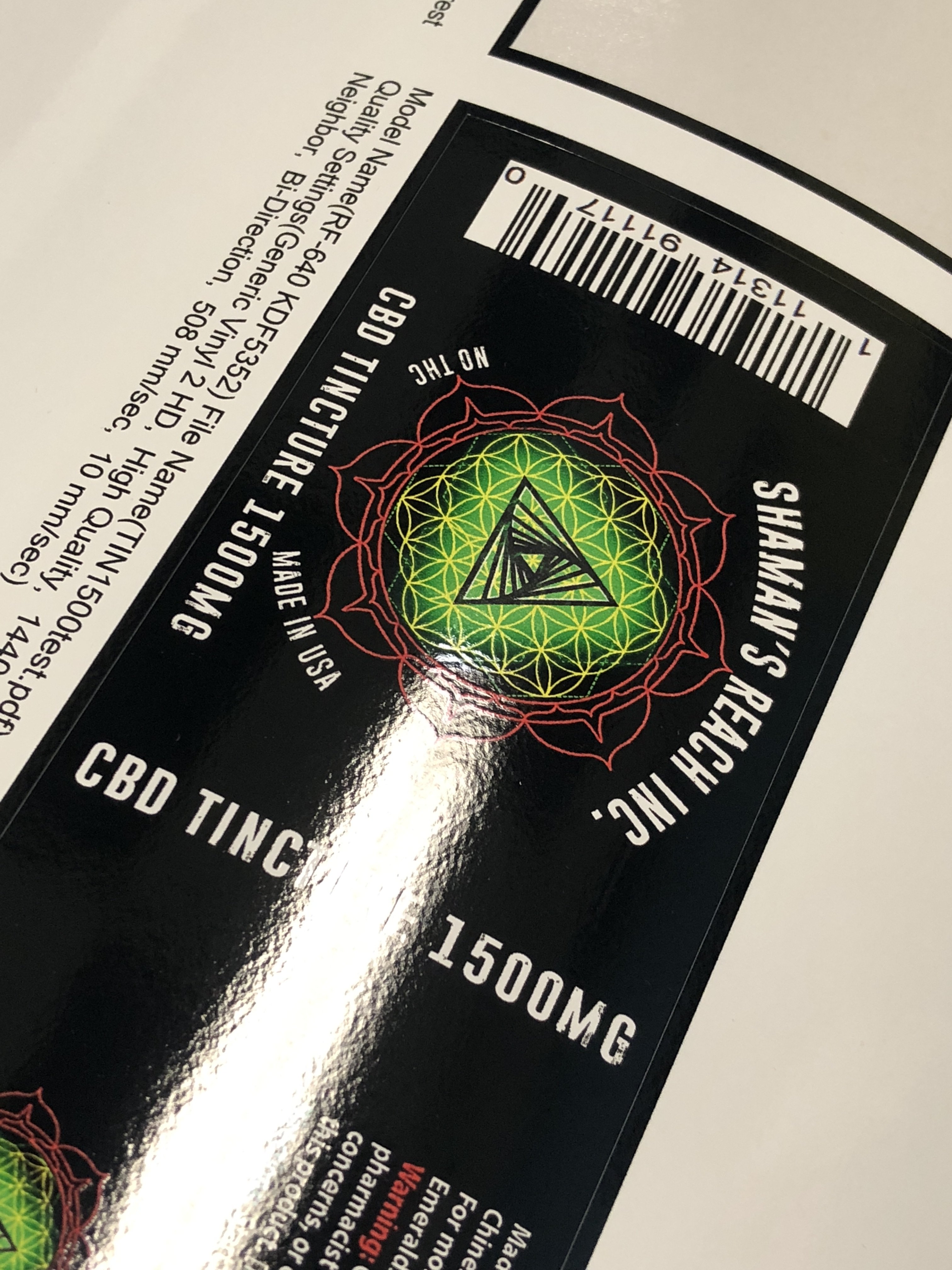

I have printed rgb at 000 and cmyk even up to 100,100,100,100 ( yes I know it’s actually only like 86,90,95,99 or somehow close.). I used the bk21 and the bk22 on a cmyk and a rgb file as well and get rather close to the same result. The ONLY as I can get a real fully covered true dense black is to print 720x1440 10 pass with the vinyl 2 hd high quality. Even downloading specific profiles for the specific media results in a blac that looks as if it needs another coat. I should have took a few pics last night of it.
I attached an image of the last print I did using that setting and profile. Created a good print but on the epson I was printing on we could do that on a 4 pass.
I’m watching videos and swing images of people printing on 4-6 pass and getting deep dark blacks and don’t under stand the issue here.
I’ve tried no compression pdf. EPS with embedded profile. I know that the picture I posted was of a label with small text but before this I was just using a file I created that had 3 4x4 black squares with each color mix saves as a eps and and as a pdf in each the cmyk and rgb.
The kicker is I can print a file that has registration marks the the circles for the reg marks are dark pretty prefect black?
Oh and one more. When I print a file and tell it’s a print cut file and it has reg marks it always prints the right side right on the edge of the file and left side has space even tho it prints the image center of the page.
I will have to get pictures to make sense.
Sorry for all the question but Roland software is really new to me and this is the first time using a Roland printer.

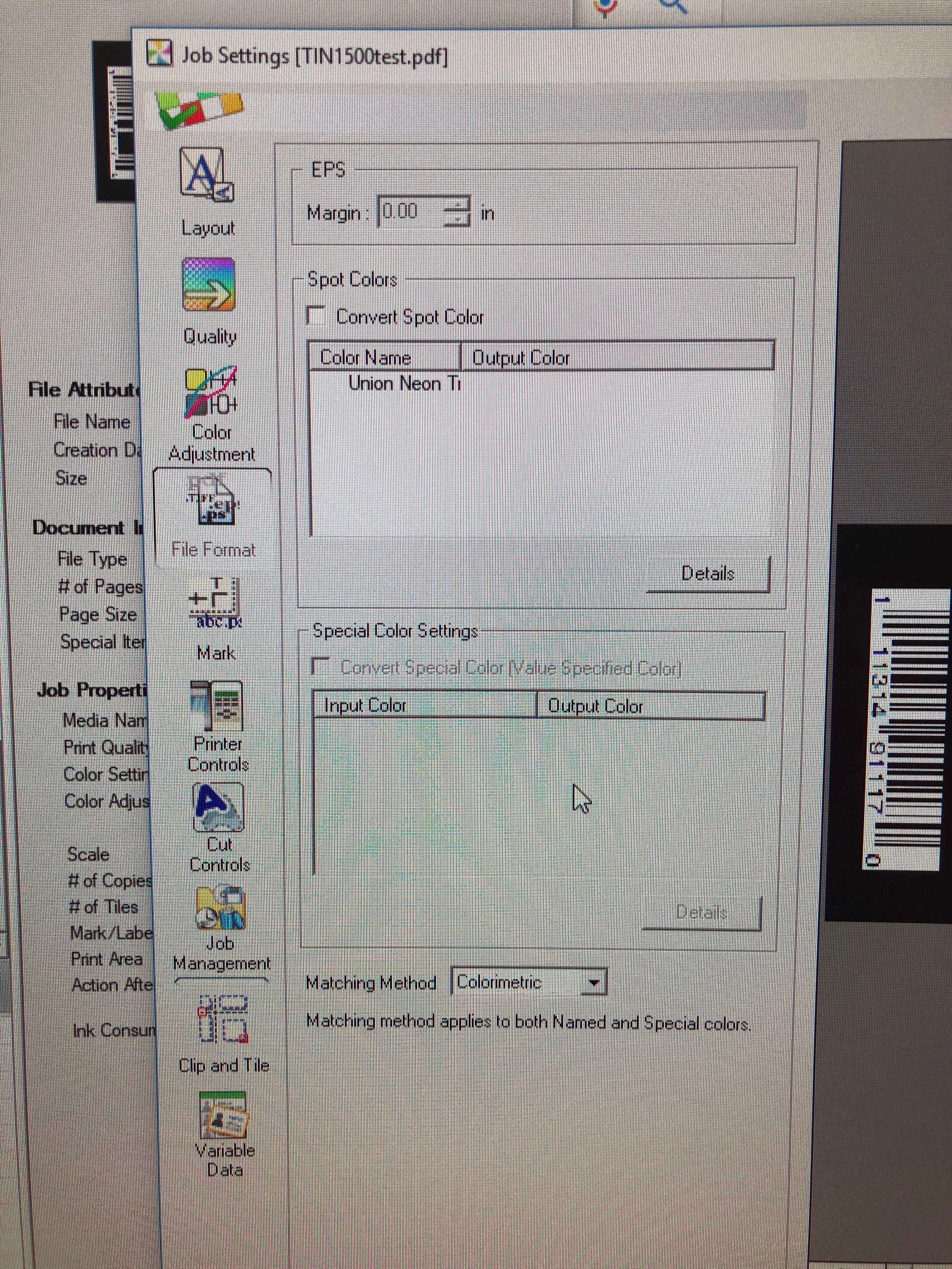

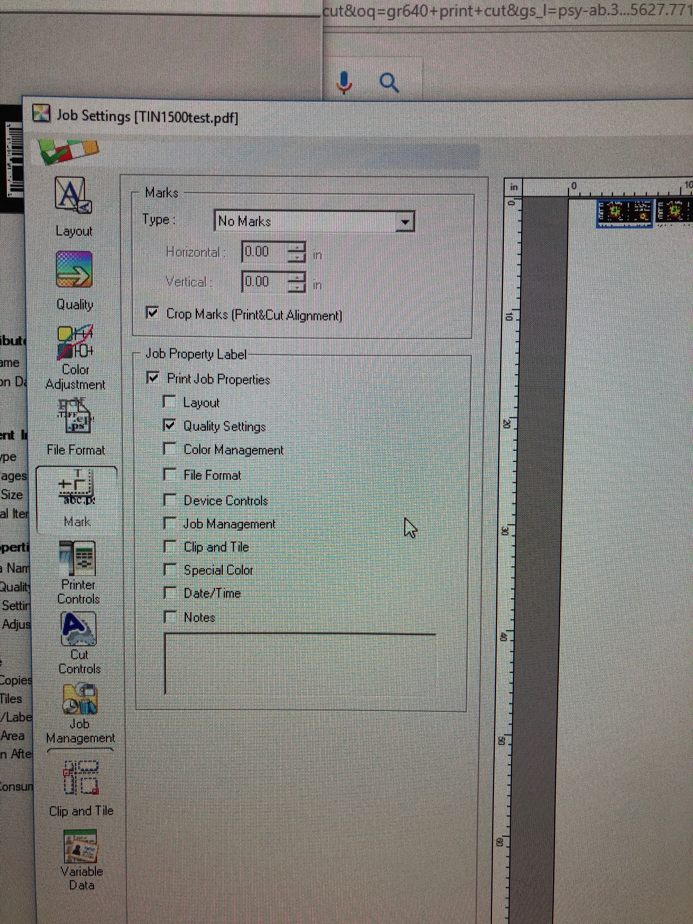

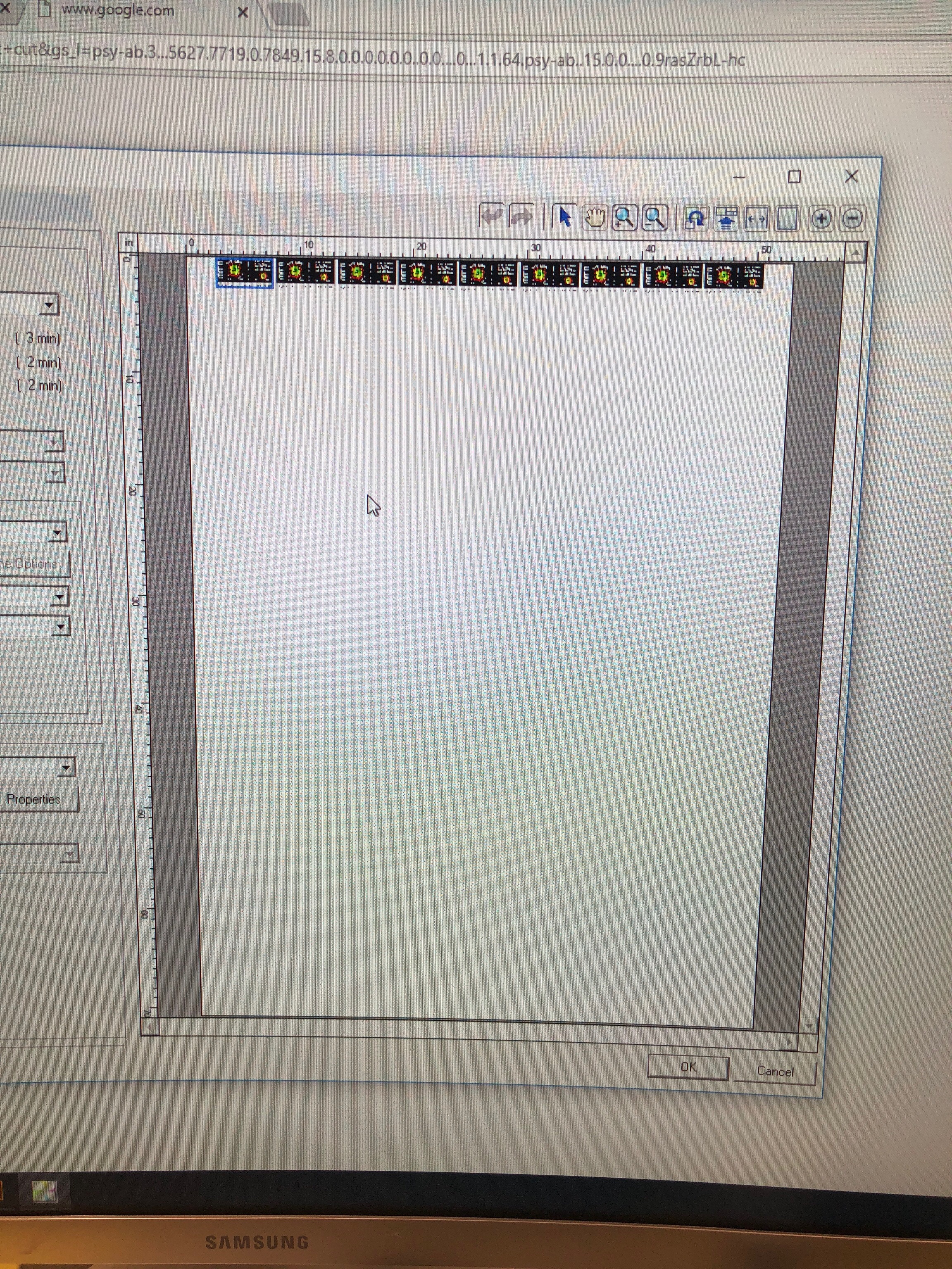

altereddezignz
If it help any here are a few snap shots I took of the software page settings that I did take.
