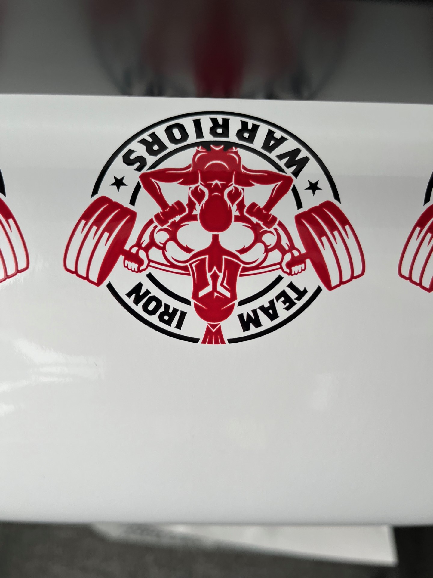

Purehobby
Roland Inks, BN-20 and I have adjusted color management down from 100% on all but still coming out dark red. Picture attached
weyandsign
What are the CMYK values of your red? It looks like it has some black in it. Color management, I think MAX density U.S. works best
