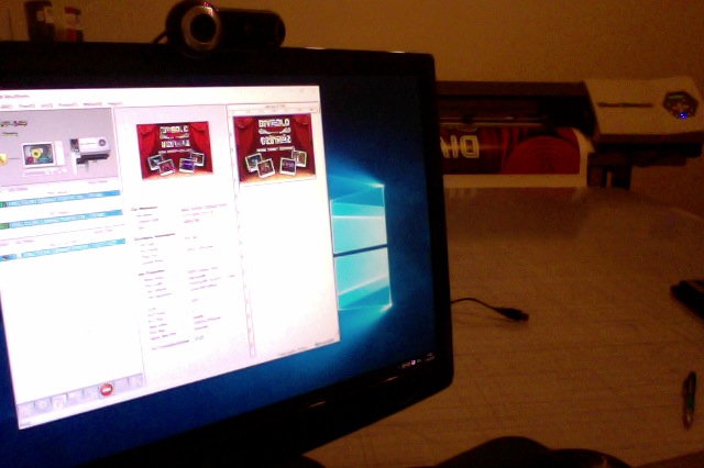

its printing
Versaworks prints and cuts on windows 10, you don't need to use compatibility mode!!!!
