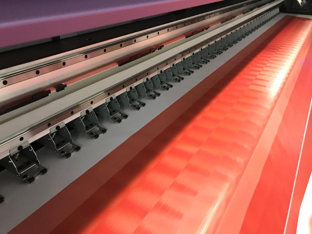

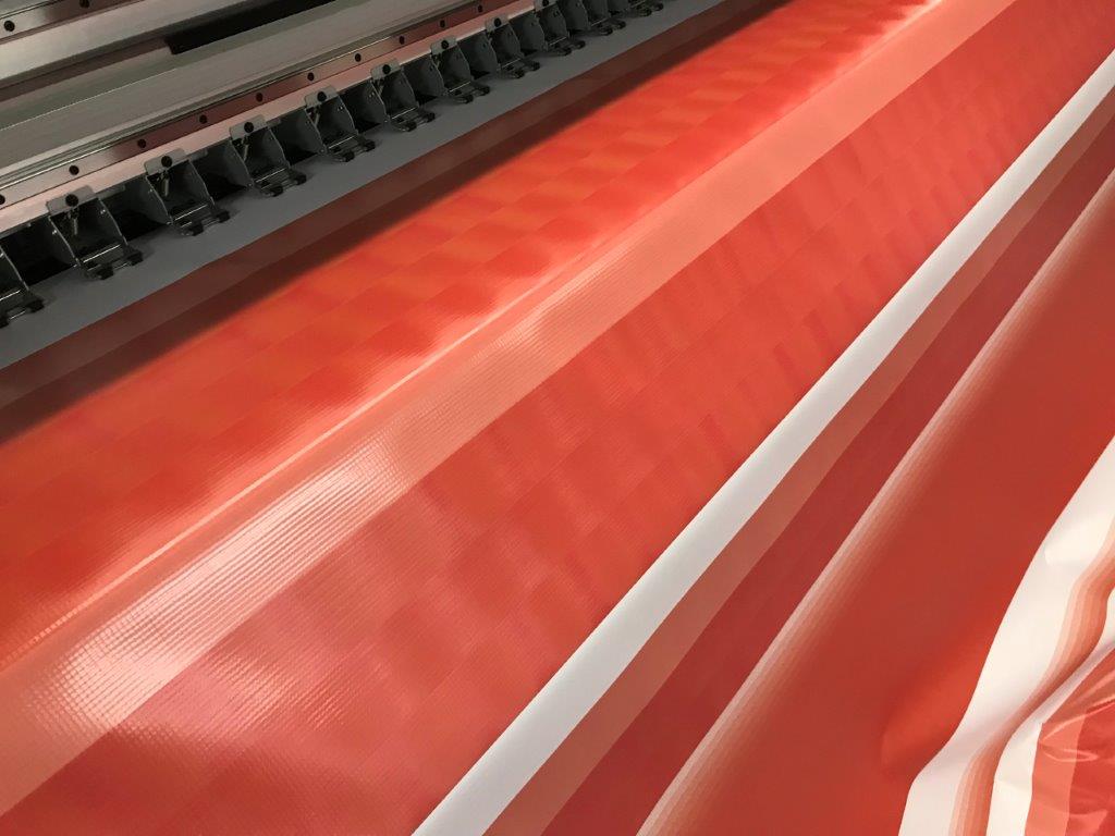

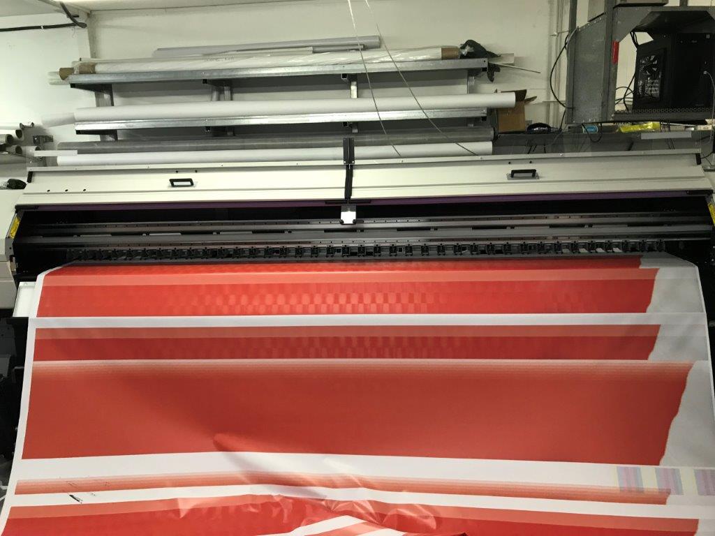

We just bought a brand new Mimaki UJV55-320 and we have severe and strange vertical banding in 2 passes and 4 passes .
Very disappointed with Mimaki since it’s been 4 days the machine is installed and still no solution!!!!

Unfortunately with all material. Actually before we purchased the printer we tested the same materials on exactly the same printer in Greece and there were no issues/problems

Try to print whith unidirectional mode to check if is making. but i think the problem will be in the lamps that are not working ok.

To me, it looks as if your signal is constantly being interrupted while sending. Not randomly, but constantly. I'd check cables and inputs, ethernet and signals for possible losses. Something must be interfering with your signal. Is your electric clean ??

Yes the ink will never cure or dry without the lamps. But the question here is not to use the machine without lamps is just to check if is the lamps or not that are causing the vertical banding. When the lamps are not working fine it cause a bad cure of the ink and it possible to see anomalies in the color and printing. Normally vertical banding is cause for problems in the X-assis of the machine (encoder, encoder sensor, engine etc..) but once this machine also the lamps that is going in x-assis its easy to start to check this

I once spoke someone who had vertical banding and it took them 4 months to solve the problem. The problem turned out to be some kind of imbalance in the lamp fans causing the carriage to vibrate during print. Replacing the fans solved that one.
Perhaps try without the lamps fans on JUST FOR A VERY SHORT TIME, and see if it helps. If the problem goes away, replace the fans.
