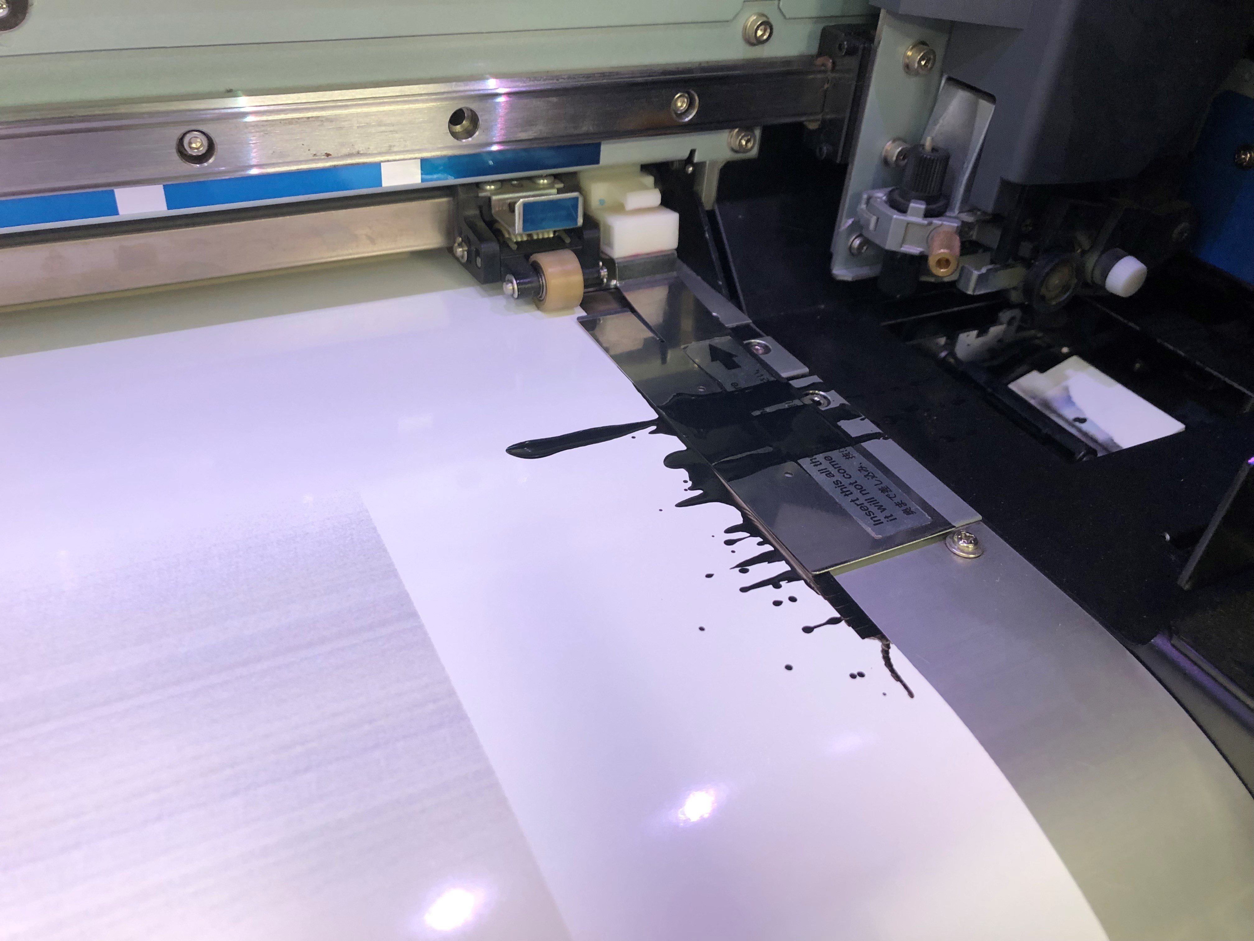

We've had our VG2-540 (with Orange) for about 5 months and this problem has been with it since it started up. Replaced dampers and cap for this head and tech, with Roland, have gone through every test they could think of. Typically we did not control the humidity but have since got it down to 45% with a dehumidifier and temp around 70ºF. Print test is excellent with no dropouts. Black and yellow tend to empty out of the head sometimes while printing; if it's not already weeping.
Usually just drips all over the place and makes a mess. Any suggestions would be helpful. Machine is under warranty and have contacted Roland and our local dealer.

I have the same exact problem with my TrueVis 540 Vg since I purchased it brand new in 2019 only difference is its with the magenta color. My local Roland Dealer has changed replaced the dampers twice and the print head itself and instructed me on how to do cap flushes and the problem is still here to this day! I dont think i will ever buy a Roland product again.

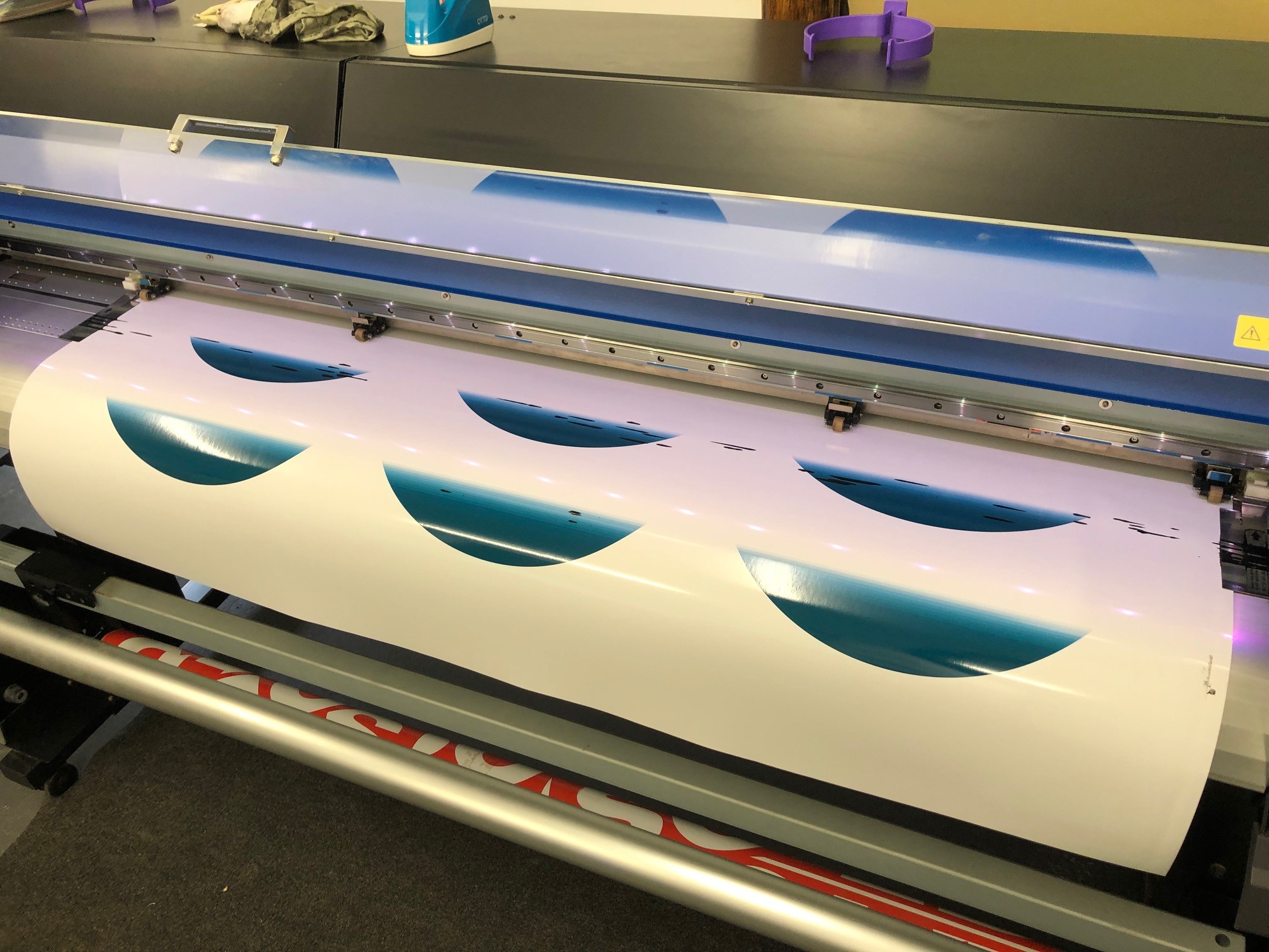

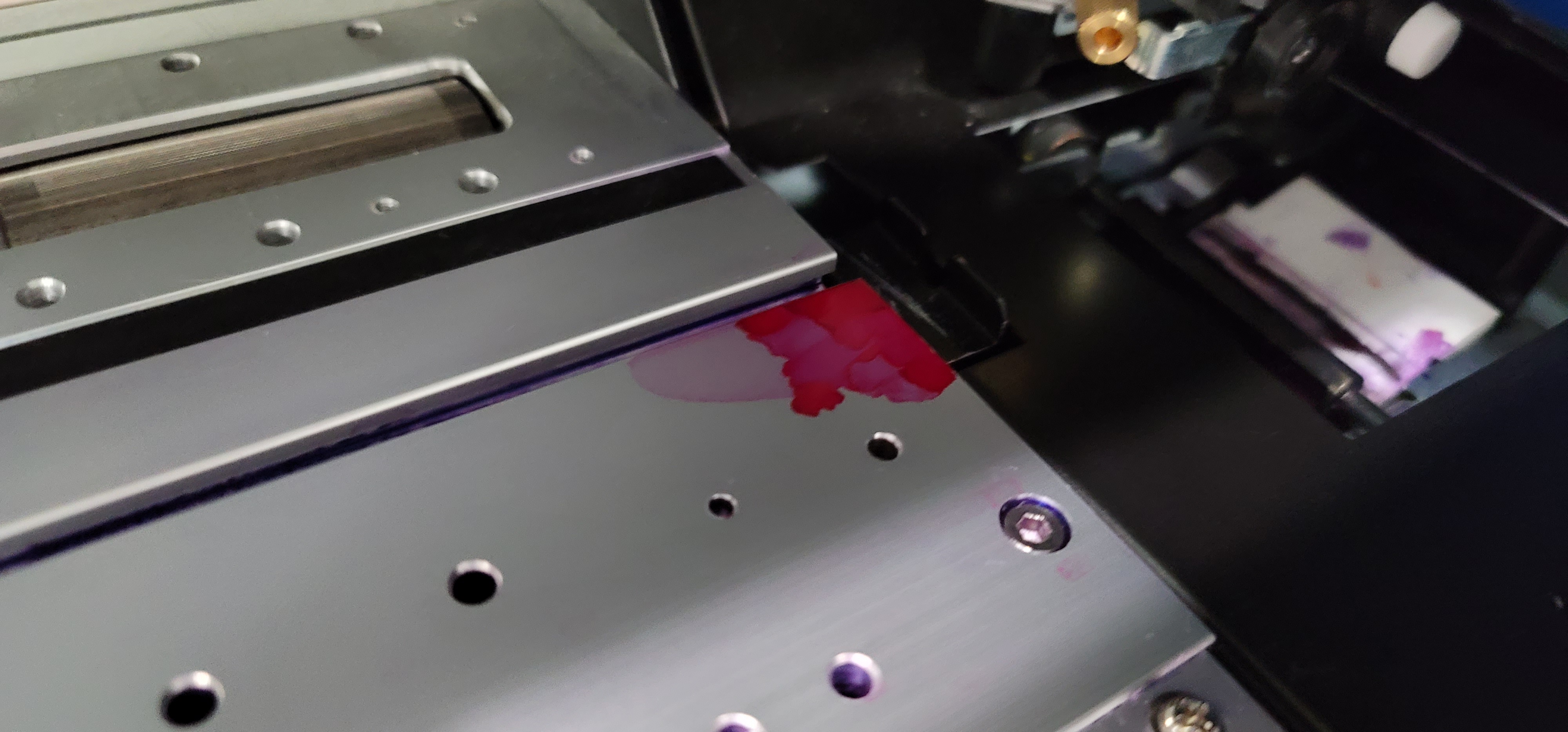

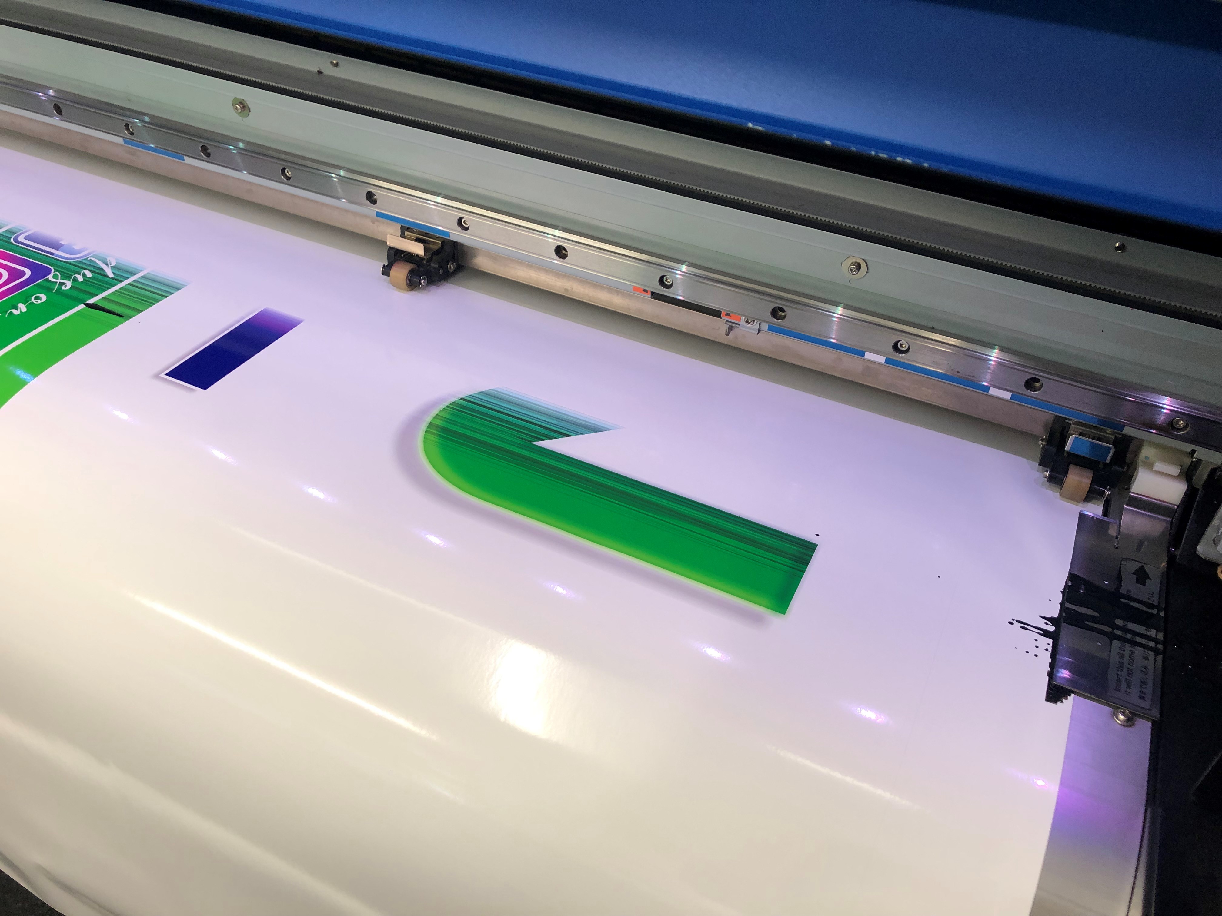

We bought a brand new Roland VG-640 June 2016. In December 2016 it started leaking black ink [under warranty] ..... and still is! We have had almost everything done imaginable to it except having it completely pulled apart. It's had new one way valves, new cap tops, new pressure pumps and pressure control valves, new heads, upgraded firmware, new wiper motor, new servo board, more damper fills than I can remember. Had the system parameter initialised and wiped all information from the main board, then the Tech installed another companies parameter onto our printer - this worked for about 4 months without black ink pouring over everything. The Tech came back and reloaded the parameters again. After us grinding to a halt and not being able to print anything the Roland guy came up and had a look himself - this is now 6yrs after our first issue with black ink leaking. I think Roland has run out of things that can be replaced etc. The business that we bought the Roland from have been amazing and they came and picked it up last week and have lent us a Roland XR-640 Pro4 so we can at least get work out. It is so great to be able to print without having to stand in front of it with one finger hovering over the pause button in case black ink pours out. I don't think I ever want to see our machine again.
Has anyone else had the same issue and ongoing for so long?
