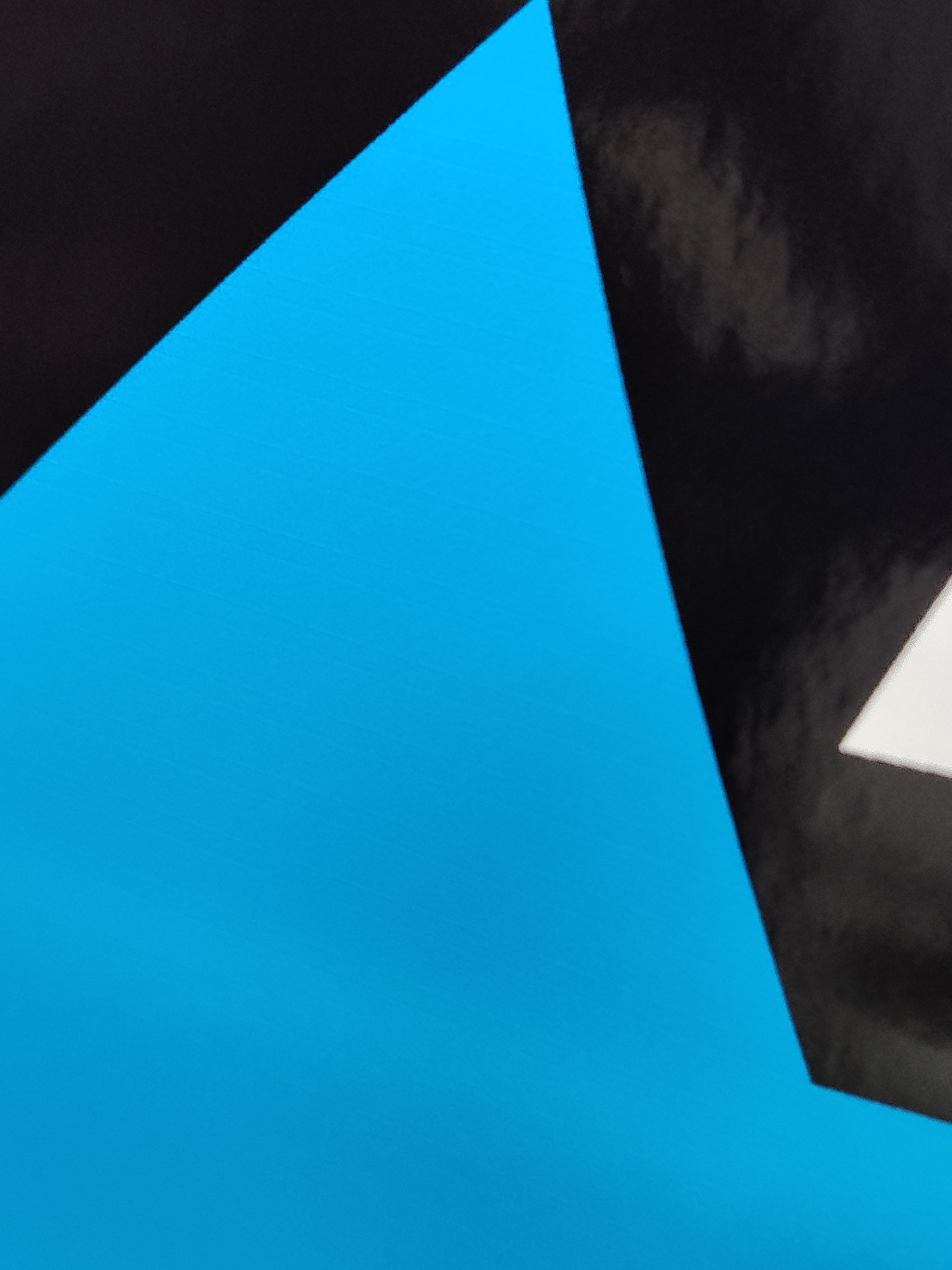

In the last few days, my machine has been banding all types of blue--mainly light blue "cyan" as-well as dark blue. I have tried both CMYK colors and Roland colors.

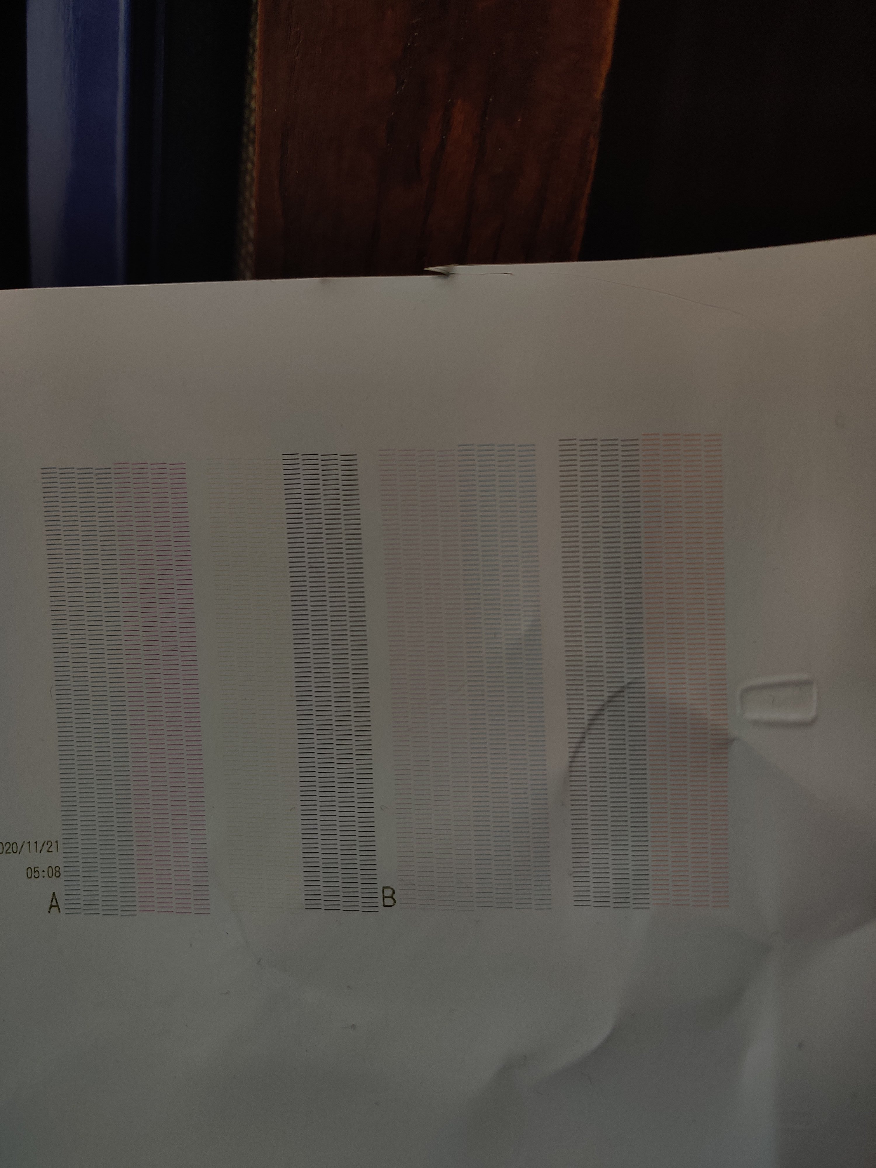

Nozzle tests

From the looks of the nozzle test, everything seems fine! I'm baffled. We haven't changed any printing settings.

Tested a different media type, same issue. No physical damage to printheads. All other colors are fine. Have tried different shades of blue aswell.

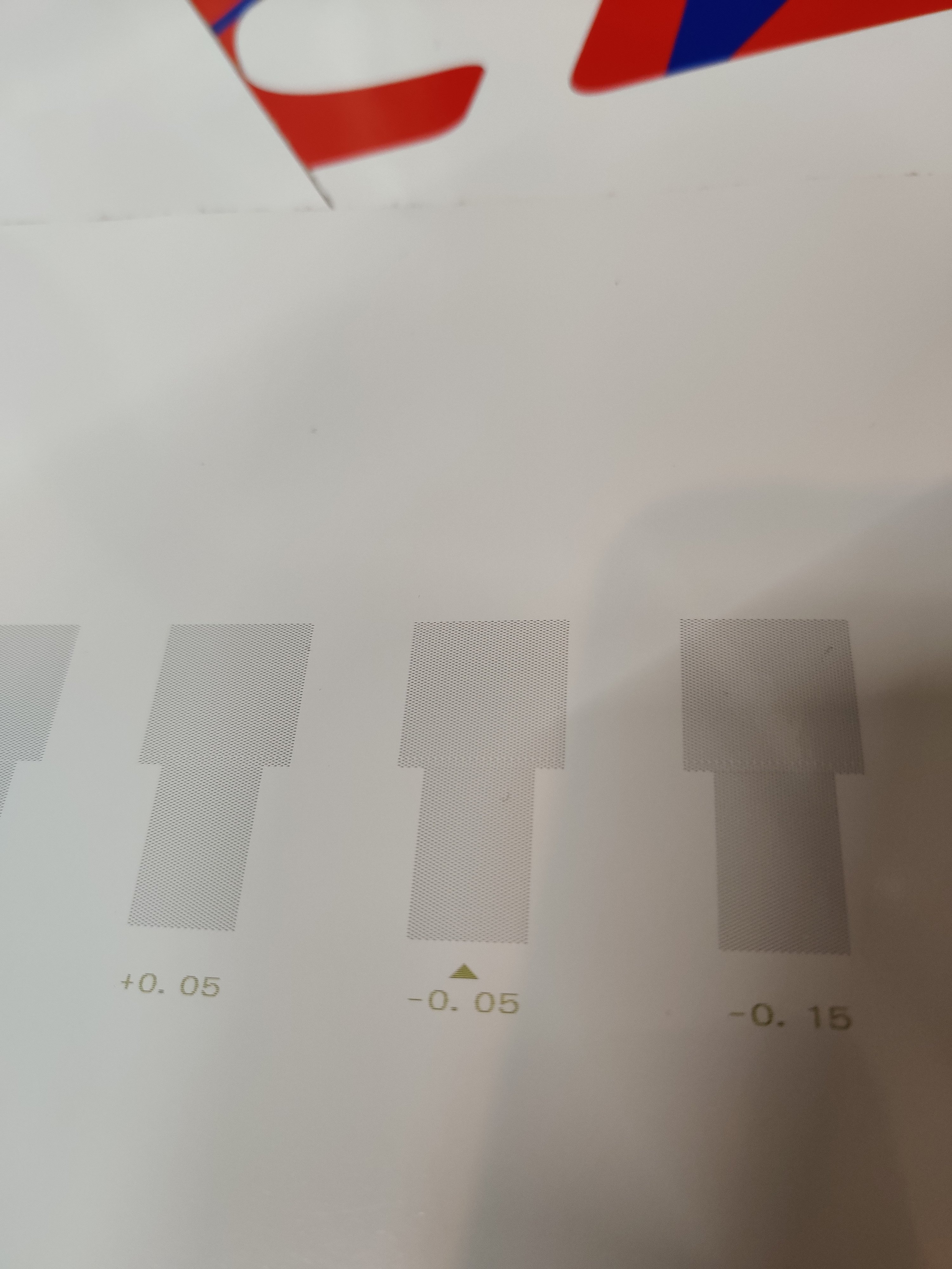

There looks to be a tiny glitch in your feed calibration test print just above where the two boxes meet. I wonder if this is the source of the issue?
It is absolute pure cyan print or is it possible there is a small amount of black in there? Not really sure if the feed calibration uses any more than the K channel.
Pure CMYK Cyan. I have restarted the machine several times and loaded / unloaded media. The feed calibration is the same. Think it may be time to call a technician.
