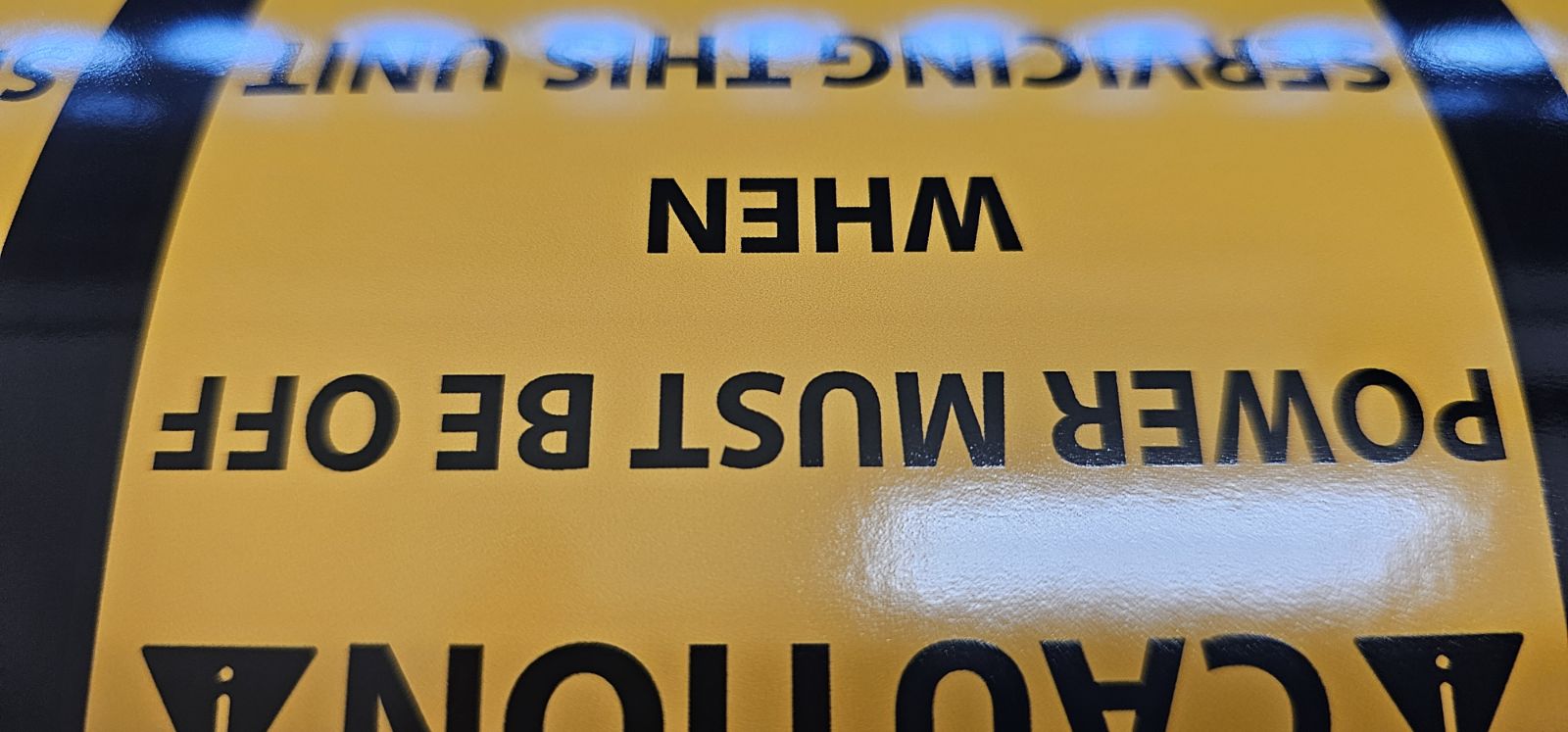

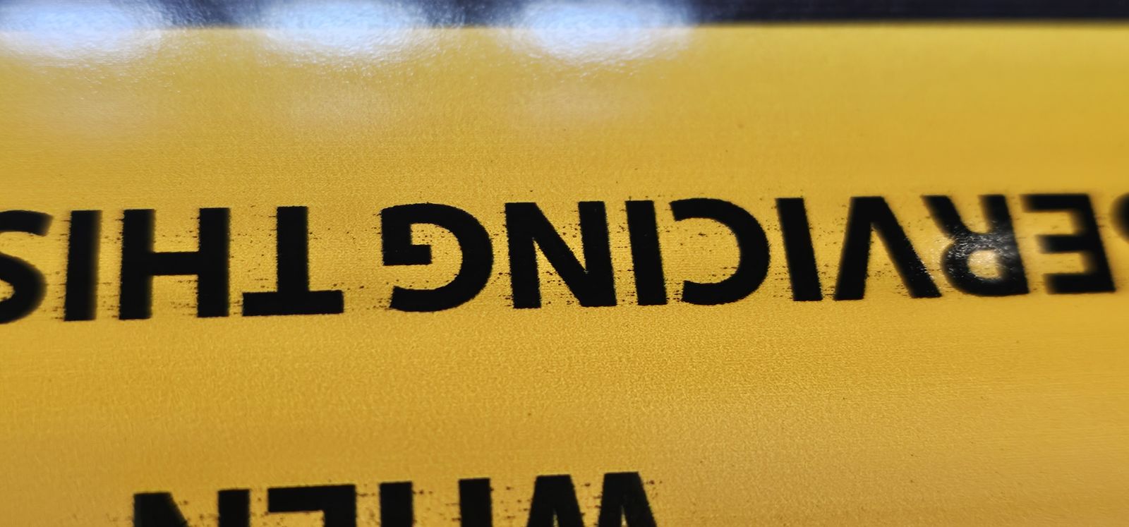

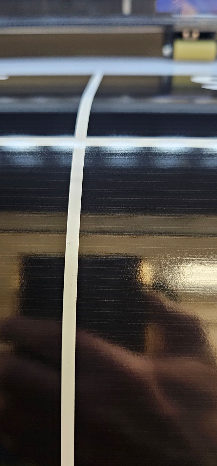

I've been encountering banding issues with my VG3-54 printer, which I purchased on 12/29/22, its a little over a year old. The problem is that the print starts out strong but progressively worsens during the printing process.
It initiates with a solid, dense fill, transitioning into thin banding and eventually expanding into a larger banding gap. When encountering white spacing in the print, such as when advancing the media, it appears to catch up and print 'better,' only to resume banding. The banding pattern can vary randomly, shifting from thin to large, contingent on the white areas where no ink is required.
Interestingly, when I print in Uni-Directional, there are no issues at all. This leads me to suspect a potential starvation issue?
The local technician has already replaced three heads that showed signs of banding. We've replaced the Magenta/Cyan twice and also the Light Magenta/Light Cyan. Although I personally believe that the Light Black head might need replacement as well, we haven't addressed that yet.
We've conducted an extensive array of test prints using various media types and profiles. However, these efforts don't seem to alleviate the overall issue.
I'm curious if anyone else has experienced similar issues or has any insights into what might be causing this. Are there any known fixes or theories?

Tech thinks that it is static; I purchased and installed an anti-static kit and this has done nothing and seems to have actually made it worse. I ordered a humidifier to get the humidity up in my print room and see if that helps at all.
This is without the anti-static kit on bi-directional: Prints start out solid and then I start to get progressively worse banding.

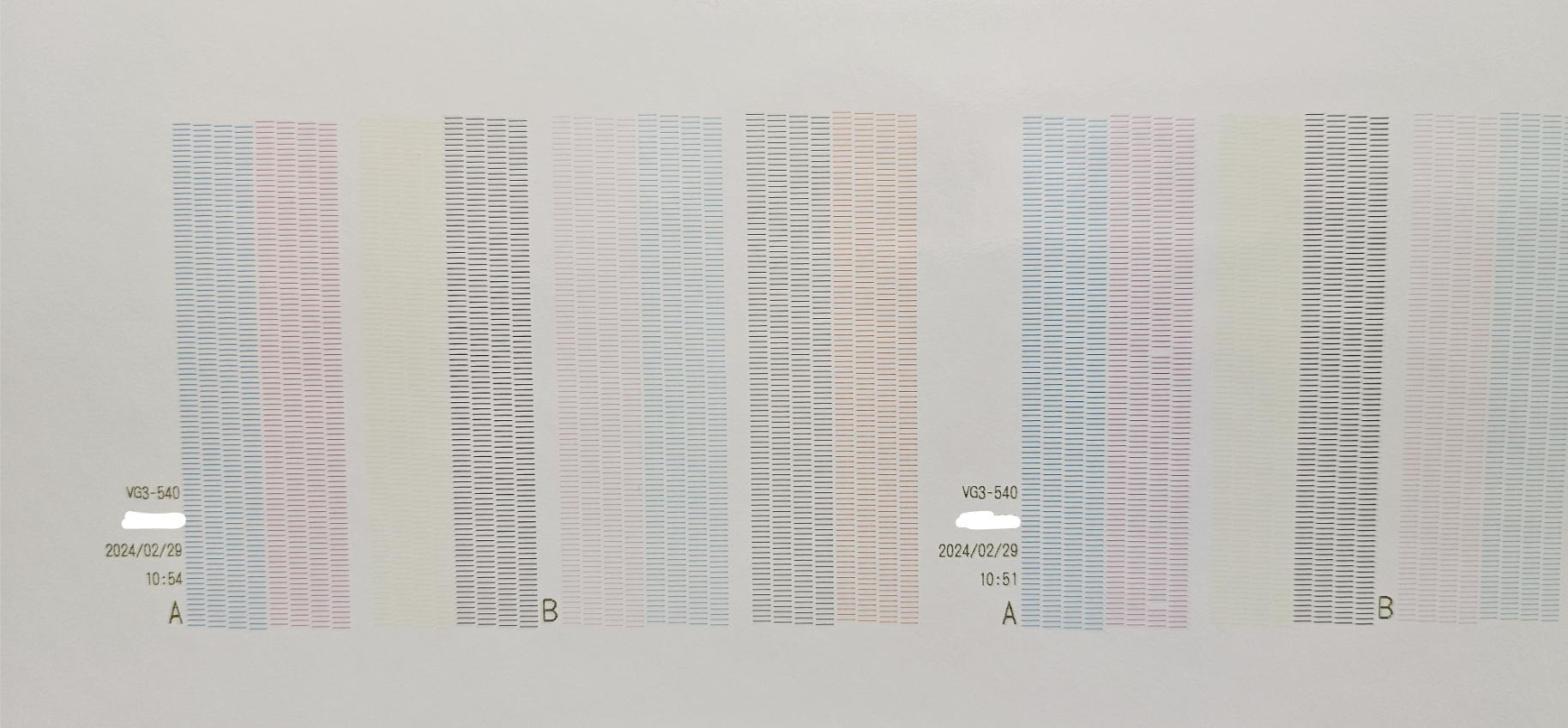

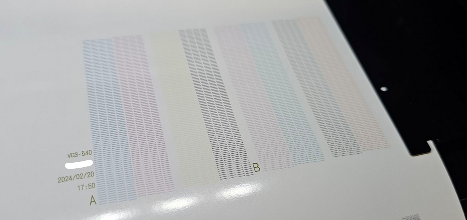

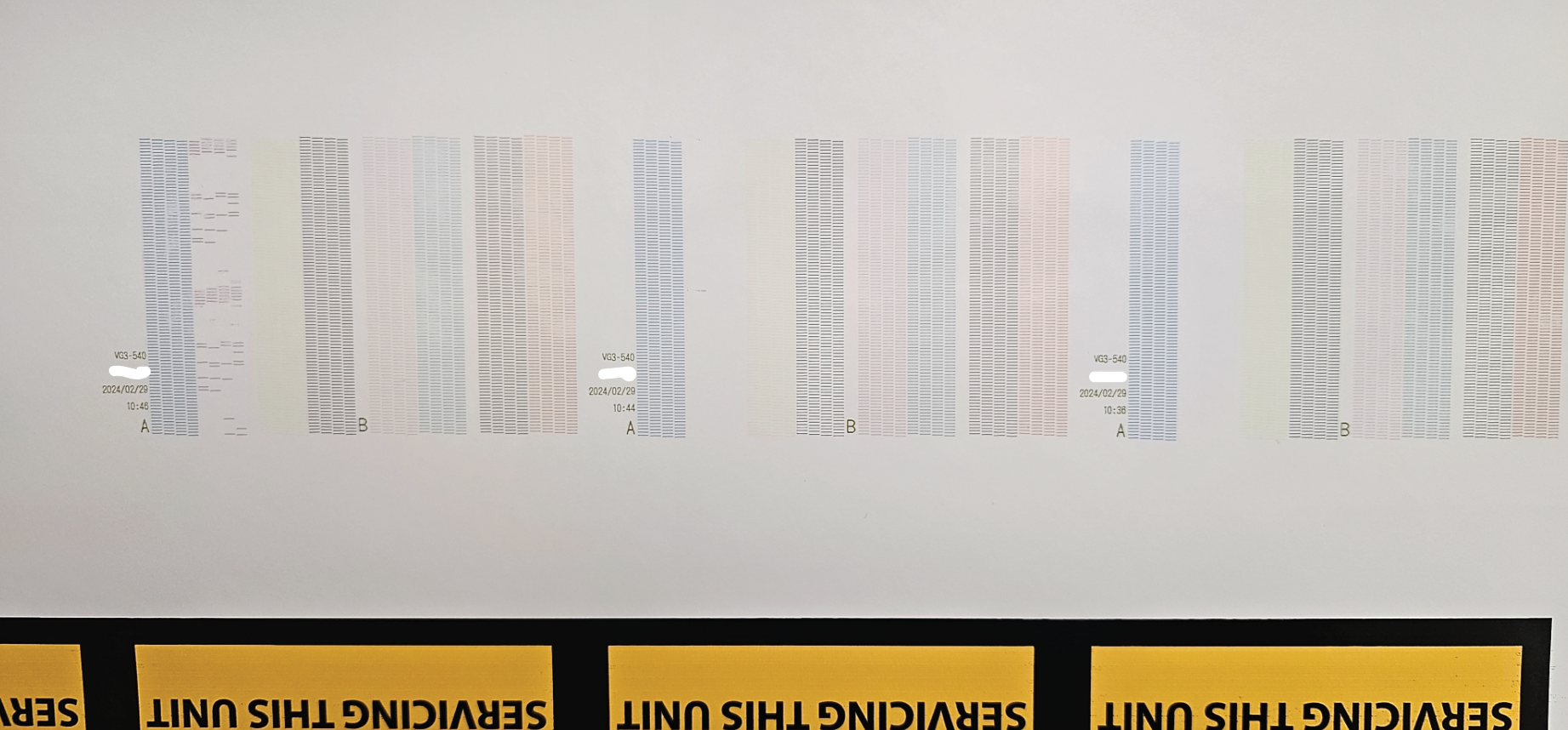

After increasing the humidity to 38%, I conducted more test printing yesterday and encountered the same issues. However, during a nozzle dropout test, my magenta channel (which has been replaced) completely dropped out. I managed to restore it to full functionality with several cleaning cycles.

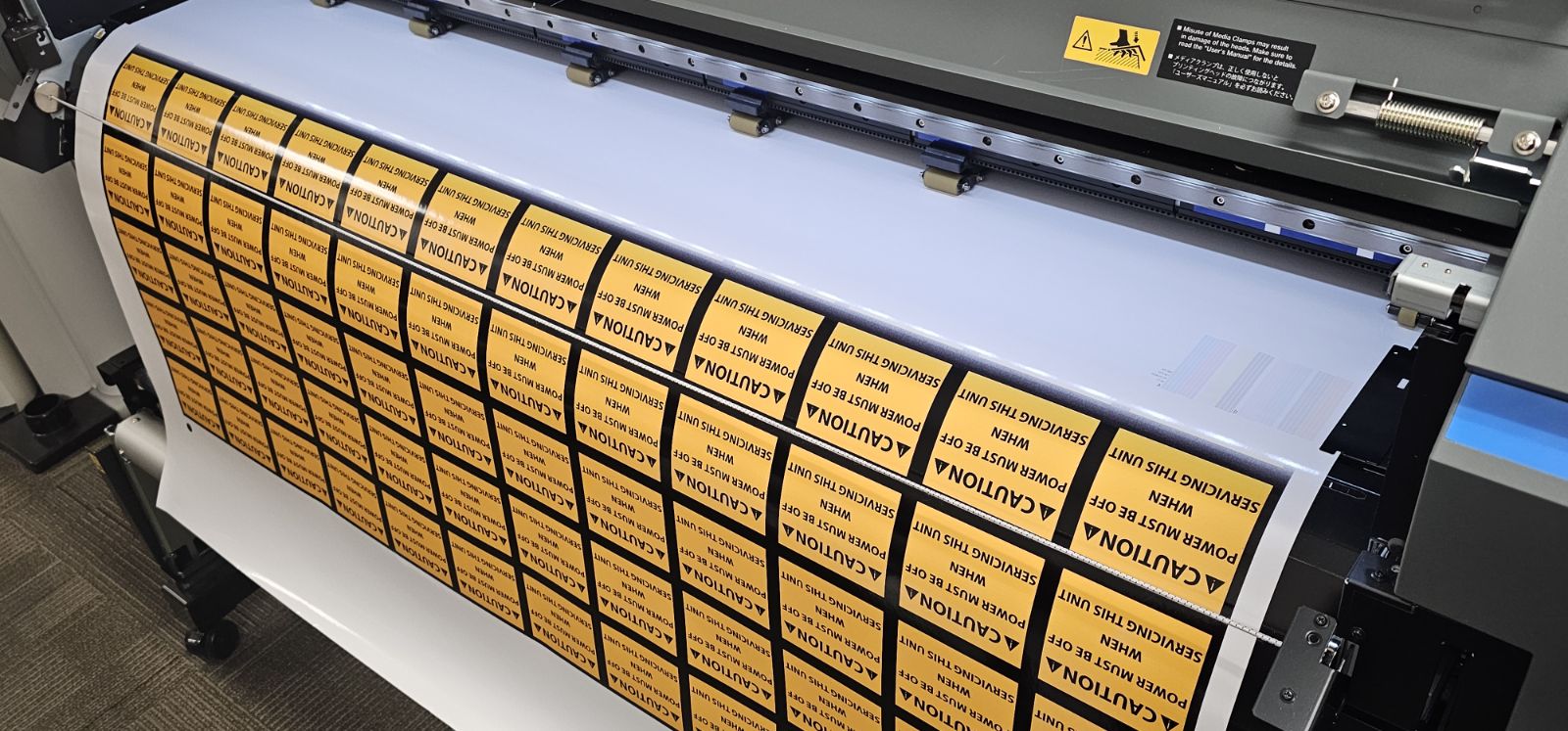

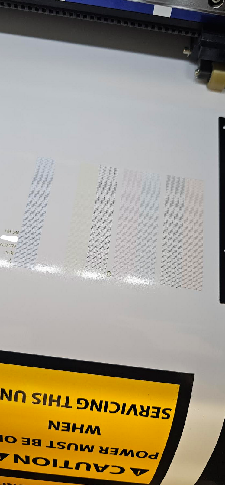

The technician recently replaced 7 or 8 fill sensors, but unfortunately, it didn't seem to solve the issue. Attached is my most recent print from yesterday, done in Bi-directional mode. Interestingly, if I switch to Uni-directional, I don't encounter any banding. However, this method doubles the printing time, and I'm concerned it's just masking the true underlying problem with the machine.
