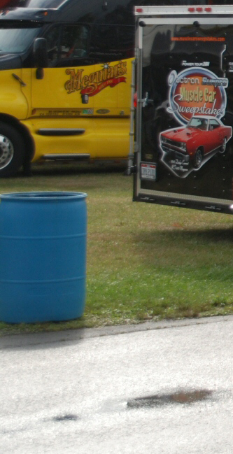

I have a customer that wants logos, about 24", put on thier plastic trash cans they have on thier grounds for events. Need something that will last 8-12 months and it needs to be digital media. I'm considering the Oracal 3951HT but wanted to see if anyone has experience with this type of trash can and what has worked for you.

our local state fair grounds have the same trash cans and they use a paper/thin plastic wrap that goes around the can with logos/sponsers/events on them. cheap and easy to change. maybe look into something like that.
Convex makes a product specifically for Low energy plastics. Convex high bond. 7yr/ 6mil The printable is only in Matte I believe. If you want gloss you would have to lam. Might be an option for you.

if you just want decals to apply to the trash cans only and not a complete wrap around graphic..then we use mactac. they have a product specifically for that kind of use...the name escapes me right now though. its for low energy plastics. convex is very good, but pricey.

We do a TON of decals for trashcans for one of our customers. We've tried ORacal, Arlon, and Mactac and the only thing that sticks well to them is Convex Pitbull, others, including regular Convex, didn't stick nearly as well.

Made by Convex, it's a higher-tack version of their regular stuff. And it is high tack, really high tack. They warn you don't stick it unless you want it there, it's stupid strong. God help you if you're weeding it and you get it stuck to your arm hair.
We buy it from Graphic Marking Systems out of Chicago.
