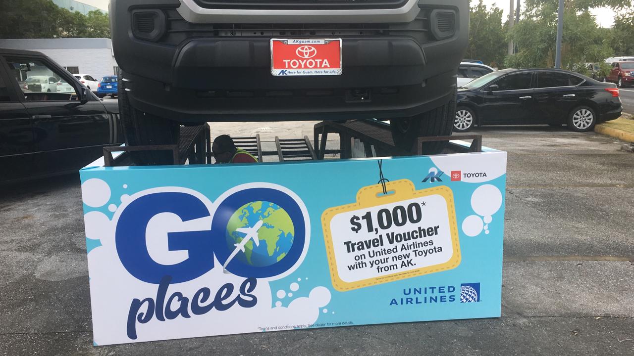

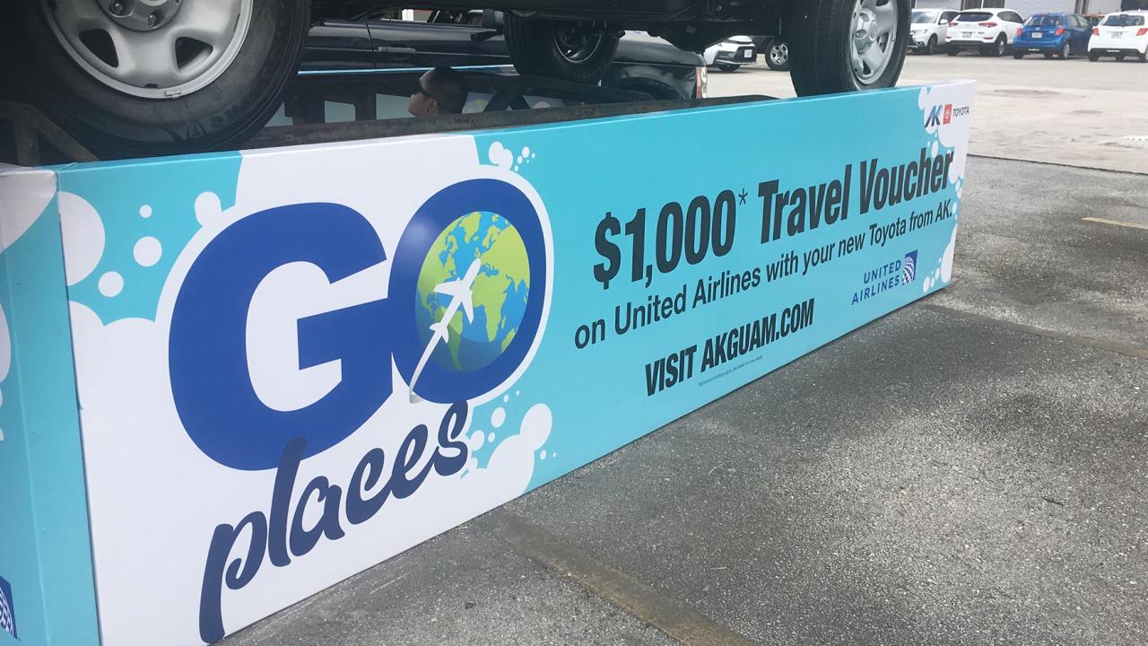

We use 2x4 frames and stretch 13oz cheap banner up to about 16ft x 3.5ft for vehicle ramps we cover.

I'll see if I can find one. Not much to them, just rectangle frames with 2 center supports and angled corner braces.
The lumber I use is really rough as these are just temporary, we use the low cost, untreated framing 2x4s from the hardware store, no prep just put the best edges to the front and go.
I have one guy tension and a second run the gun. One person can do them but it is quicker and tighter with two.

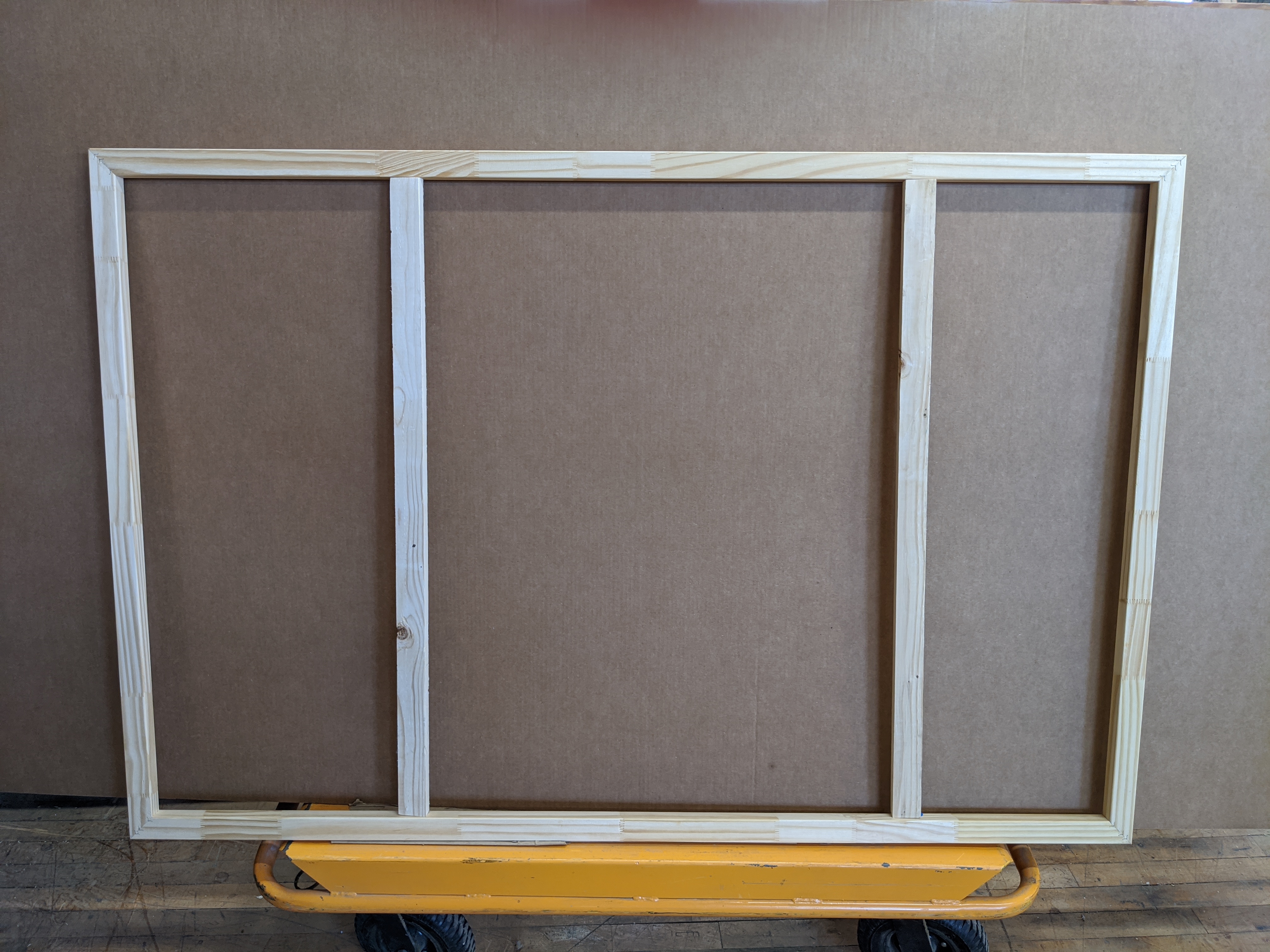

We are a contract picture framer, and stretch canvas all the time. We don't have any experience with stretching vinyl, but we do have a table specifically deigned for this sort of thing. If you are going to do it often you might consider buying one. Below is a link to the company that makes them.
https://machines-etc.com/
We buy our stretcher bar moulding from the following company (model SB9994). It works well with 40"x60" frames and I have included a picture of the braces in the middle as referenced above. This would be for indoor use only.
https://deltapictureframe.com/
Good luck!
