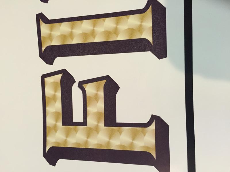

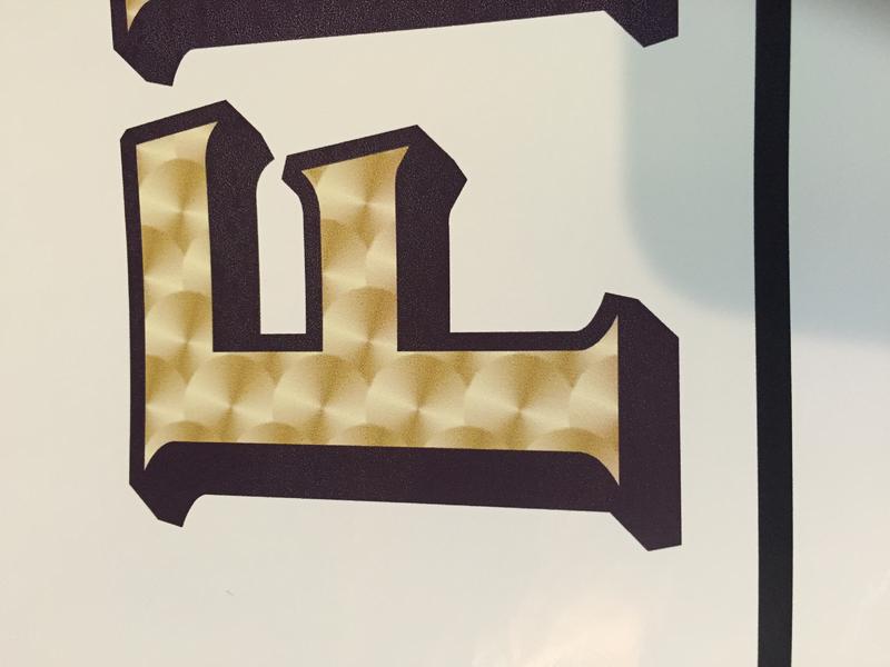

I fixed the blistering issue. There was a buildup of adhesive where the roller in the printer where the edge of the vinyl always runs. It was pulling the vinyl from the backer. So I fixed that, but now I'm having issues with the prints. The color is off and spotty. The black looks brownish with tiny spots all through it... however the outer border that is printed for the sensor on my Mutoh cutter is a perfect black.
Pictures say a thousand words :)
You are right, here are some pictures!
This is with color correction on, running the 3M IJ35C profile in Flexi, 10 pass low ink bidirectional. The black border is fine, but the black in the file is washed out as is the gold leaf. There are tiny white spots all through the print also.

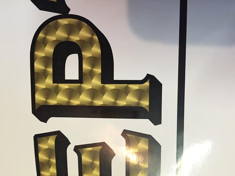

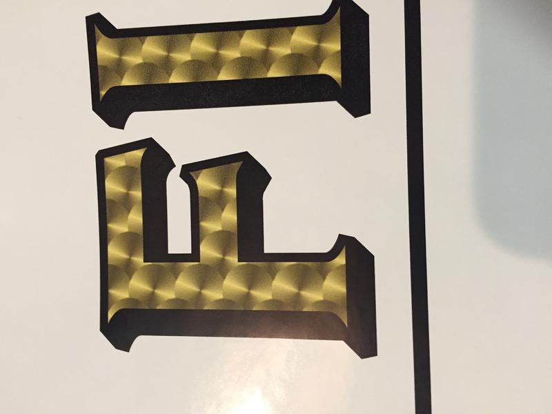

Same profile with color correction off. The black looks better, but the gold leaf is too dark. Still the issue with the tiny white spots all through the print...

Make sure your black is only black in the file.
For some reason, rich black prints a lot lighter than the 100% Black for me.
Based on the testing that you have done (print with color management on and another with it off), tells us that something in the Media Profile is the culprit. With the SAi RIP, it is relatively easy to get the various media settings misaligned (ink restrictions/ linearization/ ICC) and when that happens, print quality can decline sharply.
I would suggest deleting the media from the RIP, and then re-install the media profile again from the packaged file into Production Manager. If you are designing in an outside application (Illustrator, Corel, Photoshop etc) you might be better served to bring the job into the RIP (PM) directly as opposed to importing it into Flexi.
