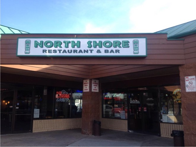

I'm almost finished with it, and I'm liking the wet application. This design has drop shadows in a different color and I've found that I can hand position each shadow in place perfectly and then squeegee it down. It's taken me all day...so I hope to become faster...But this is a big sign, more than 10 feet long...

Thanks for all the advice. Here's a photo of the sign I installed today. I'm jazzed!

This design is mine, based on the logo I designed for the T-shirts I did for them this summer. I tried to open up the drop shadows a bit with a little white space but they liked the solid green/ black combo, so I did as I was told.
