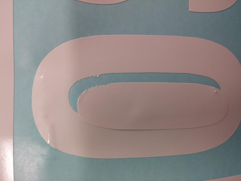

Has anyone had this problem? I have a Roland Camm-1 PNC1100. She's a dinosaur, but she's always worked till now. I've tried different vinyl, different blades (45 and 90), i've tried less cutting pressure, more cutting pressure, new cutting strips and praying. Any advice would be so awesome. Thank you!!!!

That looks weird. When was the last time the you opened her up and blew all the dust out?
+1 to that just as a regular thing to do but i think it might be the blade holder sometimes they go bad and do stuff like that.
try cleaning/blowing out the holder and putting a little oil in the hole where the blade goes.
lgroth
The blade has to spin freely in the holder... If it doesn't when it goes around corners it's trying to cut with the side of the blade and it just chops things up. Sometimes you can bring it back temporarily by blowing them out with air and putting a drop of oil in them, but it definitely means it's time for a new blade holder. Cheap fix....
