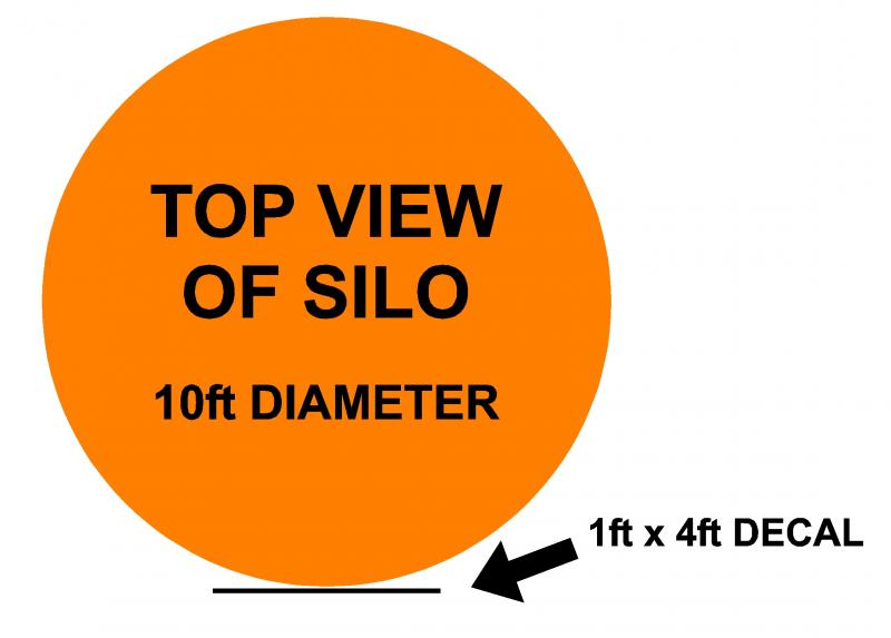

We have been asked to "provide" decals for a local silo manufacturer. As for longevity, the intermediate vinyl is what I would like to use, but I'm not really sure of the curve. These are a 1ft x 4 ft decal, going on a 10ft diameter metal silo. (see attached)
Is the curve of the metal silo reason enough to warrant the use of 3m180c?
My half asleep mind tells me, its more of a concave type of surface I need to worry about, not the convex.

That shouldn't be a big deal to install even if you do it with the cheapest vinyl you can buy. Installation will be easier on that than on a flat surface.

The installation wasn't my concern. It was the longevity, and the shrinking of the intermediate vinyl on the curved surface, causing premature failure. (I only need these to last for 3-4 years)

I don't think intermediate will stick well to the textured galvanized surface of a grain bin. When intermediate shrinks it ends up only touching the high spots. I would install high performance and heat it with a torch and rollepro it. Piece of mind...

These are nothing like what you have in mind. These are very smooth & have an automotive looking finish.

Only other warning is if the silo is a dark color, like black or navy blue, it will get really hot and the intermediate will probably shrink and crack in the sharp inside corners within a year.

If the curve isn't compound, in other words it's flat up and down and only curved left to right [or vice versa], intermediate will work just as well as if it were on a flat surface. Even at that, a 10' diameter silo would have a circumference of 31.4159265...feet. A 4' arc on a 31' circle shouldn't be much of a worry.
On a compound curve you either have to gain some vinyl, via stretching, or lose some vinyl, vial shrinking, in order to cover the surface properly. Hence a cast vinyl would be required. If it only bends in one direction, like the side of a cylindrical or even conical silo, most any vinyl will do. Assuming the side is flat and has no corrugations or such that must be covered. Most decent calendared intermediate vinyl has a rated life of 5-6 years. Have at it.
