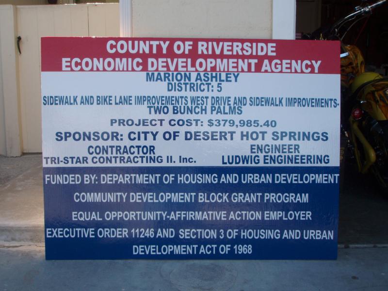

I made a sign for a construction company awhile back and laid vinyl right on top of treated plywood. This was in the Southern C.A. desert where it can get up to 120 deg in summer and below freezing in winter plus rain. I screwed on a sheet of thin plexi glass on top of the graphic to protect it from vandalism, Mainly taggers. It`s been there for two years and has held up fine. Just something else you might try.
