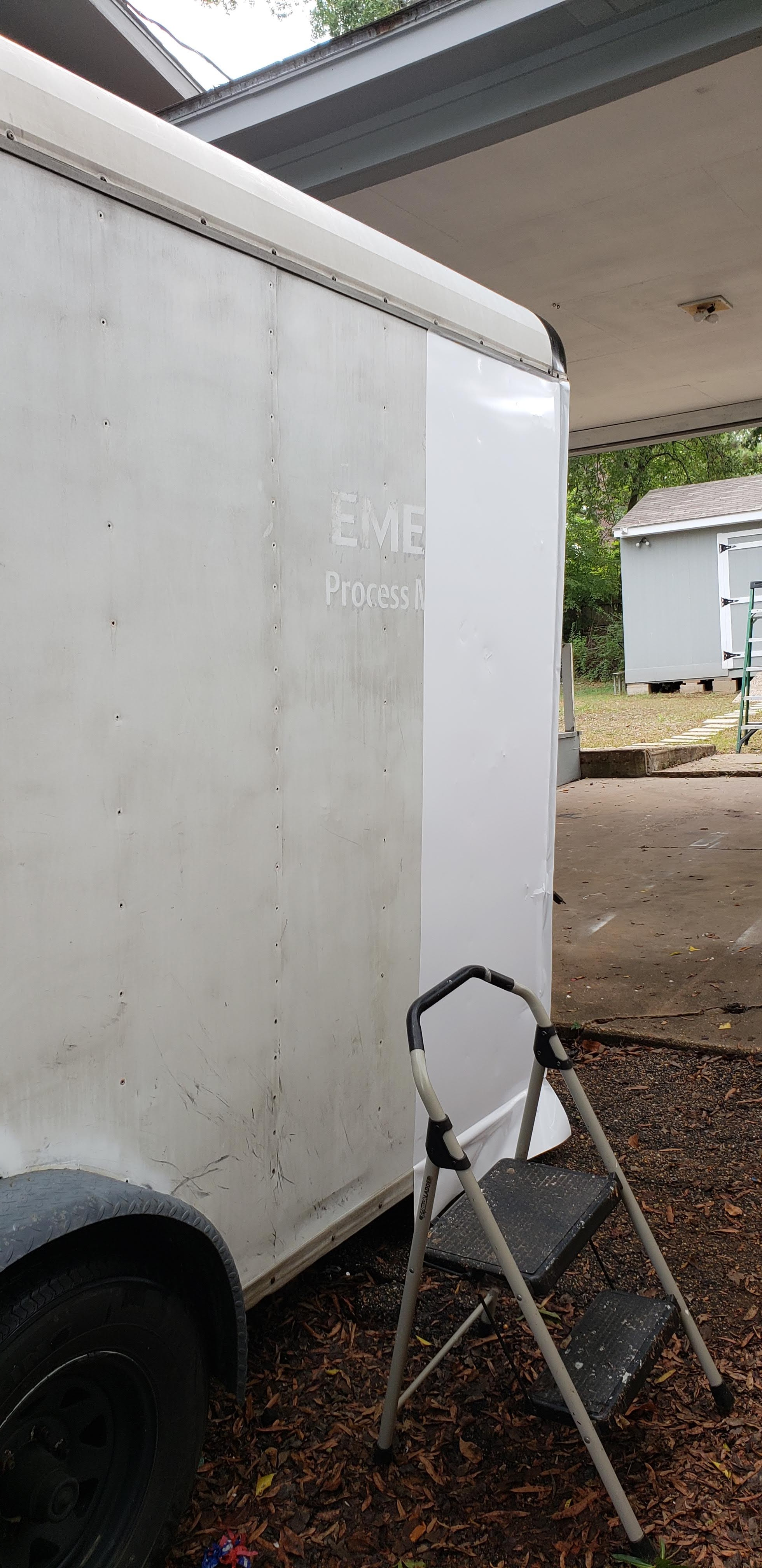

I did that to an old trailer a few years ago. Looked good when I got done with it. I used 3M air release with a grey adhesive backing to block out stains.

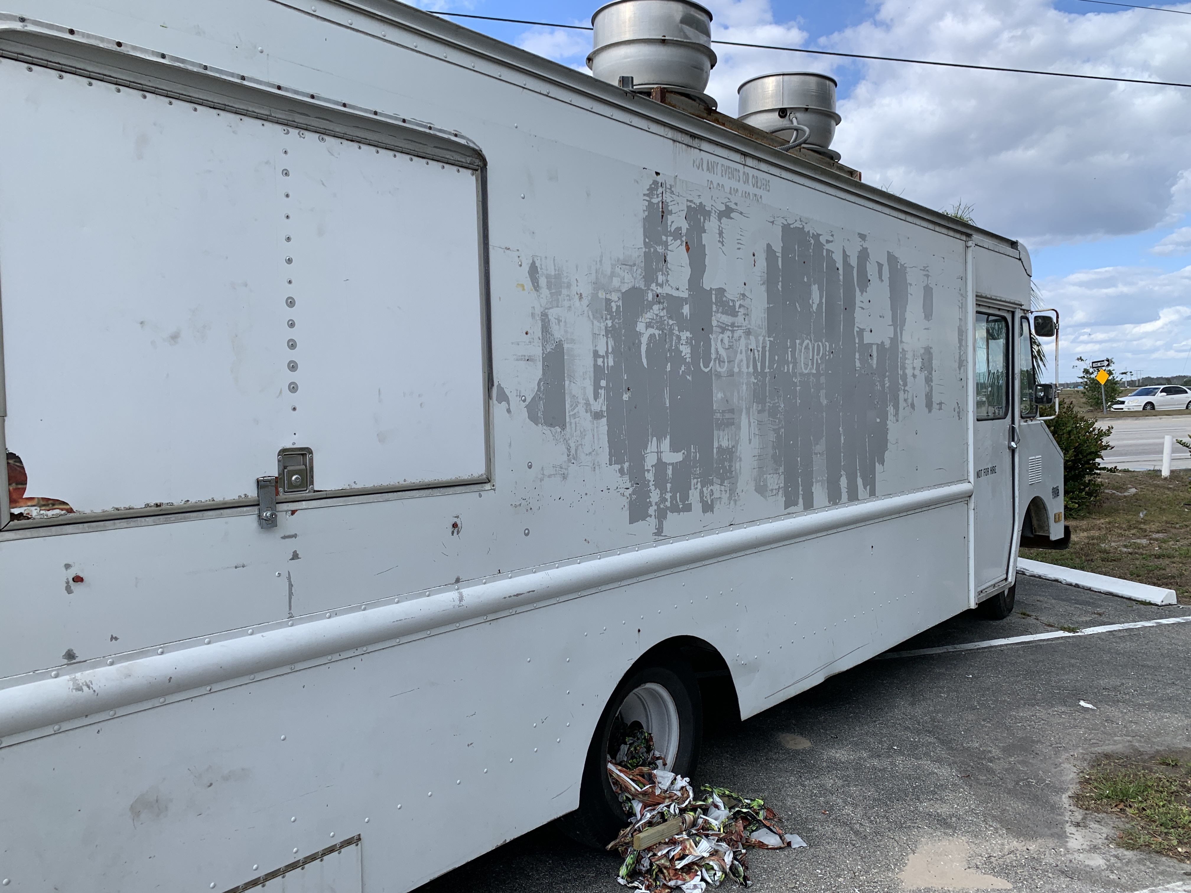

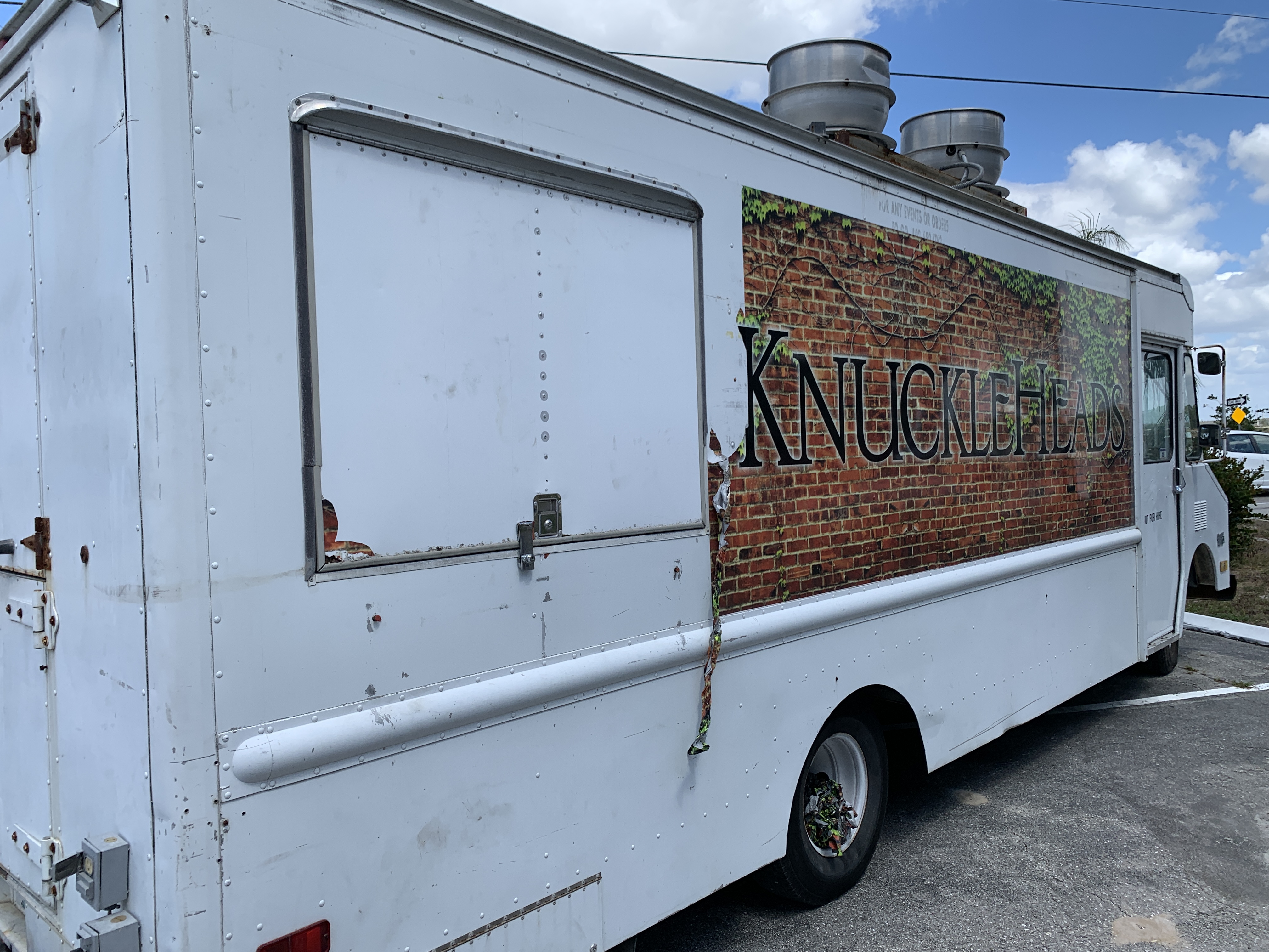

basically all flat a few rivets he is on a cheap budget. He thought about painting it after cleaning off old adhesive but wants just vinyl now. Pic of what I was taking off.....

All that grey will show up on the new vinyl if it's not removed. I did alot of cleaning and power washing
So far no issues, it's been two years. I dont see how it would be a problem.
