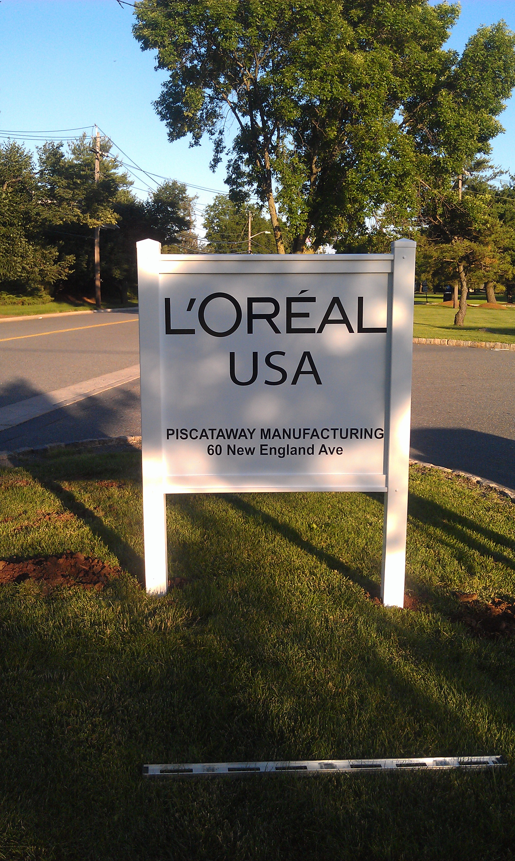

have a job with 4x4 vinyl post and panel sign frames.
customer wants to put 4x4 wood posts in the vinyl post for re-enforcement.
i have always installed them just with the vinyl post and never had an issue (that i am aware of)
anyway questions...
do i get a 3x3 wooden post because of the ends of the panel rails installed in the post?
or do you just have the wooden post go up to the bottom of the rail?
petepaz
like one of these kits

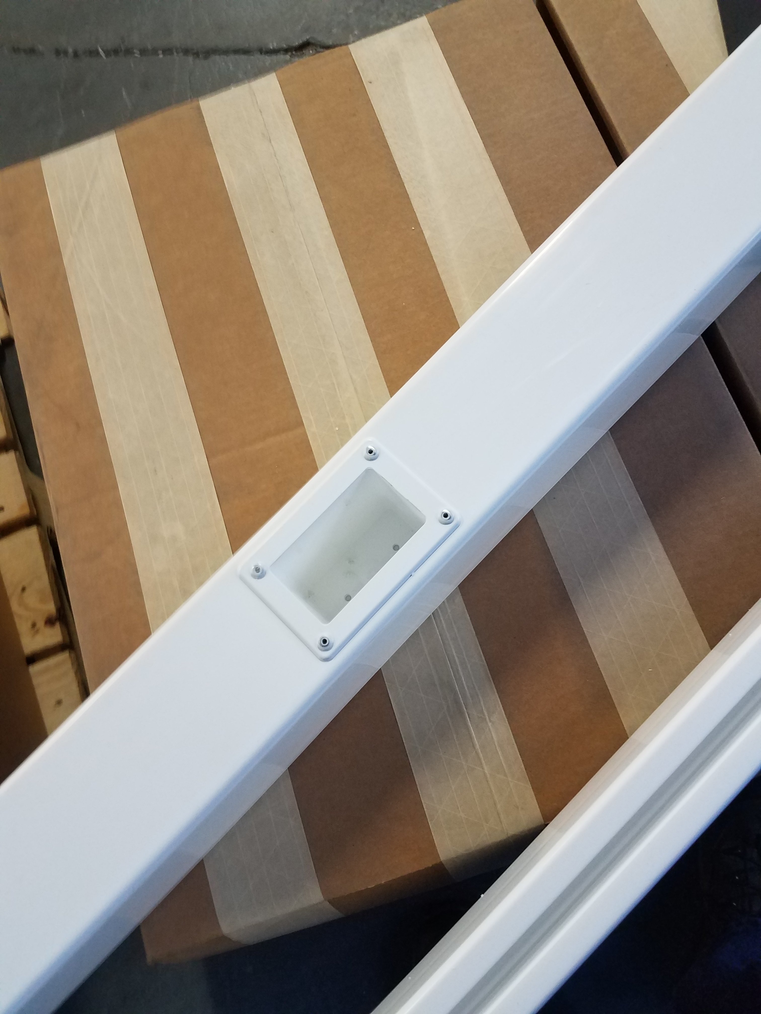

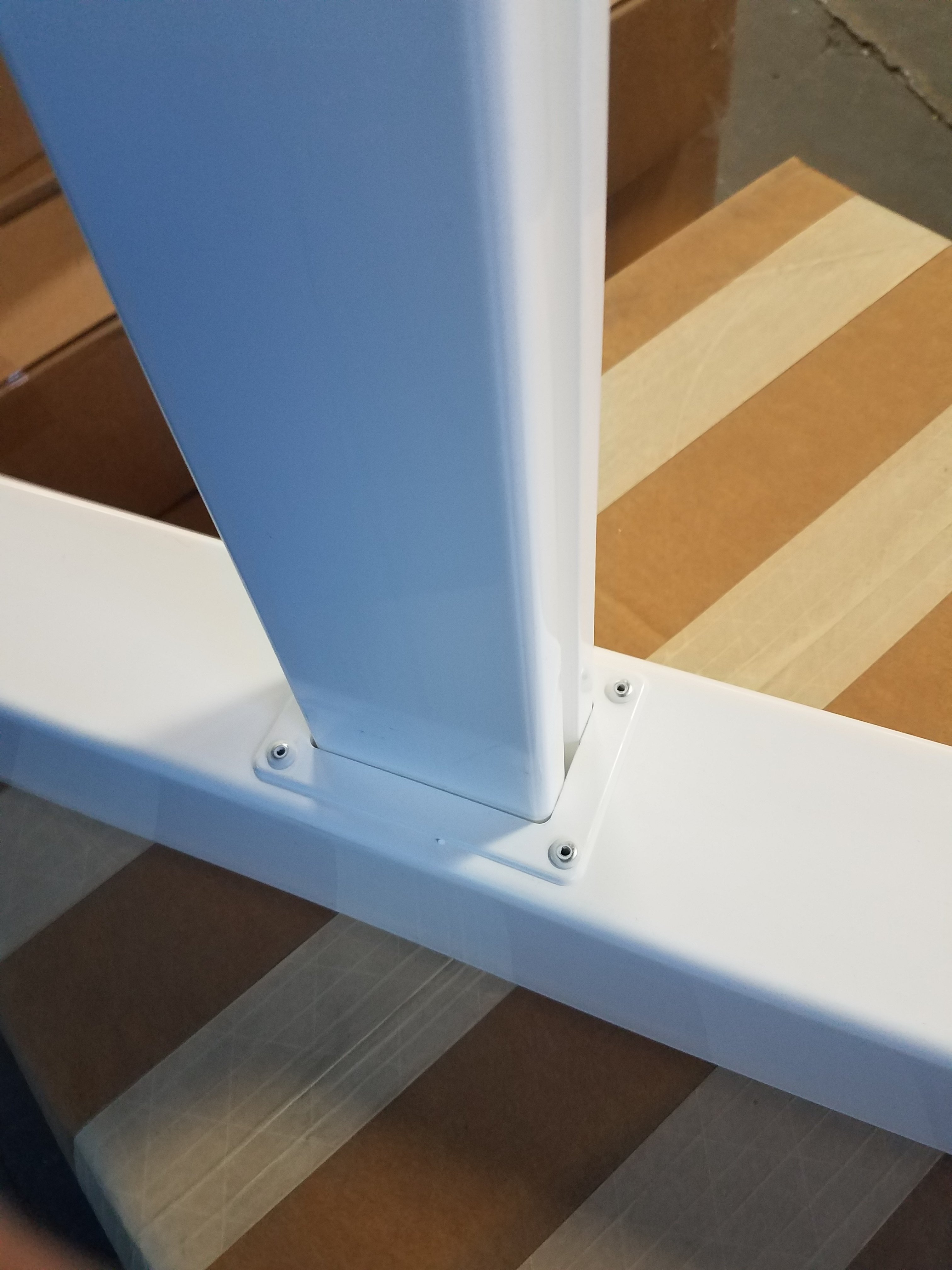

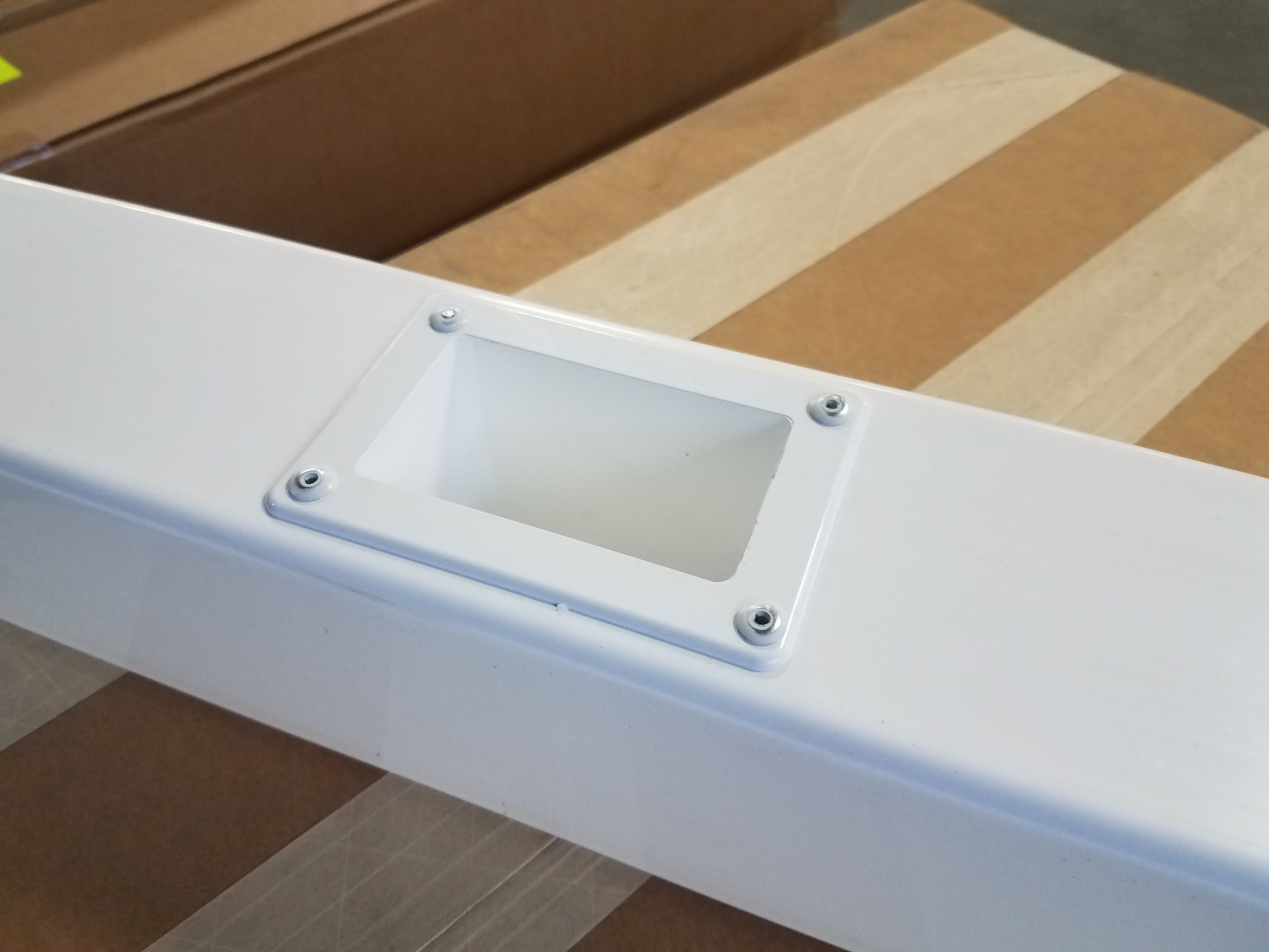

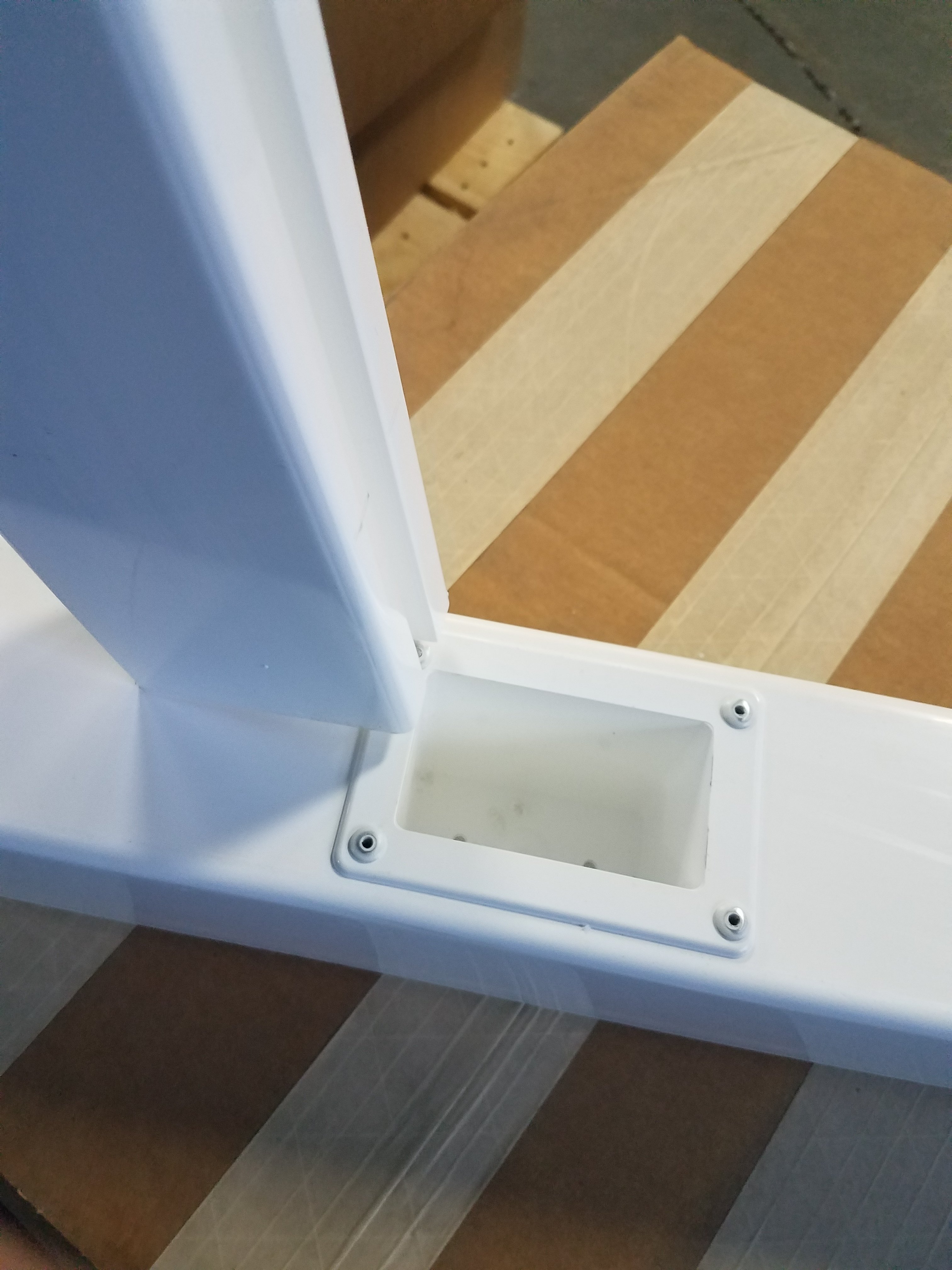

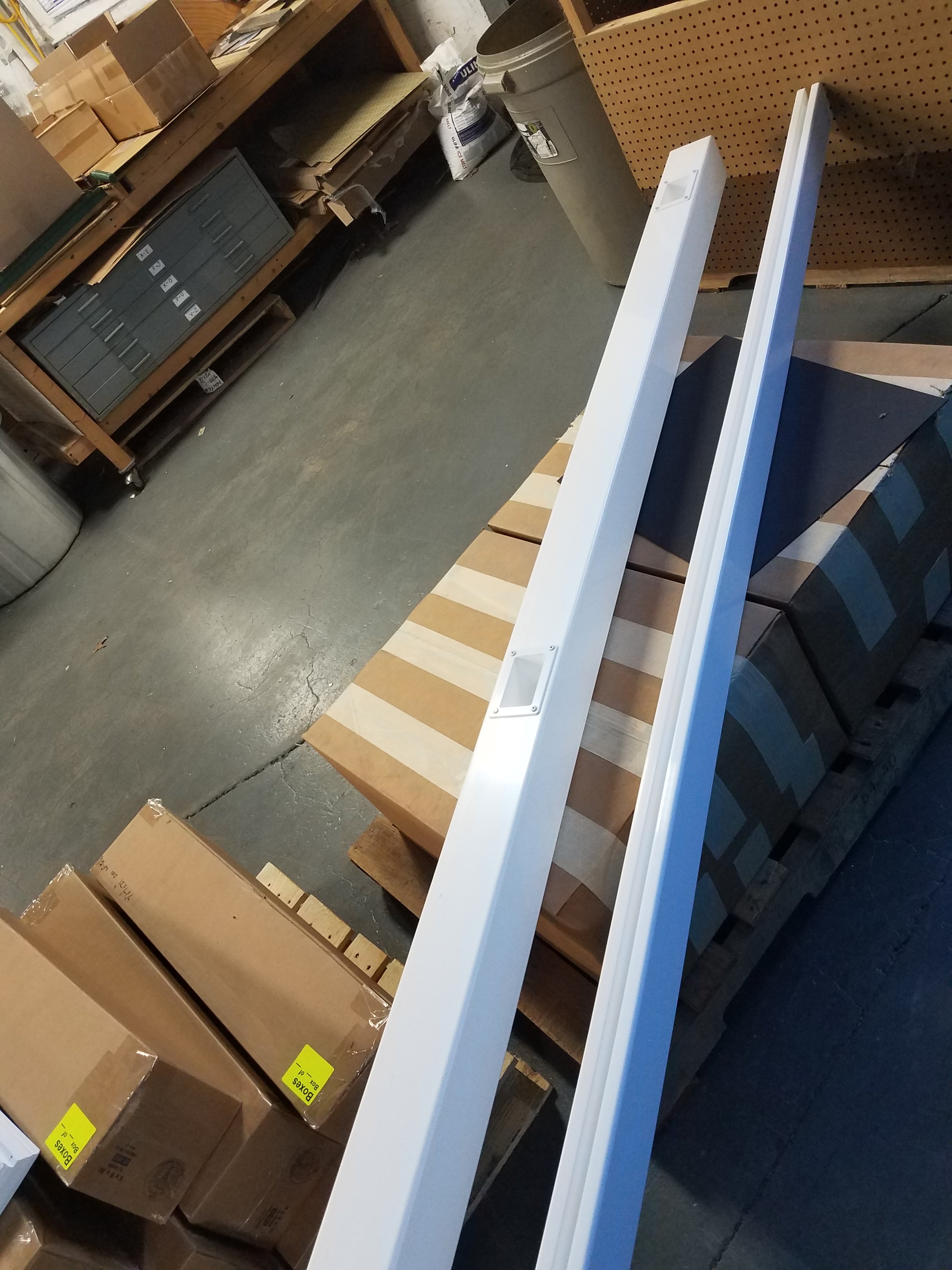

just opening the boxes with the kit in it and the posts are new and improved (i think) see pics
used to just have a cut out that you slid the rail in and now its a constructed pocket so i guess either no wooden post inside the sleeve or only half up
hhmmmm...

turns out the sleeve opening is only 3.5" so stuck 3x3 will probably leave too much play and 4x4 probably won't fit. ...good times...haha
