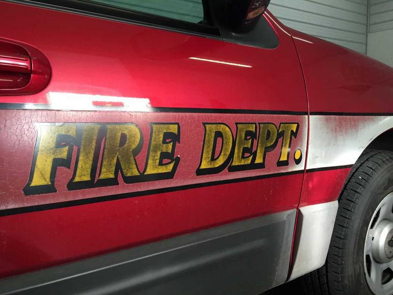

I had meant to start a thread praising this product, I never did, so I'll sing it's praises here. This is all reflective, that should be a white reflective stripe behind the text. This reflective was 13 years old on a truck that had sat outside all of the time. I knew there was no way in h*ll this would come off, and I would not quote removal. I tried a product from Fellers - Reflective Vinyl-Off (they also make a regular Vinyl-Off), that claims to "quickly and easily remove the vinyl and adhesive". I was pretty skeptical but thought I would give it a try. It recommends the vinyl be warm, so I preheated the area, sprayed it on, and waited. Didn't do much at all. Sprayed it again, let it sit, and then took a steamer to it, and I couldn't believe the difference. I would say this easily cut the time in half. I also tried this on another removal of old vinyl that wasn't reflective and it helped there also. It's not going to magically make the vinyl fall off, but it did soften it, helped remove adhesive, and didn't affect the paint or plastic trim. I will definitely use this in the future, but I think that you must use a steamer to make it effective.
