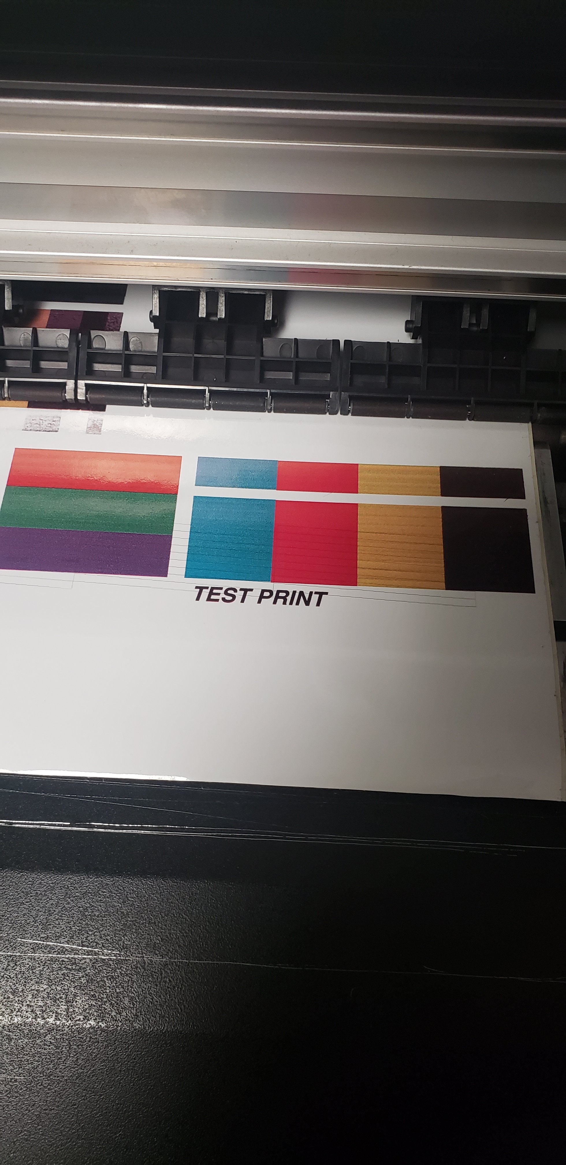

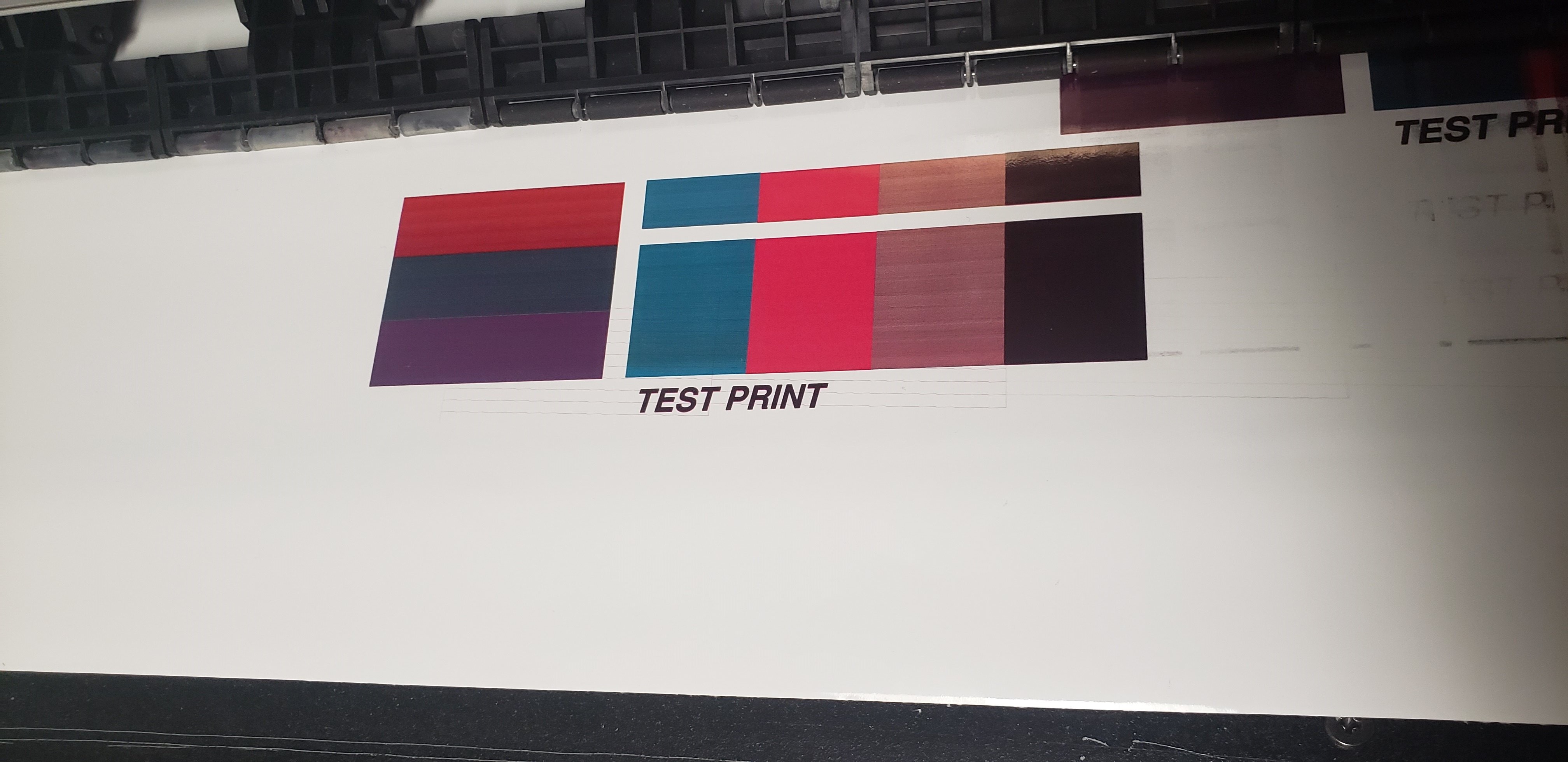

Dovermts
Well i tried onyx it maybe helped a little. I'm not 100% sure but i think i have a bad print head. when ever i print blue its purple. If i print yellow it looks like brown almost. If i do a strong clean then print it will print a pretty good test. when i print a couple more tests the colors start to change. The yellow turns brown and red even starts to darken. My lines are clean and no air bubbles. I did see one time the hoses to my head the yellow started to turn a shade of green but i did a cleaning and it disappeared. The print head was plugged when i first got the machine. i removed it and cleaned it carefully. I replaced the dampers and maintenance station and head ribbons at the same time.Does have any other other suggestions? I sent Mutoh a message i will see what they say. I have been through pretty much ever thing i can think of except the pricey head.:confused:

I think your print heads have problem. With Flexi and Onyx have same bad result testing so you should get support from Mutoh tech is best way.
Dovermts
Ya that's what I think too I will see if I can get a hold of them tomorrow and I will let u know what they say . Thank you for your help
