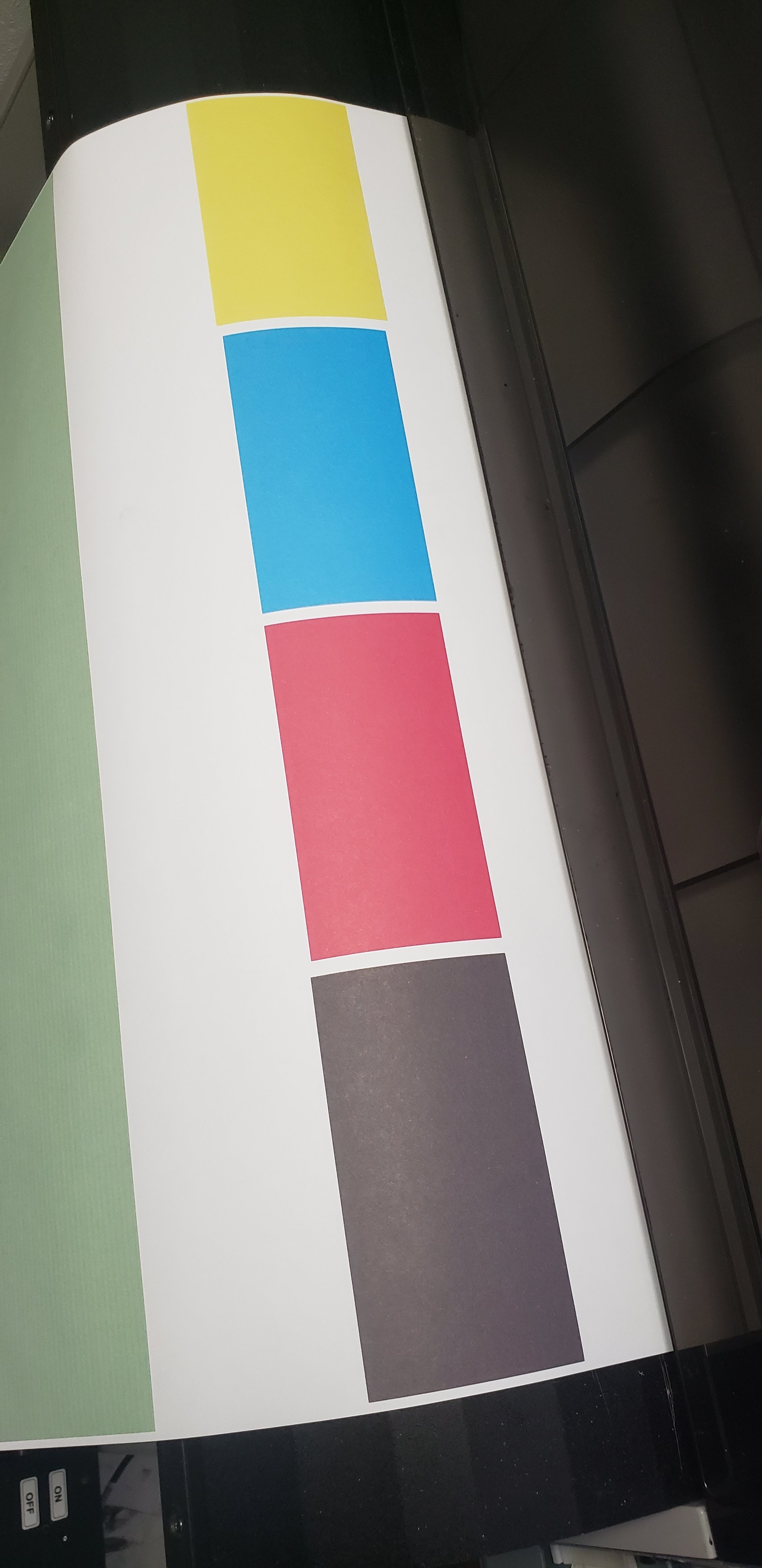

I got the new print head in much better I will print an actual job now and see how it looks
