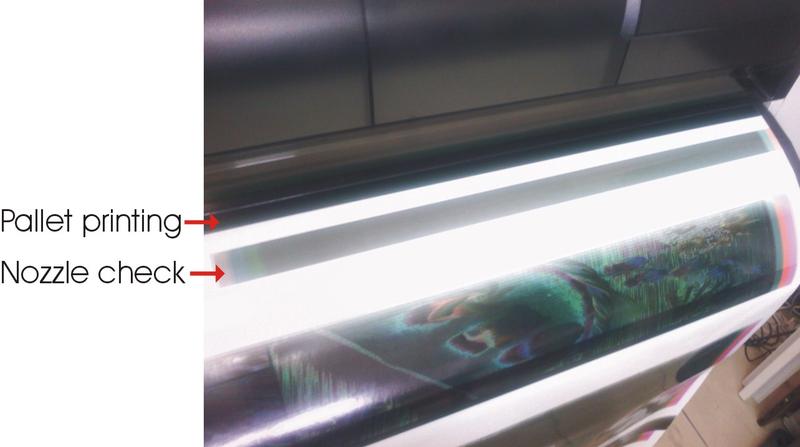

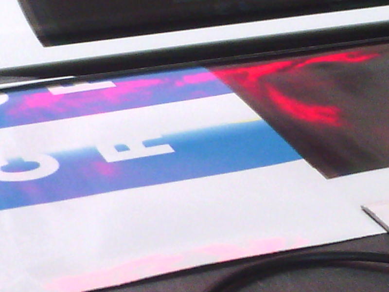

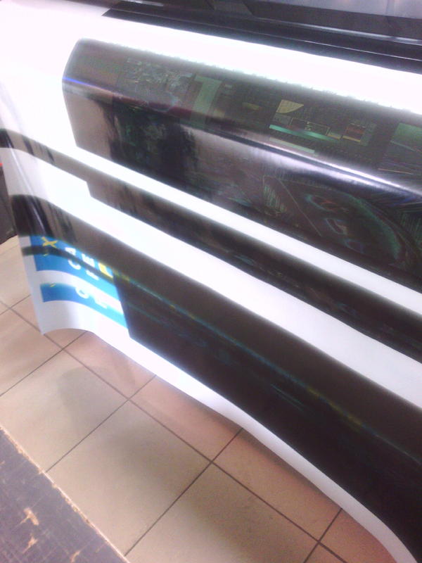

Hello guys and girls...
Here is our story:
Our Mutoh 1304 was printing but we ordered a new maintance station because the old one was damaged and not working well.I powered it on and started a print and all got black as you see on photos.
Does anyone have any suggestions what have caused this?
Printhead ,maintenance station(unlikely..) or something with the electronics (fuse etc..).
Any ideas would be appreciated,
thanks
Nasia

heyskull
I would hope that it is just a moved cable.
I would reseat the head cable cables and hope!!!
If it is still printing the fuse has not gone.
If that doesn't work I would say you have been unlucky and the head has died.

what is your nozzle test look like? could you upload it?
did you unplug the machine and discharge it when you replaced the maintenance station? you might have shorted the main board. I would try unplugging the machine and let it sit for 15 minutes. Try starting it back up and using it.

now I have nothing....
Suddenly, vj is not printing NOTHING...no nozzle at all.:omg:.
All fuses on main board are o.k.
Do you think I have a dead printhead?:banghead:
