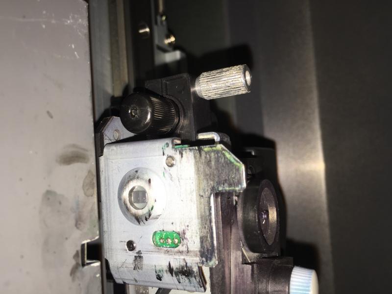

Hi guys just wondering if you have any idea why all of a sudden it is a living nightmare for me to find and scan crop marks. I Haven ruled out that it is not the laminate as I am trying to scan on a print without laminate. Slowly but surely it became harder to find the crop marks and now not at all!! I have cleaned the lens and tried everything possible. One thing I noticed is on the lens there is no filter is there suppose to be?
Any help would be much appreciated cheers

I have tried cutting the laminate out around the registration marks and also tried scanning a new print without any laminate whatsoever and still no luck. I am thinking I am up for a new sensor.. Has anyone got a picture of what the sensor should look like? my one looks like this and it looks like it may have been pushed in when I had a head strike some time ago...
