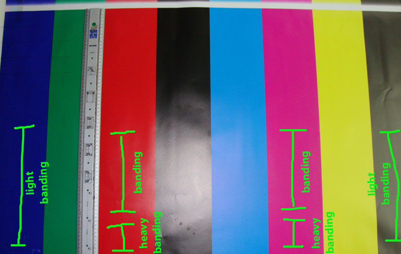

since last week my VP540 started to do some strange banding. In every print, and in different materials and profiles it starts banding after 60cm . I noticed that it happened more in colors with magenta. I did a test file with 8 colors, from the roland spot color library. The result is below
The banding isn´t noticable in the photo so i did some 2 year old kid drawings :p
I printed in high speed Bi direccional and I checked that colors with magenta where having problems. all the other are printing perfect all the way down.
The banding starts like a thin line and then to a more sever mess!!If i stop, do a normal cleaning and restart it gets back to normal and after some more inches of print it starts all over again.
The print head is brand new as the dampers and caping stations. The nozzles are all firing with no problems.
Any ideas of what is the problem??

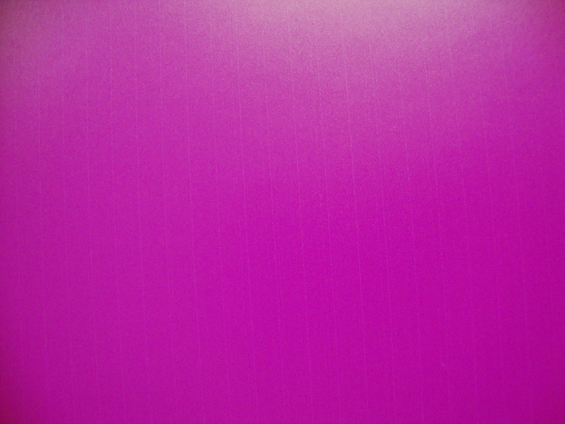

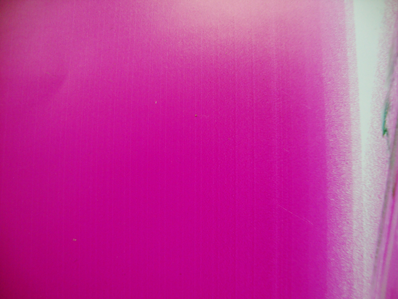

wochi
here it is. first one the white lines, then the second one with the multiple lines/tones of magenta

wochi
please see the photo in the first post. the banding is only after some time of printing. If i stop and restart it gets good again but then the same problem so it´s not calibration for sure :(
