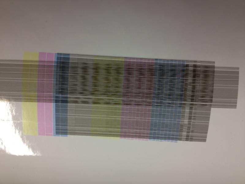

Hi,
My black has gone crazy........it streaks across the page as if it was permenantl on!
Is is dead...........
Can anybody help?

JRSdecals
I would double check the seating of the long print head cables as well as the short printhead cables (with machine powered off and unplugged of course). Or you might have a short in one of those. Otherwise the head has possibly reached the end of it's life.
artbot
first check the data cable to that head for ink, looseness, fraying. the possibility that it his dead is high. if the data cable looks fine, then do a data swap to make sure it's the head, not the carriage board.
purevs
The head used to be very fuzzy, then the Black and Cyan failed 100%, but new fuses fixed that, it's just now as in the picture.
I have swapped a few cables, but I get odd, results when test printing, too hard to explain.
I'm so close to buying a new head, just wanted to make sure really.
What is a "data swap"?
Thank you.
Make sure if your playing with the cables you unplug the machine. I have had so many clients who thought they were doing the right thing forget to unplug and blow out boards.
If you haven't touched the cables at all and this started happening then my guess is a head.

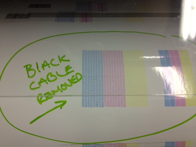

purevs
Ok, I swapped the black and the yellow...
Test print shows: all colours, but a bit split up!
Black still streaks across the page, but not as much....?!??
If I remove the black altogether and enter Service Mode, test print shows: lovely! CMY.....sweet!
Does that prove its the black head gone????
Thanks for advice :)

otctech
If black still streaks when it is connected to the yellow cable I would say you have a bad head.
