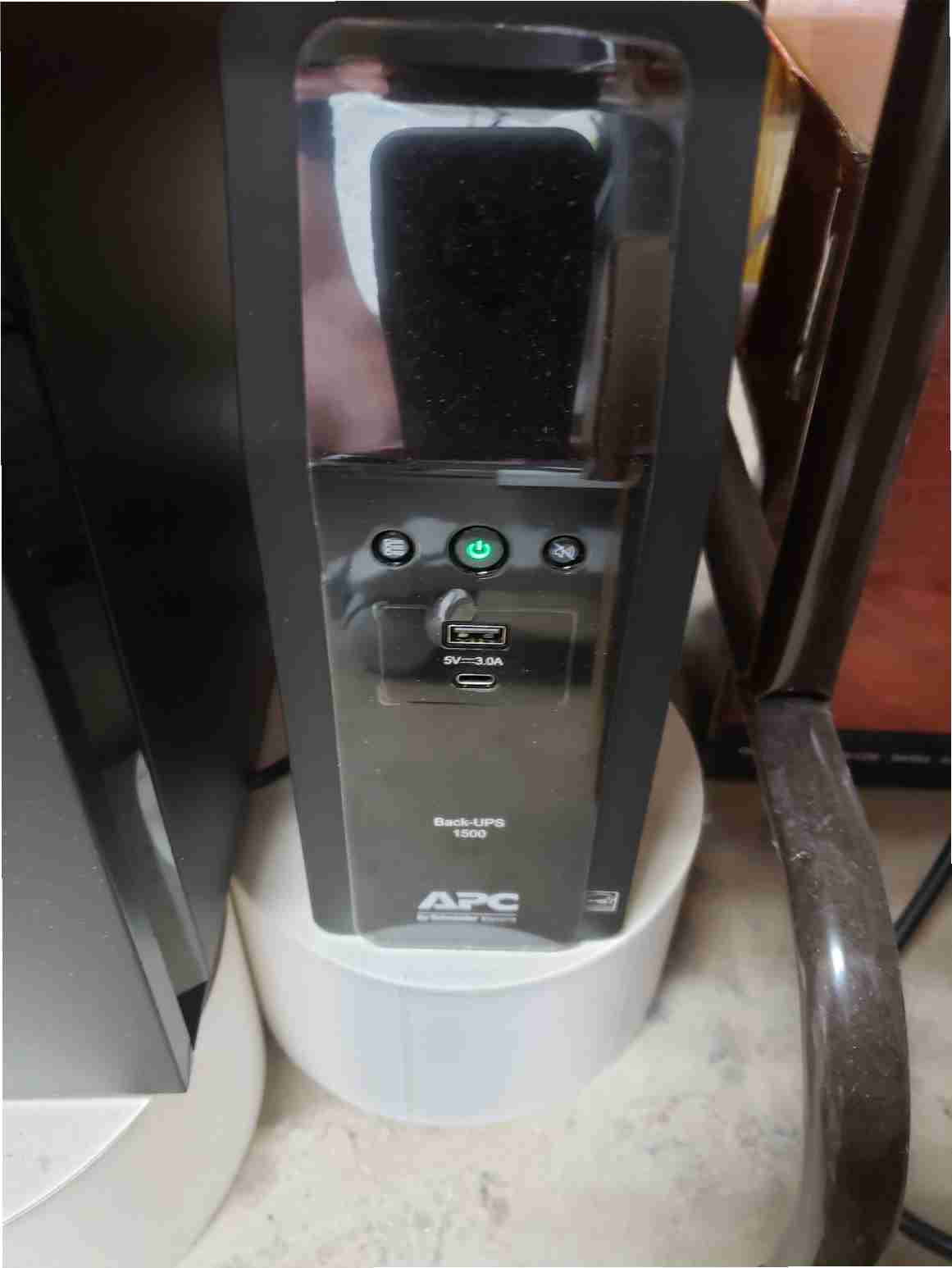

Was the motherboard damaged by an 'over the weekend' power surge? If so, get an APC UPS backup/surge protector and put it on right away.
We have one of these on every computer and printer. That company must love us... ;)

I KNOW YOU MEAN WELL. BUT...
it is simply NOT A GOOD IDEA to try to run a roland printer through a battery backup, unless it is HUGE. it won't be able to handle the load when the printer cycles
we have a bunch of the 2500 va apc's (rated for 20 AMPS) and you can hear the power supply of the roland's SQUEAL (begging for it's life) when you run off a ups.
i can hang an oscilloscope on the AC output and you could see the horrible sine wave distortion your ac gets under load when the printer cycles.
probably your best bet (other than moving to an area with reliable power ) would be to purchase an ESP D5131 surge protector (the kind that comes when you sign a lease on a copier
i will post a picture.
