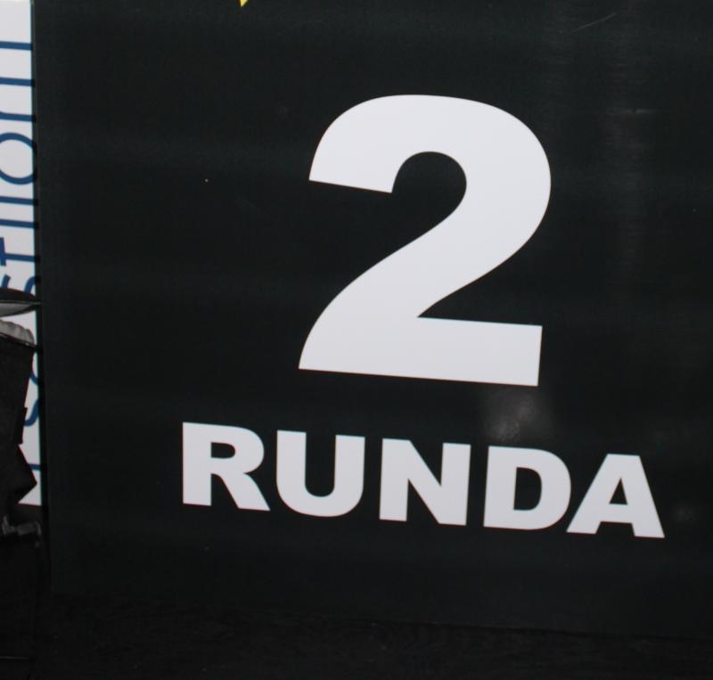

This is best explained with the image in the attachment. No matter what I do, on what kind of media I print I always get those white stripes every few centimeters.
When I asked my reseller he said that this is usually due to low quality material. I printed on Oracal until then and I told him to send over some of the good stuff. He send me a few rolls of x-film and the print quality is much better but the white stripes remain.

The stripes in the media look to be at regular intervals. Based on that, I would clean the media feed encoder and sensor. I have seen it get dirty on your machine, causing this problem. That encoder is located in the right side end bell on this machine (assuming you are in the front).

As for your lines... if the lines you are getting are thin and light, then you probably need to set your Calibration. Calibration tells the printer how far to advance the media after each print pass. If it advances too far, you get thin lines that are light in color. If it isn't advancing far enough, you'll get thin dark lines. In your case, its advancing too far. You need to run the Calibration test on your printer. This can be found on page 48 of your user's manual.

I just logged into my account here and saw this thread. We resolved the issue by opening the machine up and just cleaning up the encoder strip.
The interesting thing about the whole situation was that after the Roland dealer ran out of solutions like:
It's the temperature (this had never been a problem, even while printing at temperatures like 15°C)
It's the media (Never been a problem before either, and it happened on all the media we tried ranging from canvas to vinyl). They told us to buy some high quality vinyl and paper from them and that it would fix the problem (this didn't make any sense, but we wanted to try high quality media anyway and they did turn out to be that good, but that didn't fix the problem).
Finally after none of their suggestions worked and we were stuck with a printer that barely worked, WE told them to send someone over. The machine was still under warranty but we had to pay for the technicians expenses. He came here, worked for 6 hours on the machine and still didn't have a solution.
Finally a few days later we opened the machine up, something against the dealer's strict advice and after looking around in the machine for 2 or so hours we found that the encoder strip was dirty. We cleaned it up and what do you know ? The machine worked flawlessly again...
