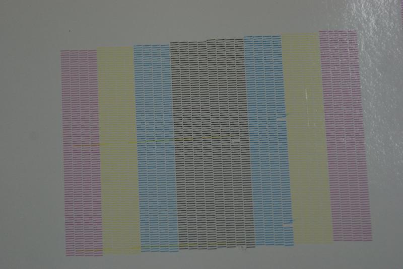

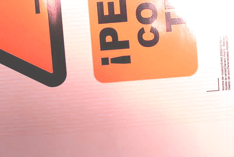

Hola desde Valencia (España), estoy preocupado con un error en la impresion que me pasa desde hace unos dias. Cuando imprimo me sale una lineas amarillas. El servicio tecnico no sabe que le pasa. Mando unas fotos. Agradeceria mucho vuestra ayuda.
Carlos

thank you for the translation. I don't know if it's my monitor, but I'm not seeing a problem with that yellow print. Do you think there is a hair on the head dragging on the print?
J Hill Designs

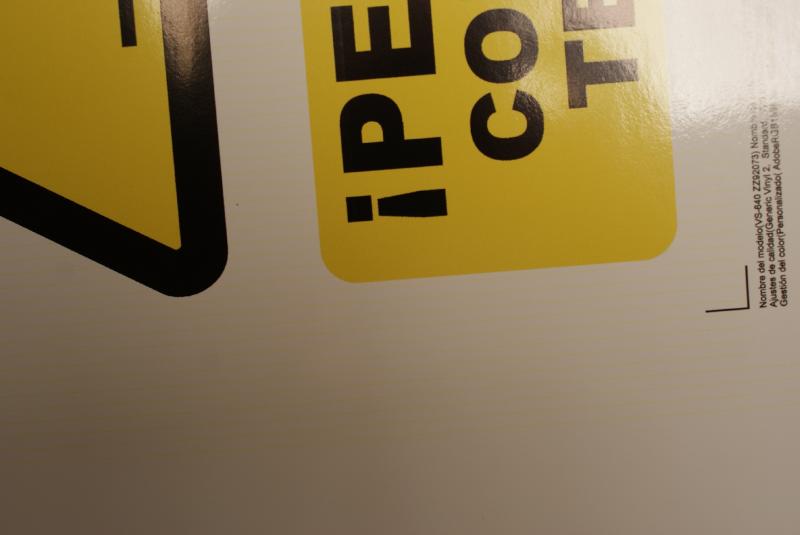

messed with the saturation in photoshop - see those lines? they are yellow (pure, it seems)

That's a tricky one. I've never gotten this except with a blown head. The test prints would look like this as well. So, I'm at a loss. Sorry.
