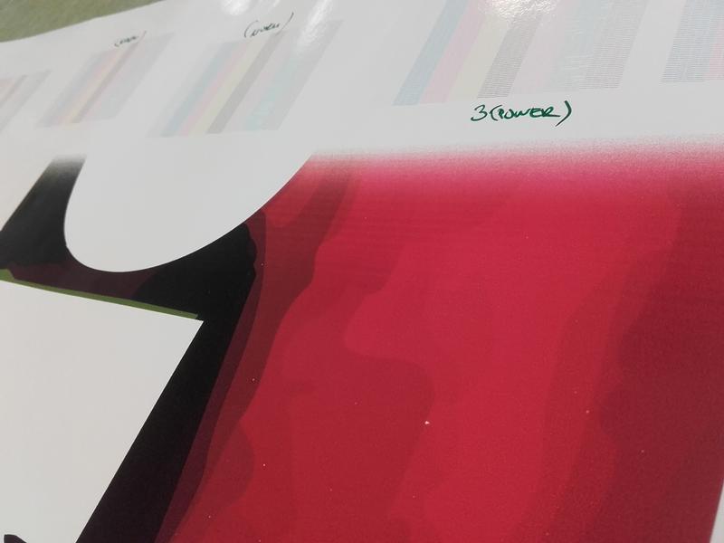

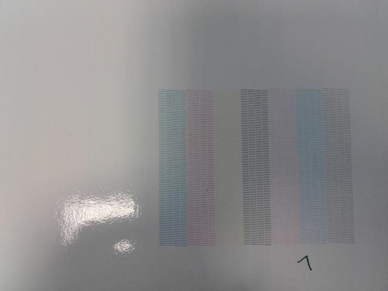

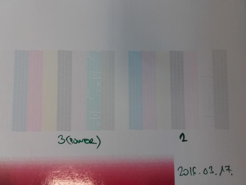

I have constatnt ligt cyan run ot problem: After cleaning it gives a 100% testprint, then print around 50 cm long then the LC become striped, and slowly fade away almost completely.
The tech guy replaced original parts: cap top, damper - but he couldnt solve the problem - now we are on waiting to the answer from the service, on what to do - but is very slow, and business is rolling as usual.
I've tried suction with a syringe on captop ( head in parking place, two pipe form the pump)
With the syringe method or with powercleaning it comes 100% again, then on printing the LC runs out.
I've tried to pull ink from the pipes above the damper and it comes easily with no bubbles. I've tried also pull across the damper, and it was OK as from the pipes above.
The machine has full maintenance and original roland parts till now, wiper, felt...etc. It has almost half year old printhead in it.
It runs on alternative ink - inkmate. Before printhead change, it runs almost 2 years - no issues with this ink.
Can anyone give me any suggestions?
Testprint before, the printout itself then testprint after - attached

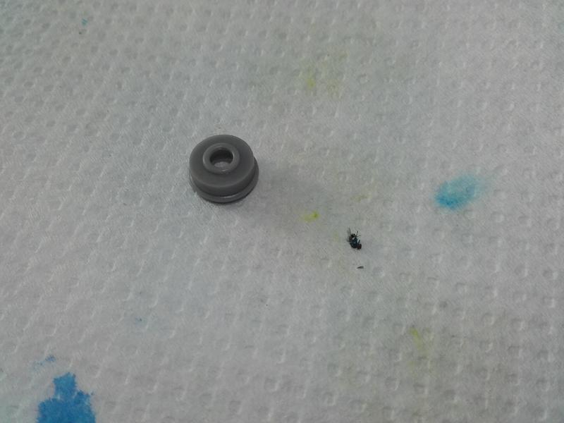

state now: I rotated the seal in the damper (4x) upside down, so the funnel can reach deeper on the head ( and seal more).
Flushed trough the LC line again, from damper connection to the cart. Flushed the cartridge completely.
In the cart I found a little fly corpse...
Testprint is ok, Uni-dir is ok (~4 m2 ), but empty metallic ink.... :banghead:
On monday, the next step will be bi-dir....
Thanks for watching... :)

rjssigns
It's logic what you are saying.
Well, the lines (form the captop to the pump) are new, and free to flow. The lines from cart to the head are the same, not new, but free to flow too. We have this ink in other machines with absolutely no problems in the ink system, mainly that I have problem with the LC, what means 2 times solvent to the base ink therefore much less pigment in it.
Is it possible that I got bad series of dampers from the tech?!
state now: I totated the seal in the damper (4x) upside down, so the funnel can reach deeper on the head ( and seal more).
Not a fly, it was the ink engineer. Now you'll have to get a new one.:Big Laugh:Big Laugh:Big Laugh
Happy to hear you got it going. Never would have suspected a real bug.
