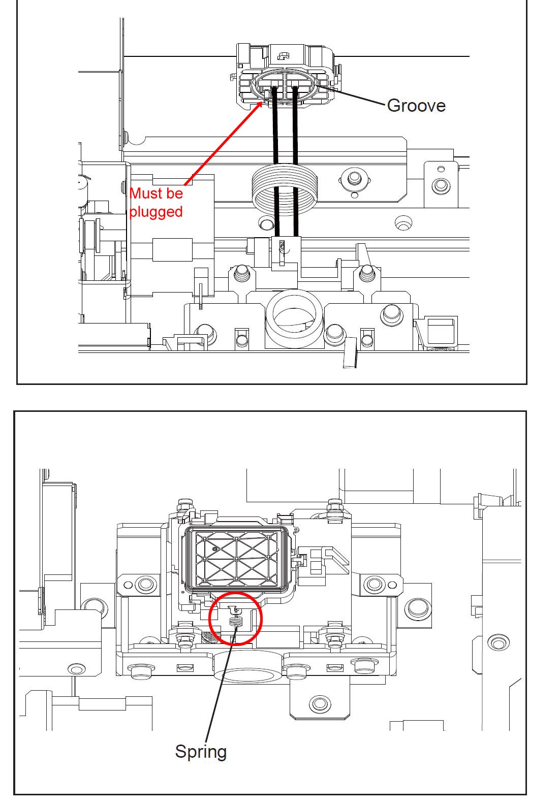

Correct me if I'm wrong, but it sounds like your problems gradually started with a captop replacement about a month ago and now won't go away with a new captop. I've attached a pic with 2 things to check - that the spring on the front of the captop (critical for head to captop alignment) is there and the 3rd nipple on the bottom of the captop has a little cap plugging it up. Either one of these can cause loss of adequate suction during cleaning or choke cycles. If both of those parts are there, then verify the captop to head alignment by what I call the ink chalk line test. Power the printer off. Move the head to the left so you can access the captop. Take a swab and get it soaking with waste ink. Wet the rubber lip if the captop with the waste ink. Lock the printhead in place. Unlock the printhead and move it to the cleaning station at the left side of the printer and examine the bottom of the printhead. If the alignment is correct, you should see an ink mark all around the head nozzle plate, but NOT touching the metal frame around the head. If it's touching the metal frame anywhere, then the capping station may need to be physically adjusted. Also, when you put the waste pump lines back on the captop nipples, they should fit very snuggly. If not, snip off about 1/4 inch and reattach.
BTW, the ink you were pulling through the cap with the syringe, what color was it? Smear a tiny bit on some vinyl to judge accurately. That could be a clue to help locate the problem...
You said you have replaced the printhead 3 times for Light Cyan misting and deflecting. The same issue 3 times leads me to think you have a noisy circuit somewhere, maybe the carriage board or the mainboard. Maybe Netsol or Damon have some thoughts about this...
Fantazia

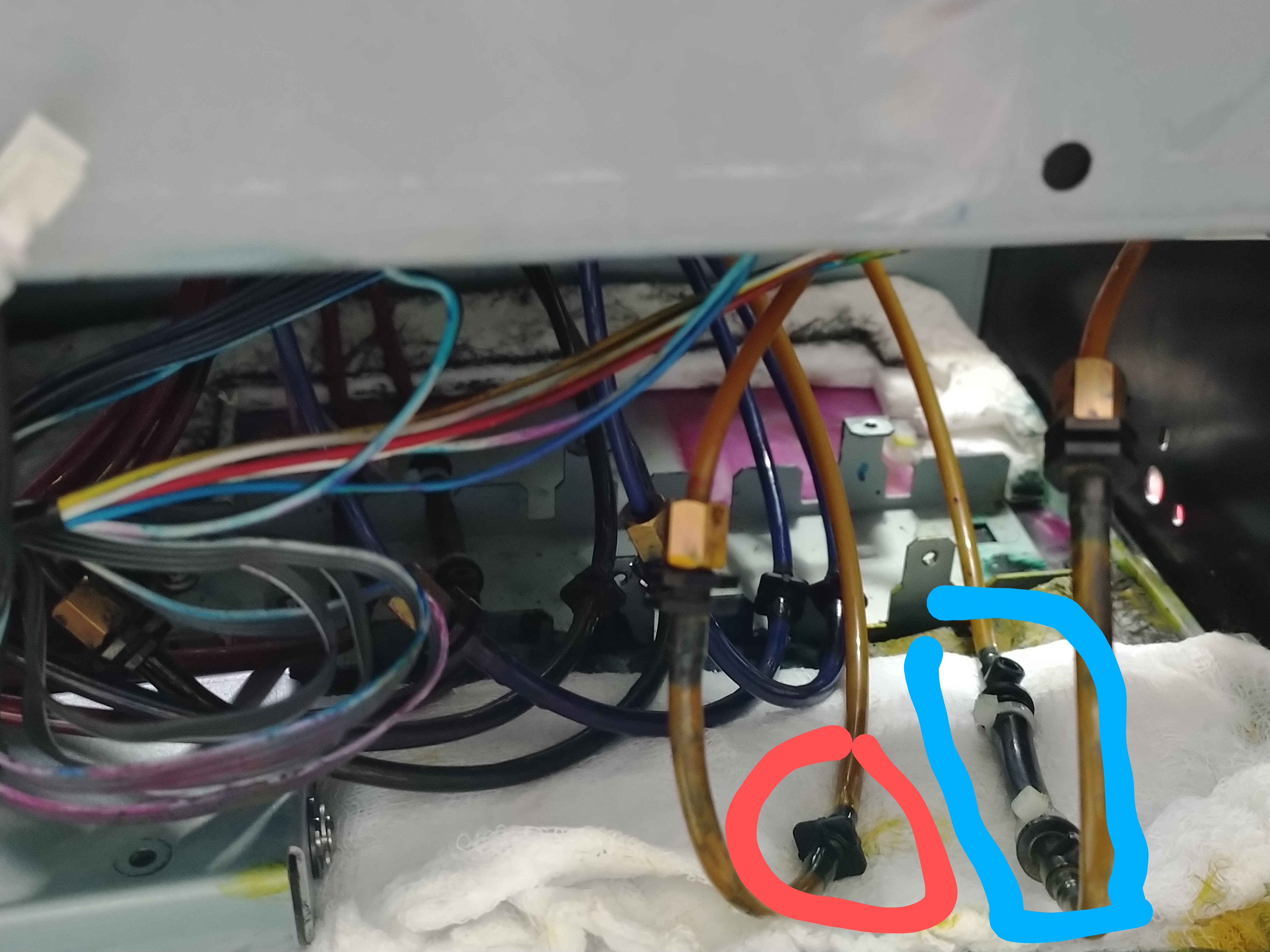

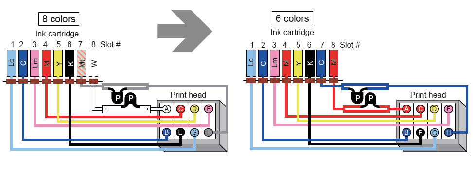

This is what you need to do! This don't happen to all VS but after 8/10 years it will start to occur with cyan or light cyan gone missing for no reason. Replacing print head or dampers or ink renewal will be short term fix. First of all make sure your pump is working good, your choke valve is your problem here. Remove the covers from the ink system at rear then remove your choke valve, the extended tube line for choke valve to clamp down (blue circle) and the tube line without the extended (red). All you have to do is snip away the extended tube end to end and joint a ink connector so that the ink flow will not have obstruction or dried ink. Since I have the ink system remove, I would also use a syringe to flush fresh cleaning fluid for your cyan and light cyan but make sure you disconnect your hose line cyan and light cyan from top of print head and place the two tube into a bottle then you can start flushing from ink system. Beware! next time if you want to replace your print head you will not have the choke valve to turn off the tube lines so therefore you need to clamp the tube lines from above dampers with forceps scissors. I do this few times and it works for me but its going to be messy so prepare with lots napkins and FORCEPS SCISSORS....good luck xxyy.jpg
Jim Hancock
Old School Technician
Rather than bypass the choke valve, which is incredibly useful, replace the flexible tube that is pinched closed during the choke valve operation. Roland does not carry it anymore, but this should be a perfectly good replacement. It's the correct size, flexible and is solvent resistant.
Fantazia
Good to know your level of expertise, makes it easier to help. I can see this is a strange problem that requires out of the box thinking. You said you have dealt with choke valve issues in the past, have you verified that it's working correctly? It seems to be the only common point for all the ink lines other than the printhead itself. If some of the tubes in the choke valves are stuck closed, this could cause your problem. I would attach a syringe to each ink line above the damper and see if you freely pull ink. You might also consider removing the ink cartridge for whichever line you are testing and see if you can clear the line and pull air. I would hazard a guess that with the level of meticulous (Awesome!) level of maintenance you do, your choke valve has been operated more than most users, and may need some checking for wear...
Before last printhead change, choke valve tubes replaced with OEM new tubes, (the white line was like solid chalk..!). After that, no white or metallic ink used since then. System tubes was cleared with Pump up menu and cleaning cartridges. Head replacement took place with clean, empty ink lines. So choke valve mast not be the issue. Thank you for your reply.
Fantazia
This is what you need to do! This don't happen to all VS but after 8/10 years it will start to occur with cyan or light cyan gone missing for no reason. Replacing print head or dampers or ink renewal will be short term fix. First of all make sure your pump is working good, your choke valve is your problem here. Remove the covers from the ink system at rear then remove your choke valve, the extended tube line for choke valve to clamp down (blue circle) and the tube line without the extended (red). All you have to do is snip away the extended tube end to end and joint a ink connector so that the ink flow will not have obstruction or dried ink. Since I have the ink system remove, I would also use a syringe to flush fresh cleaning fluid for your cyan and light cyan but make sure you disconnect your hose line cyan and light cyan from top of print head and place the two tube into a bottle then you can start flushing from ink system. Beware! next time if you want to replace your print head you will not have the choke valve to turn off the tube lines so therefore you need to clamp the tube lines from above dampers with forceps scissors. I do this few times and it works for me but its going to be messy so prepare with lots napkins and FORCEPS SCISSORS....good luck View attachment 176858
Thank you very much for your detailed reply! As I 've said in other comment, those flexible black tubes, replaced with new, some years ago when I stopped using white and metallic ink. (The MAX 2 white ink that replaced MAX was a disaster..!). It was solid hard chalk down at the "U" shape of ink system lines. Maybe when I can I will post the old tubes, I still have them. In my case, In my printer, each head replacement was after pump up procedure with the six clean cartridges. So all ink was sucked out of the printer about every 4-5 years, to start like new (I know, it cost a looot :) So, I don't think this is the reason that suddenly 6 lines of the 8 don't flow in the middle of a choke clean. - I will check it, just to be sure -. As you suggest, choke valve bypass is a good idea for an old printer that does not need "choke clean" any more (Choke clean in the menu is not a good practice for the print head longevity anyway).

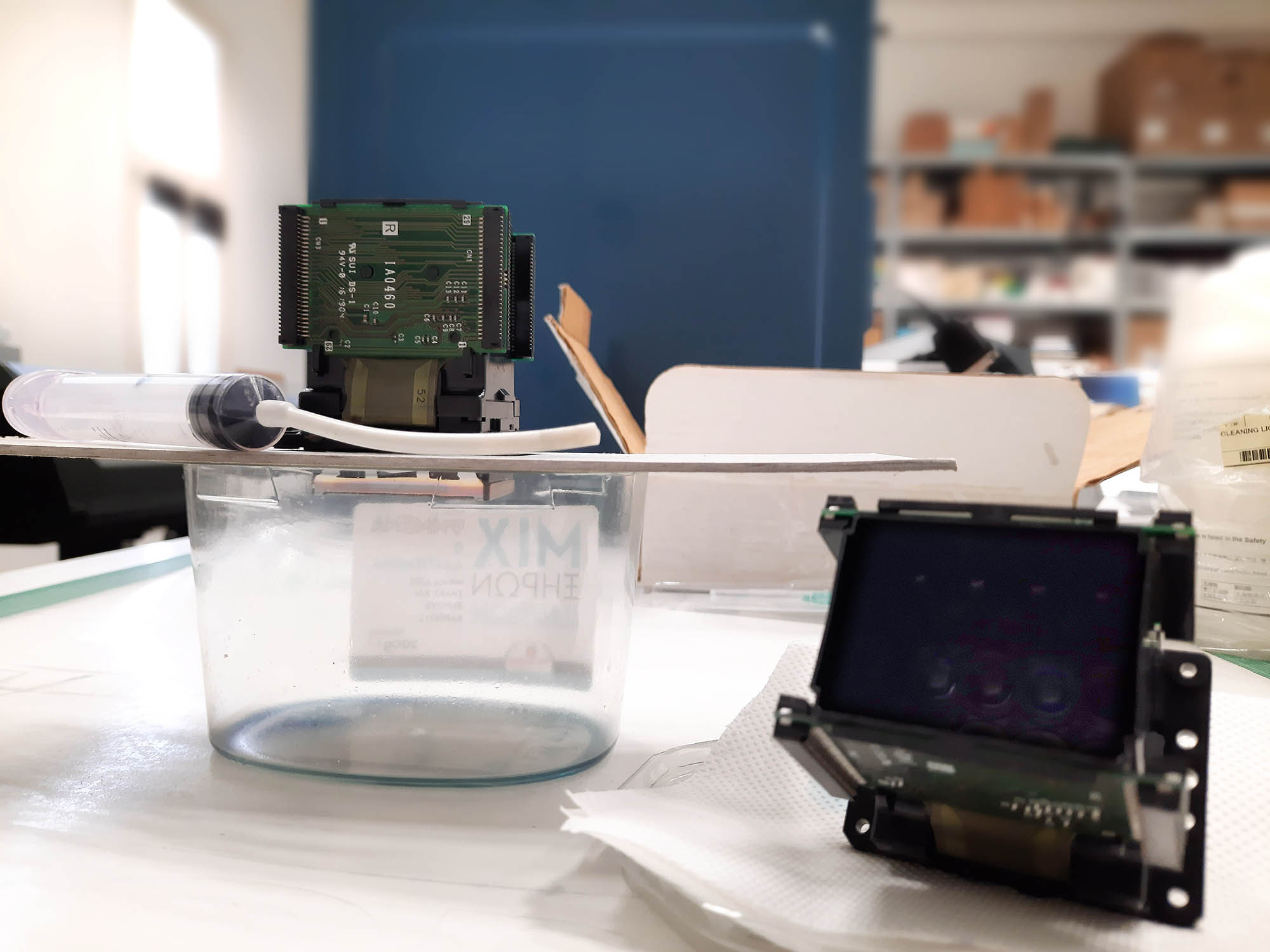

After all this time, I am back for more information: No problem with the ink tubes, choke valve, dampers, etc. The guilty (again) was the DX7 print head. After removal and channel check with cleaning fluid, it was delaminated. Cleaning fluid lightly pushed to black channel in the manifold was giving drops in 4 other channels!. Internally ruined, like the previous 3 heads. No heavy use, no marks, a like new head with Roland inks and parts always. It is the nature of the DX7. Fine prints, short life.
Printers have to print and I had a lot to print so I refreshed the print section as always do when a new print head is installed: Print head, dampers, capping, felt, wiper and of course, new pump. All parts from authorized dealer (not gambling with unknown suppliers). All servicing took place with no rush, careful and tidy. One step, double check then next step. 2-3 cups of espresso is a good help too :). No ink spills, a clean - like new - machine. After parts fitment, one power cleaning, bias check, history clear in service menu, bi-direction adjustment and now, a - like new - printer is back with sharp printings. Even tiny text on small labels comes clear and crisp.
