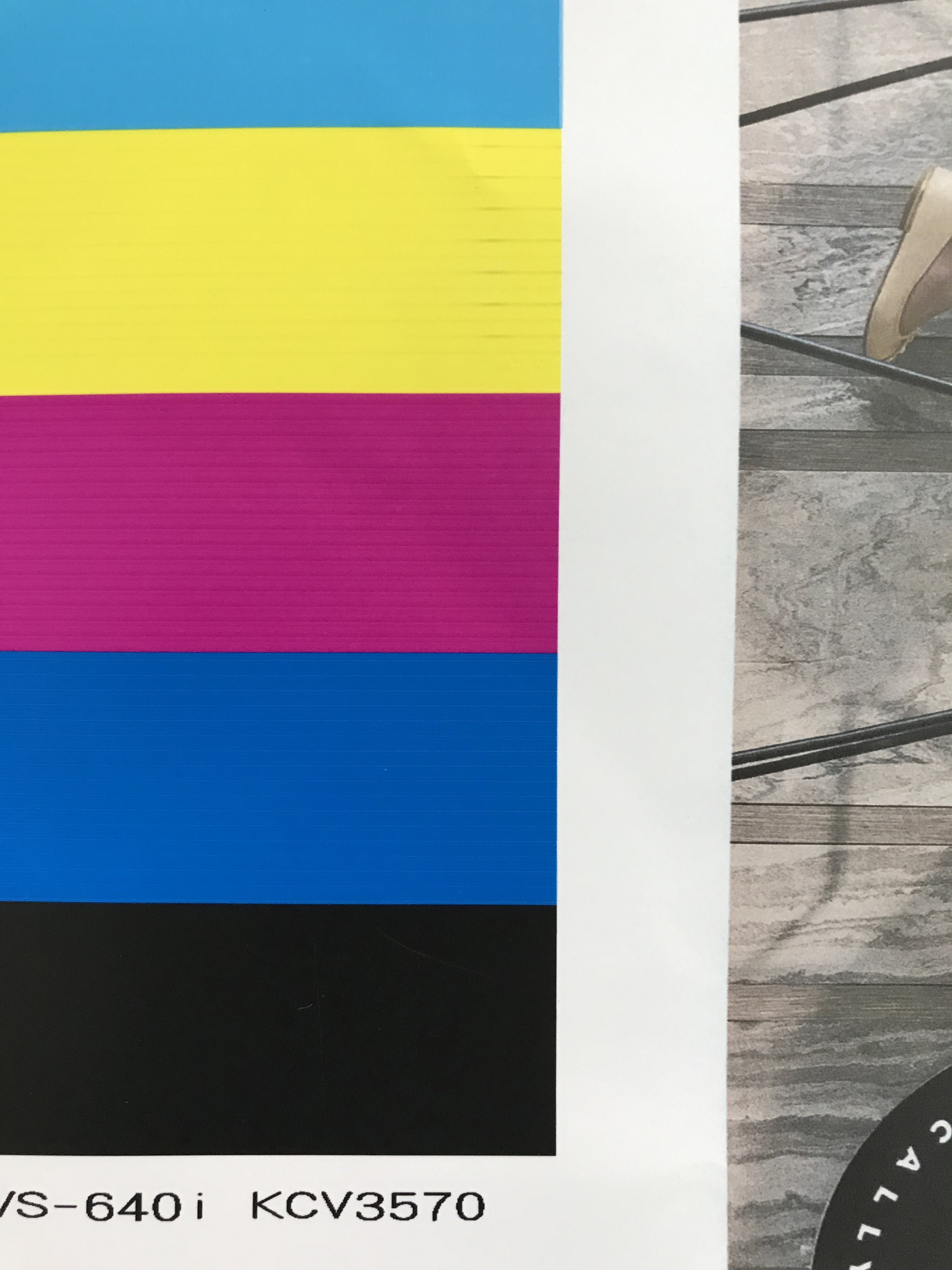

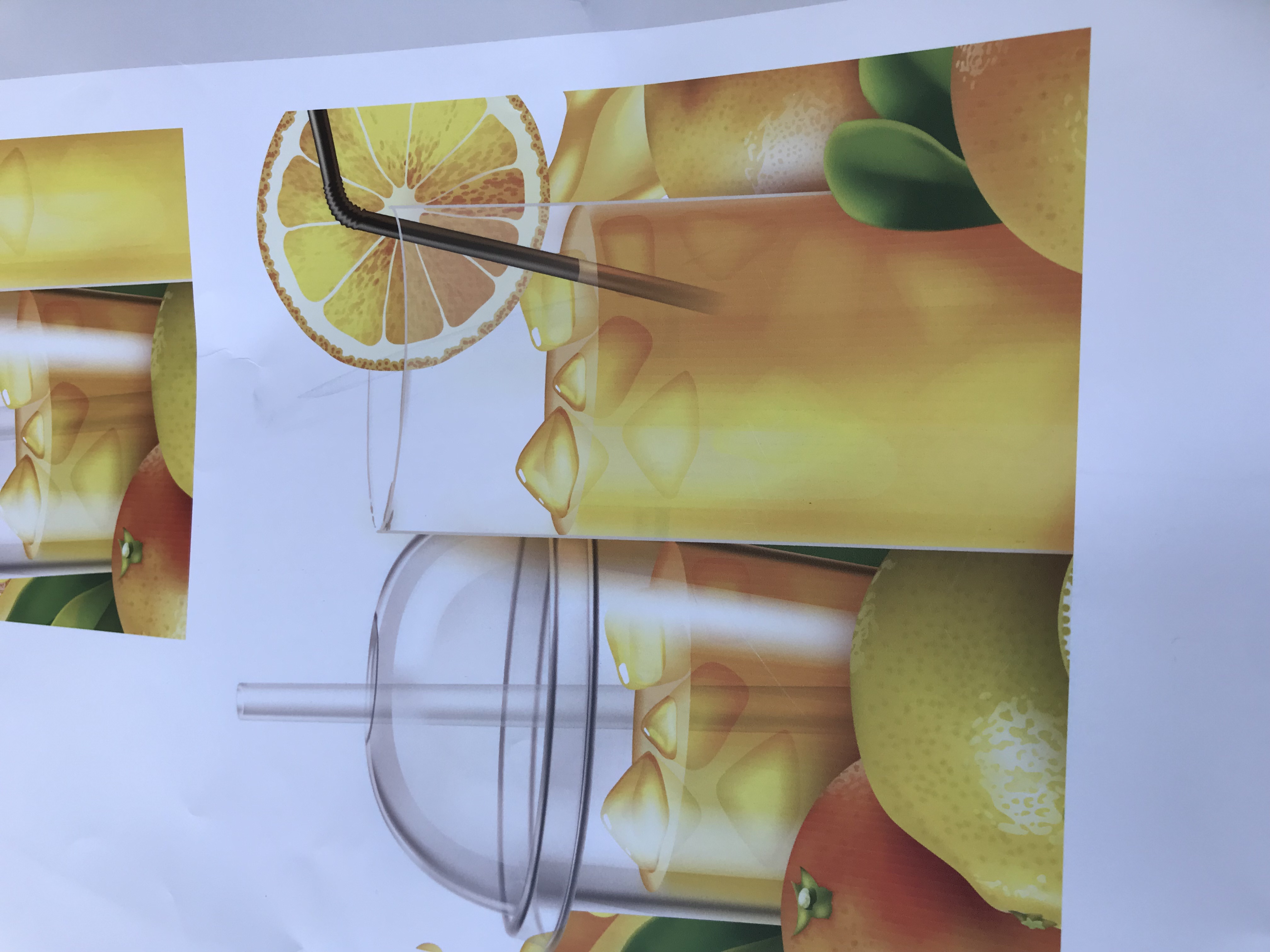

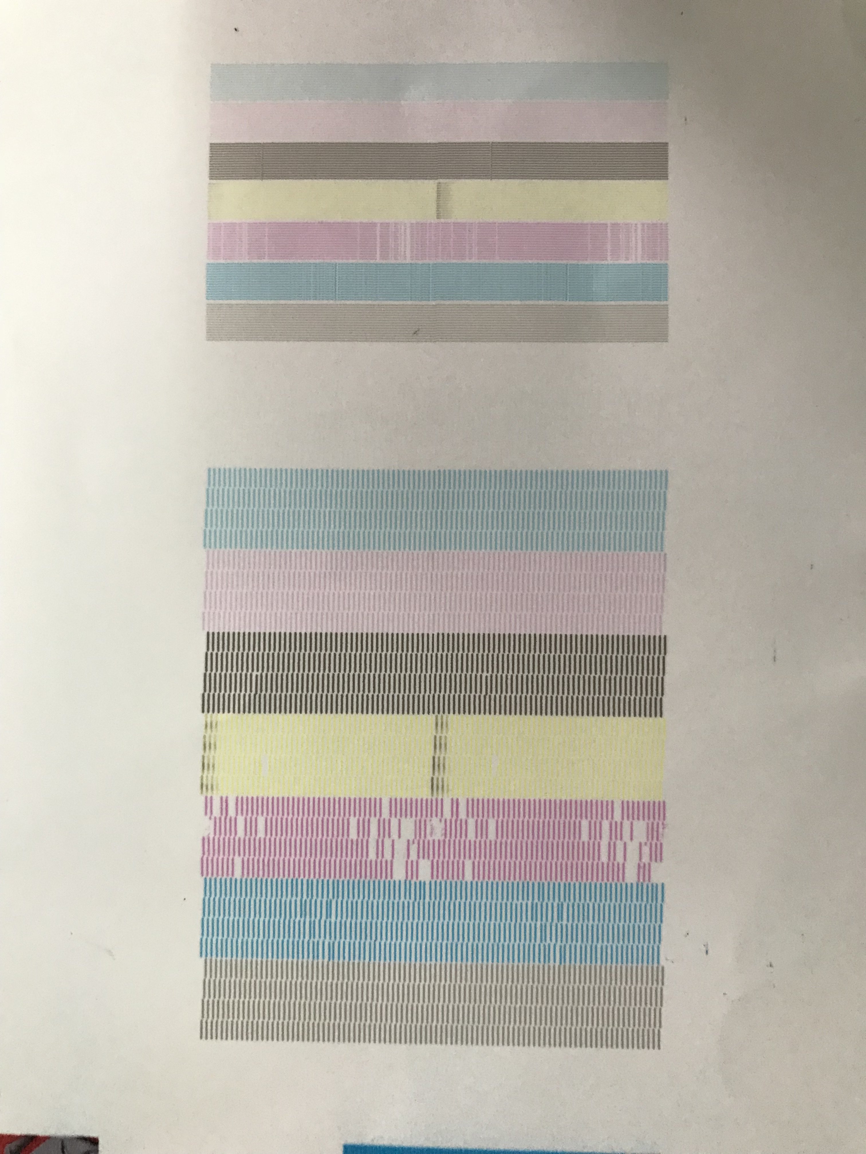

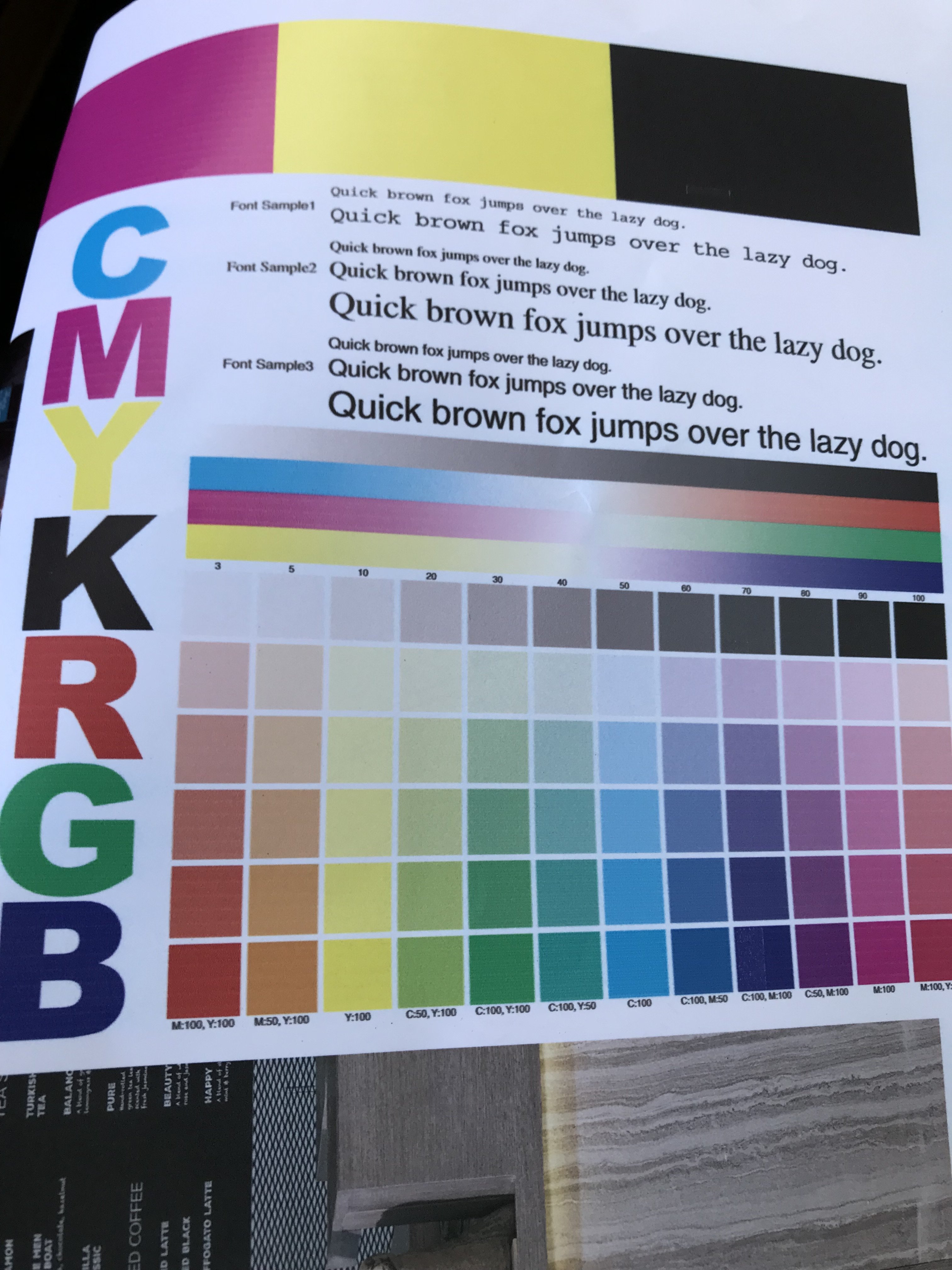

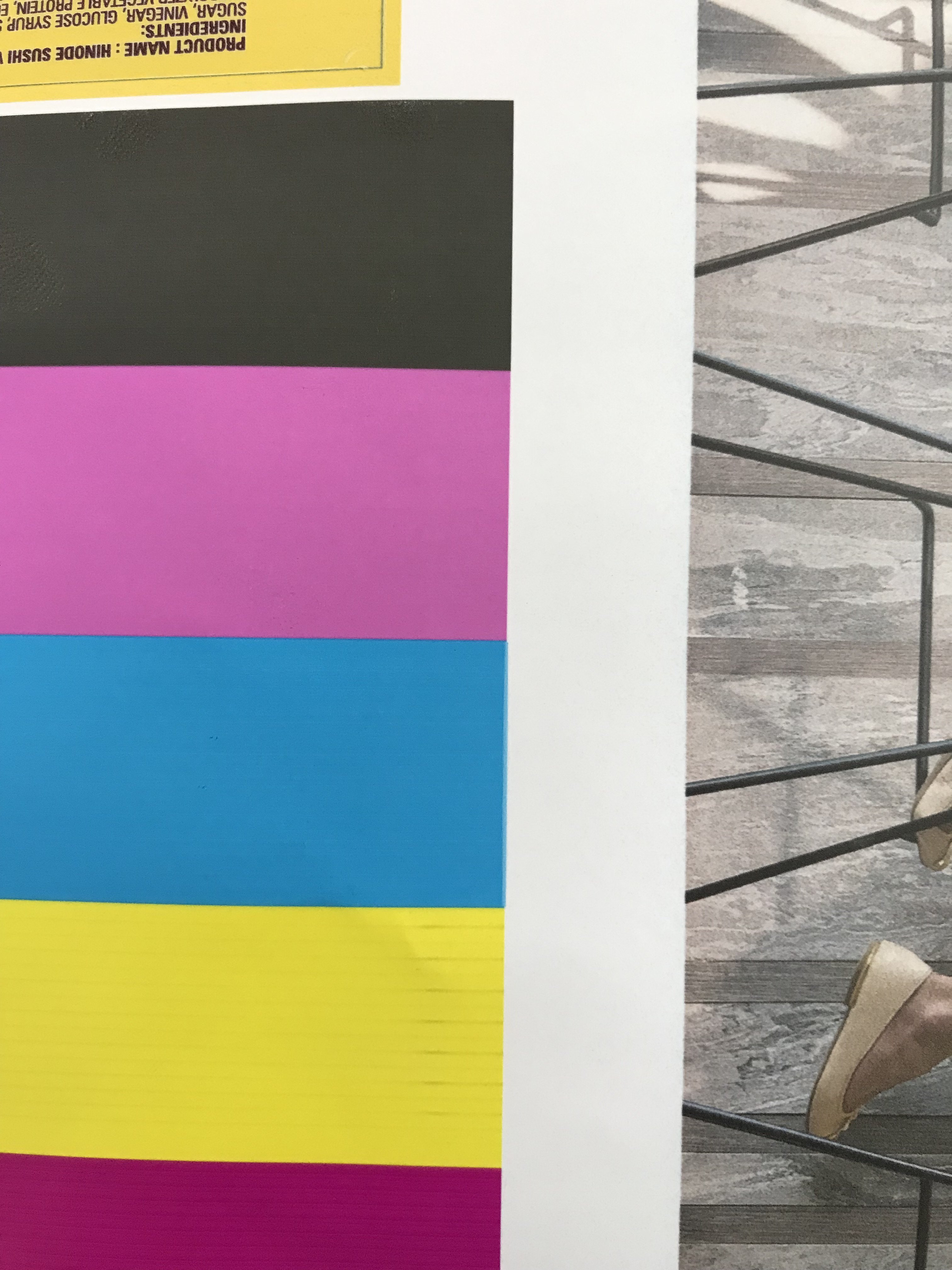

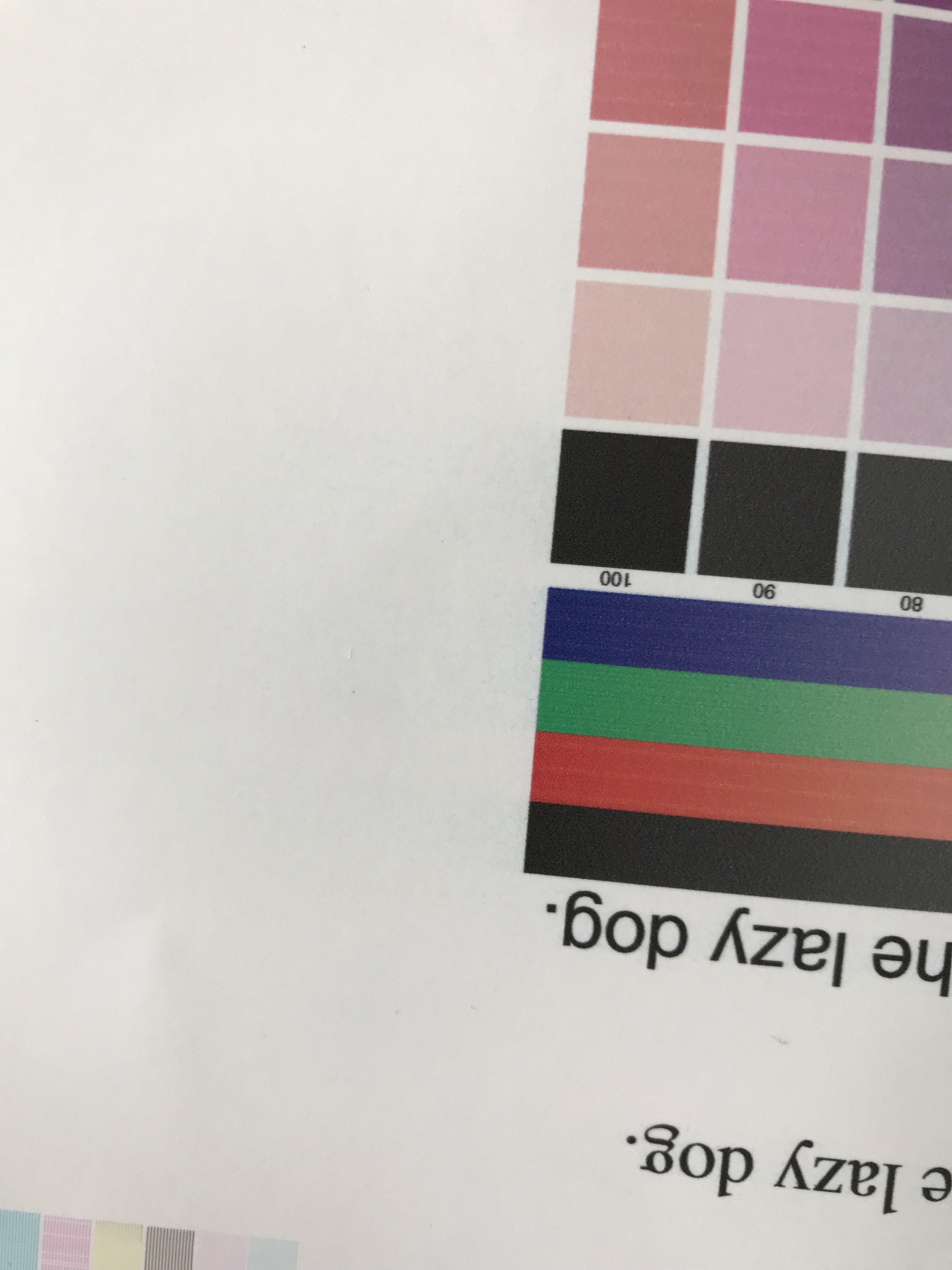

Vs-640i 7 colors, is printing gradient - Shadows and some other colors with a magenta tint.. Using Versa 6, tried different profiles same problem.
See attach pictures IMG_4750.jpg IMG_4751.jpg IMG_4752.jpg .
Flex cables have been cleaned - Dampers and Captop replaced - Head alignment checked and no anomalies found.
When looking closely at the prints a cyan mist can be seen. The prints have a cyan spraying all over but the print appears magenta.. Can someone explain what is happening.

Looks like you have some issues with the magenta and maybe yellow & cyan, however I don't think that would account for the magenta tint, I'm not sure if this is a common thing with these machines, however my VS-300I has always put more magenta into prints, therefore I always have to remove magenta in the color menu in Versaworks. My guess is to start, you'll need a new head.
Joe House
Sign Equipment Technician
If it wasn't an OEM cap top and dampers, I'd try that first, but Zoogee is probably right that you'll need a new head.
