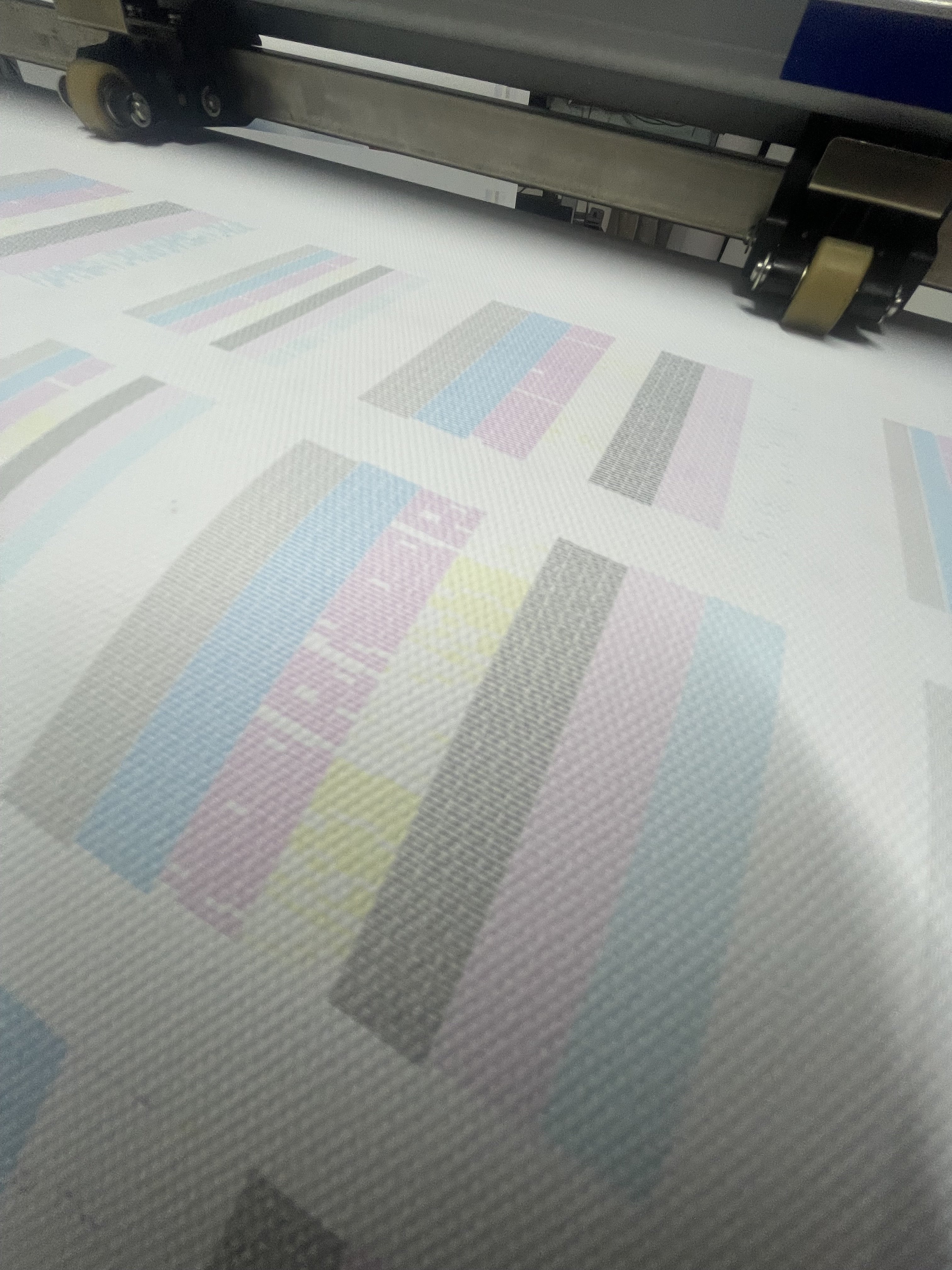

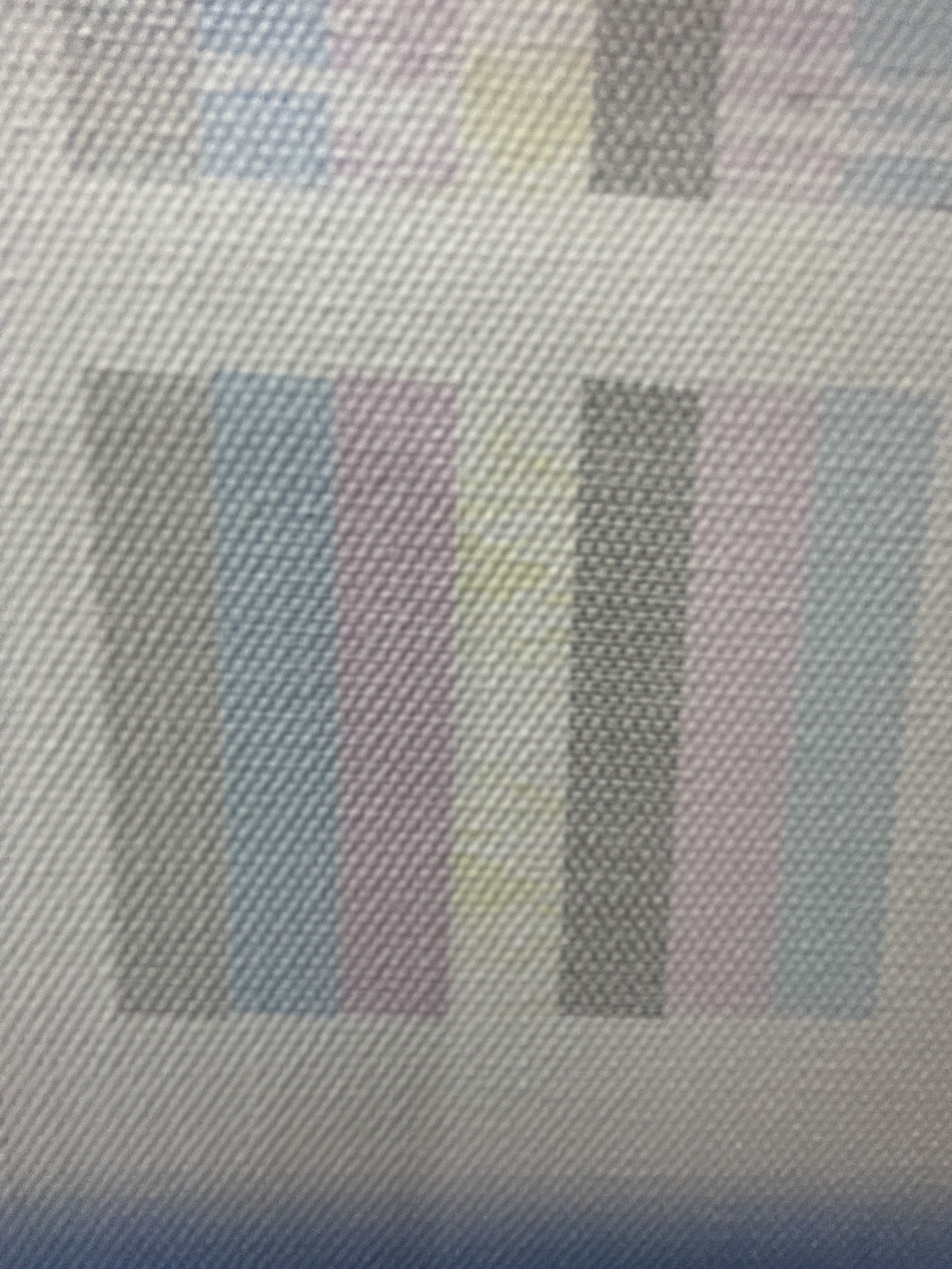

Norman1987
Here is a photo about test print

damonCA21
Assuming the head isnt faulty, it definitely looks like you have a lot of clogged nozzles there. If the captop isn't sealing properly it can just make one colour dry out and the nozzles clog. I would try an overnight head soak and see if that helps at all in clearing it first
