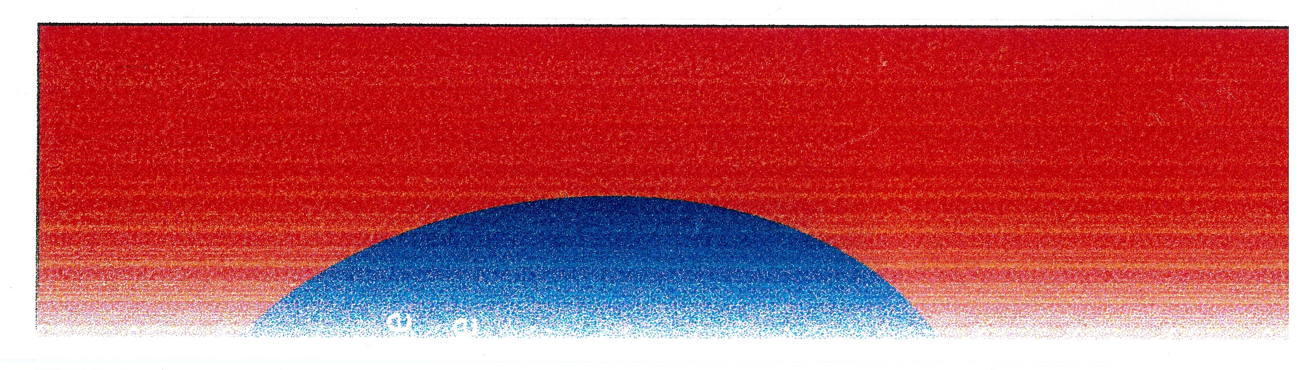

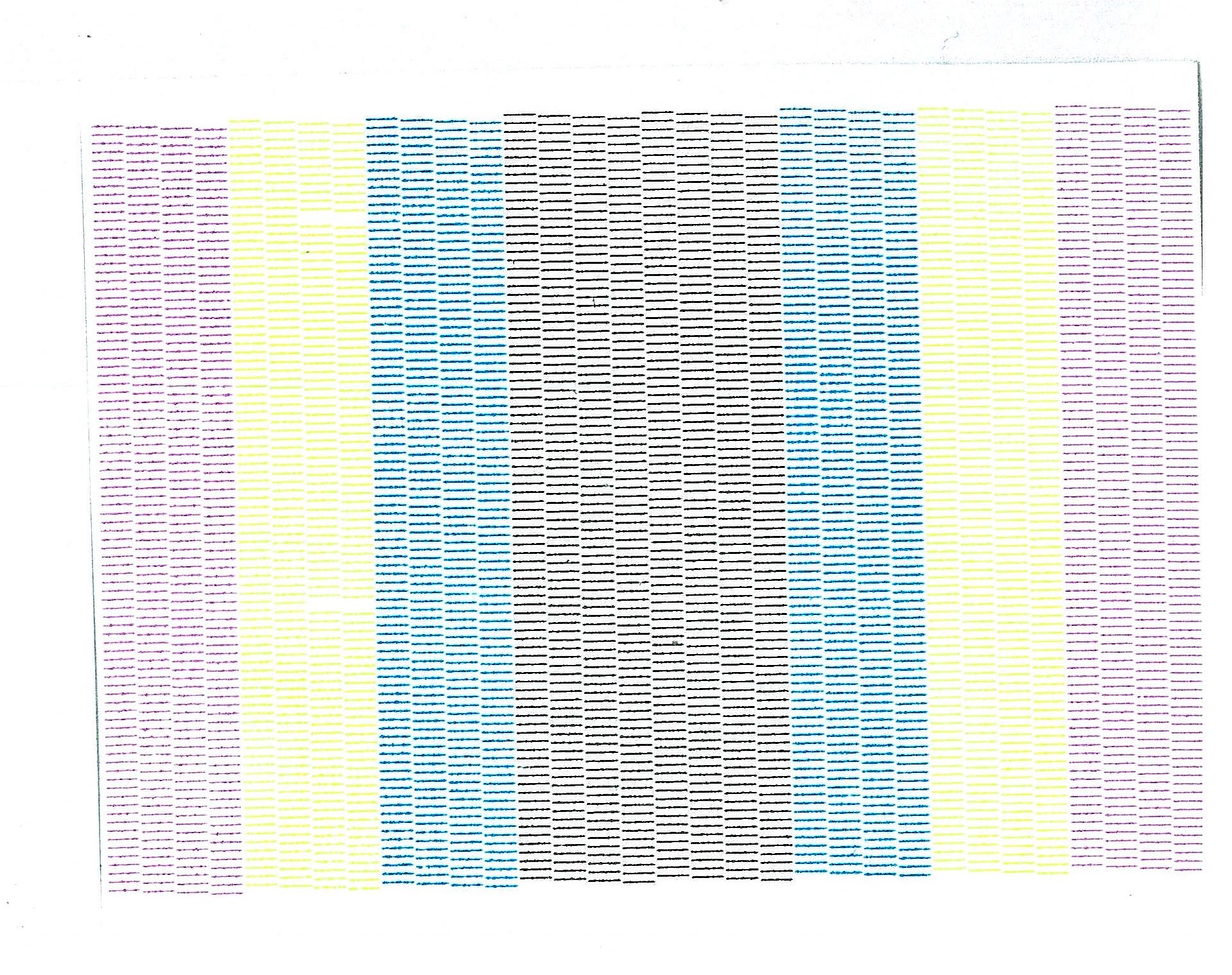

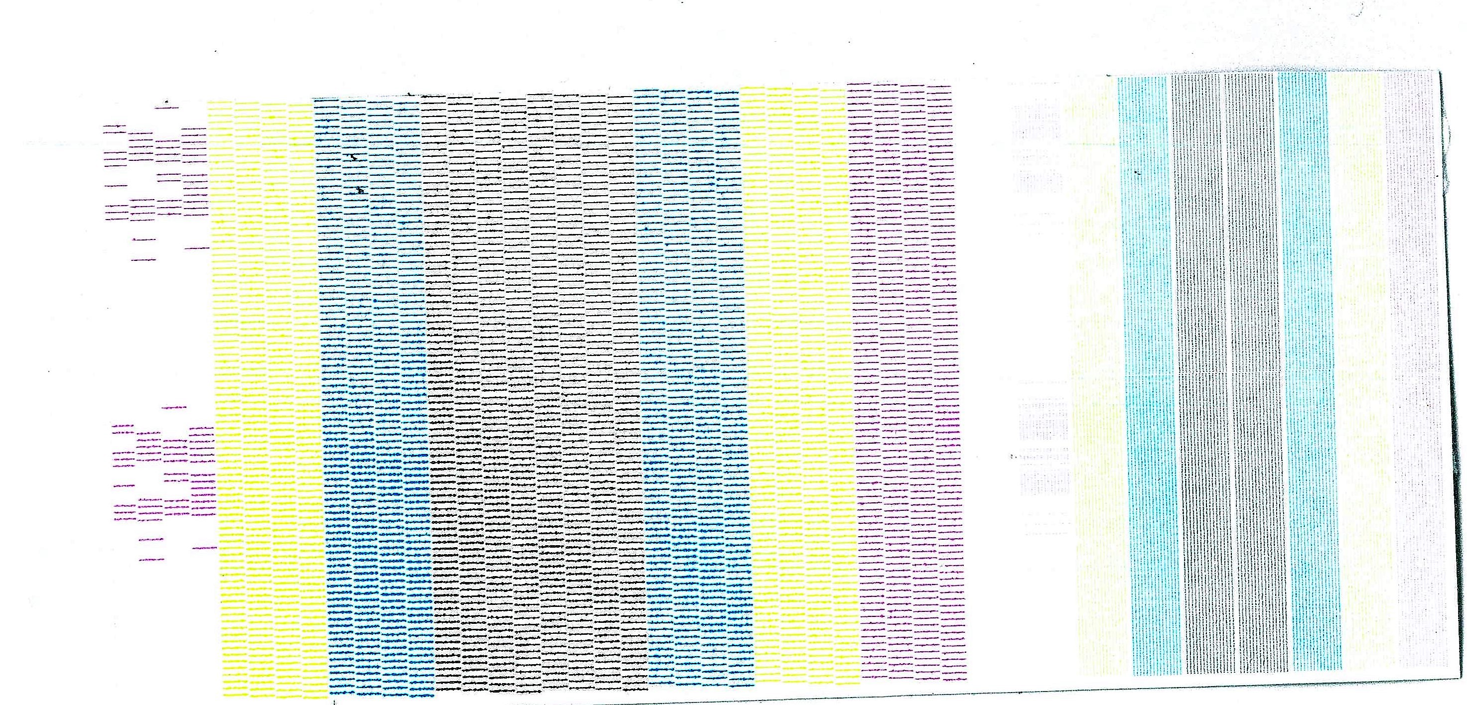

  • Before printing the test print is good.
  • Print launched High Speed - After some minutes lines on prints.
  • Stopped print and make another test print magenta missing, perform a powerful cleaning test print good again.
Anyone had ever encountered this issue..
