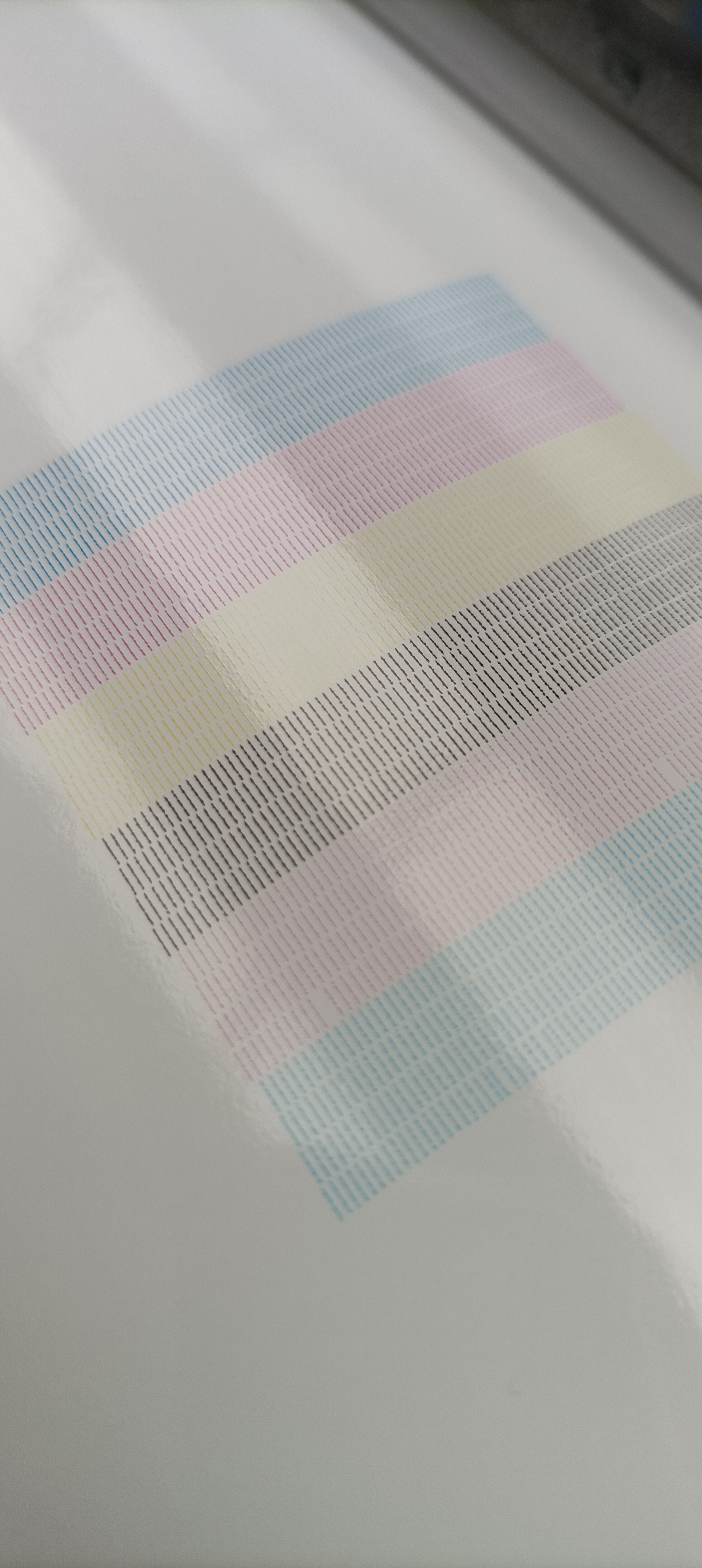

After several medium cleans and another 3 hour head soak the head was beginning to look it's old self but on closer inspection the lines were looking blobby and not smooth as in the attached image.

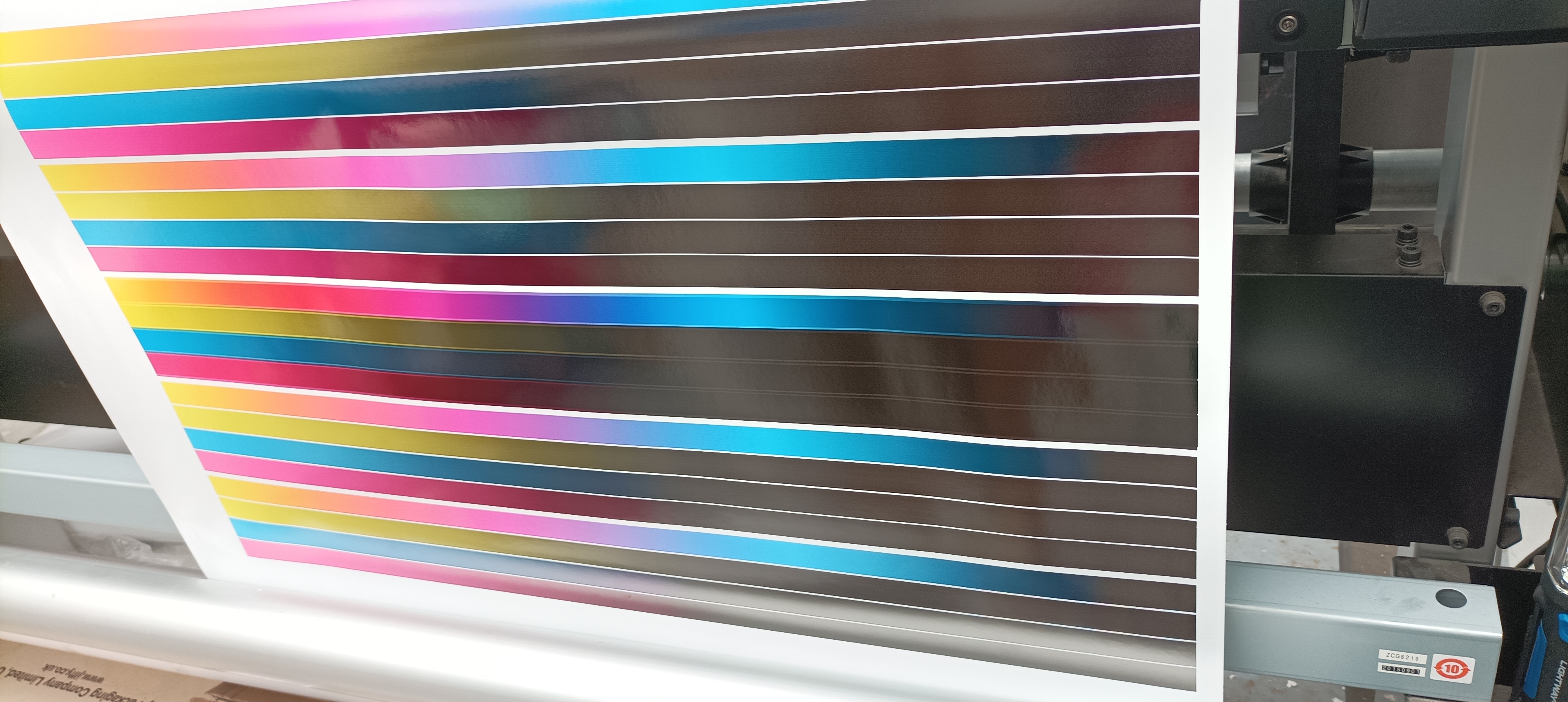

If I run a solid 700mm x 500mm rainbow pattern test piece the lines improved greatly almost 95% perfect, the next morning they are blobby again.
What else can I do/change to get it running perfect, have I missed anything.

That is a very weird test print ! Get a torch and magnifying glass and see if there is anything on the printhead face. Also check the captops, wipers etc. for any stray hairs.
It is likely the drying out and then soaking and cleaning has left nozzle damage. Too much cleaning can do this but its unusual for it to effect all the nozzles equally like on yours

To me it looks like the vinyl is sweating plasticizer or the ink is separating. Do you use a bulk system?

Hi, I've done the zoom-in check for hairs/fibers and all is clean. Had the cap top, felt and wiper changed about 3 weeks ago with oem genuine parts.
The strange thing is after a good test print the nozzle test print is fine then the next morning its back to been blobby

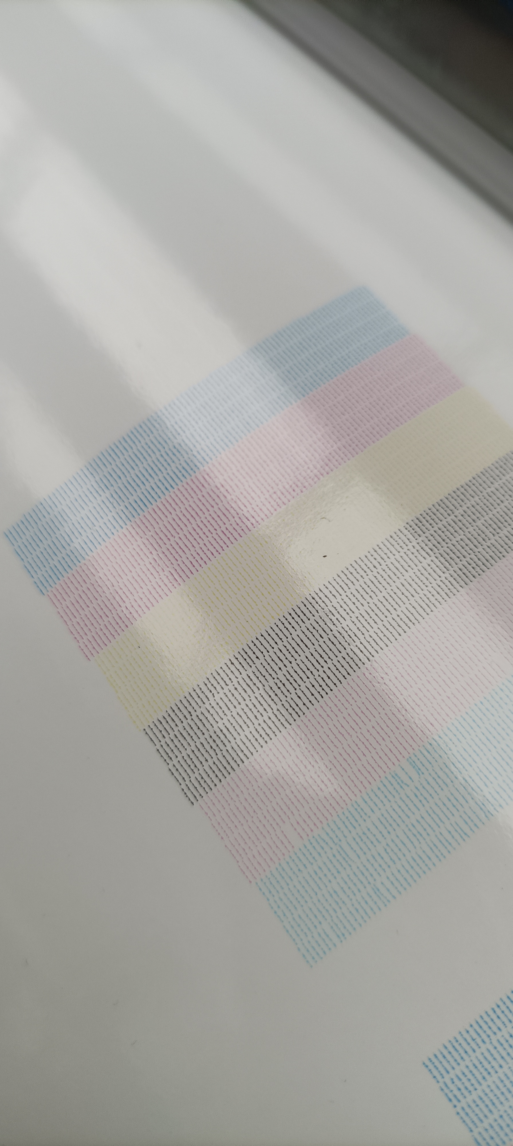

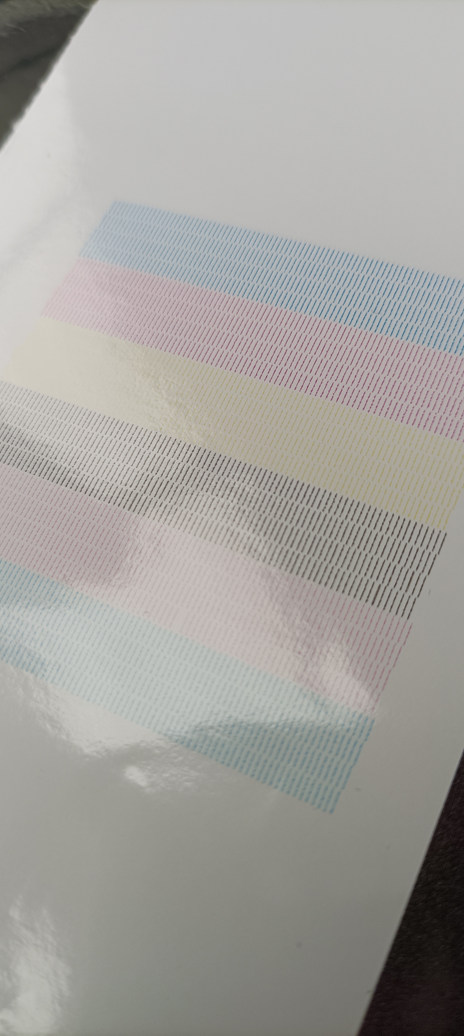

Having replaced all the dampers there is a slight improvement but I still have the bobbly effect on the nozzle test print.
If I do my rainbow test pattern
the nozzle check is much better but not perfect
IMG_20230715_092119.jpg .
pictures attached,
Is there anything else I could try before I bite the bullet with a new printhead?

I think it is probably new head time. The multiple soaks and cleanings could have damaged the nozzles, and you have ruled out pretty much everything else that could be a cause
