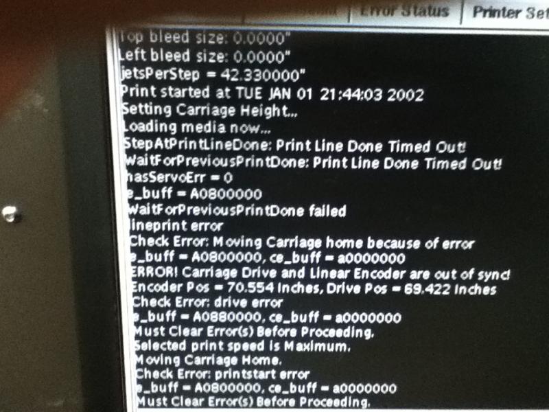

Well in that case, they jump right away to the motor solution...Im not agree with you saying that Vutek Print line error is unfixable...we use this machine non-stop almost 16 hours per days for years and no problem at all...From my understand the technician told me that between the encoder position and the Drive position you cannot get more than 0.10 difference between the 2 value. In my case i have more than 1.1 off.. (see picture)

My remark about the print line error being "unfixable" was more of a snide remark directed at Vutek. I've talked to their techs and have been told that random, once-every-other-month or so print line errors are basically normal for the QS series.
Anything more frequent than that is usually due to either sluggishness on the PC side (due to fragmentation/etc, which is why they recommend the reformat-and-reinstall as a matter of course) or a bad part.

Does the servo controller flash any error codes (e.g. E-0-7) when you get either a print line or encoder error message?
It's possible that the magnetic encoder strip got nicked. Do the errors occur in a specific place, or does it just seem to happen at a random position?
Wintersun
only error codes we get are servo error = 0
and e-buffer errors,and just random linear sync errors that put the print heads out of sync and print randomly on the media, we also get print line start errors.
if the motor is running warm to hot the printer can run for a while without the error happening.
