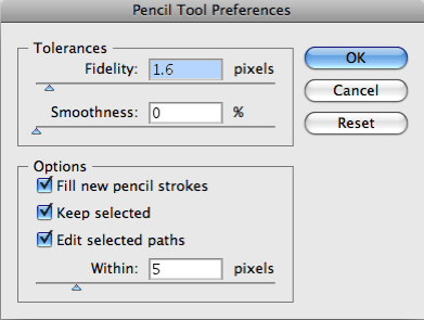

Hey guys, Just got my Wacom bamboo pen and touch tablet. I love it except for one little issue.
When i'm in Illustrator and use the pencil or paint brush tool and write something or draw, The path seems to be all connected which causes issues. It's like the paths from what is written or draw on the screen are connected to each other.
Is there a way to make them not connected like this?
If i draw a circle let's say, then try to draw a square over top of that, it won't show up as 2 shapes, it will make 1 weird shape canceling out what intersected between the two :doh:
Thanks!

uncheck keep selected
