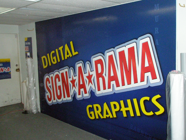

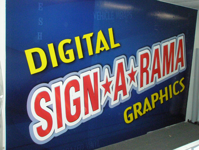

Hey guys,
I went ahead and installed this mural on a shop wall just to test how the vinyl would lay down and adhesion duration.
1. Oracal 3551 RA
2. Painted Drywall
3. No Lamination
Since I'm only testing this I didn't finish it with laminate or by running any heat over it to set it better.
The install went smooth and it adhered pretty well. I had already tested a smaller piece on it for several days and have some on a cement wall and a wooden door to see how it works. So far it's performing well unlaminated. We'll see what happens after a few months and when I decide to remove it...I can already imagine having to put new drywall up (only to test something else on it...lol).
jc

Other than the scratches due to no lam, the vinyl is holding excellent to the wall. The uploads are of a wall (another test) using oracal 3640 and covering with oracal clear 651. Heated during the install and post heated once done. The vinyl combination wasn't the best for conforming to the little details on the cement wall but it hasn't lifted anywhere. No edge sealer used at all. It's been up since july 2008.
