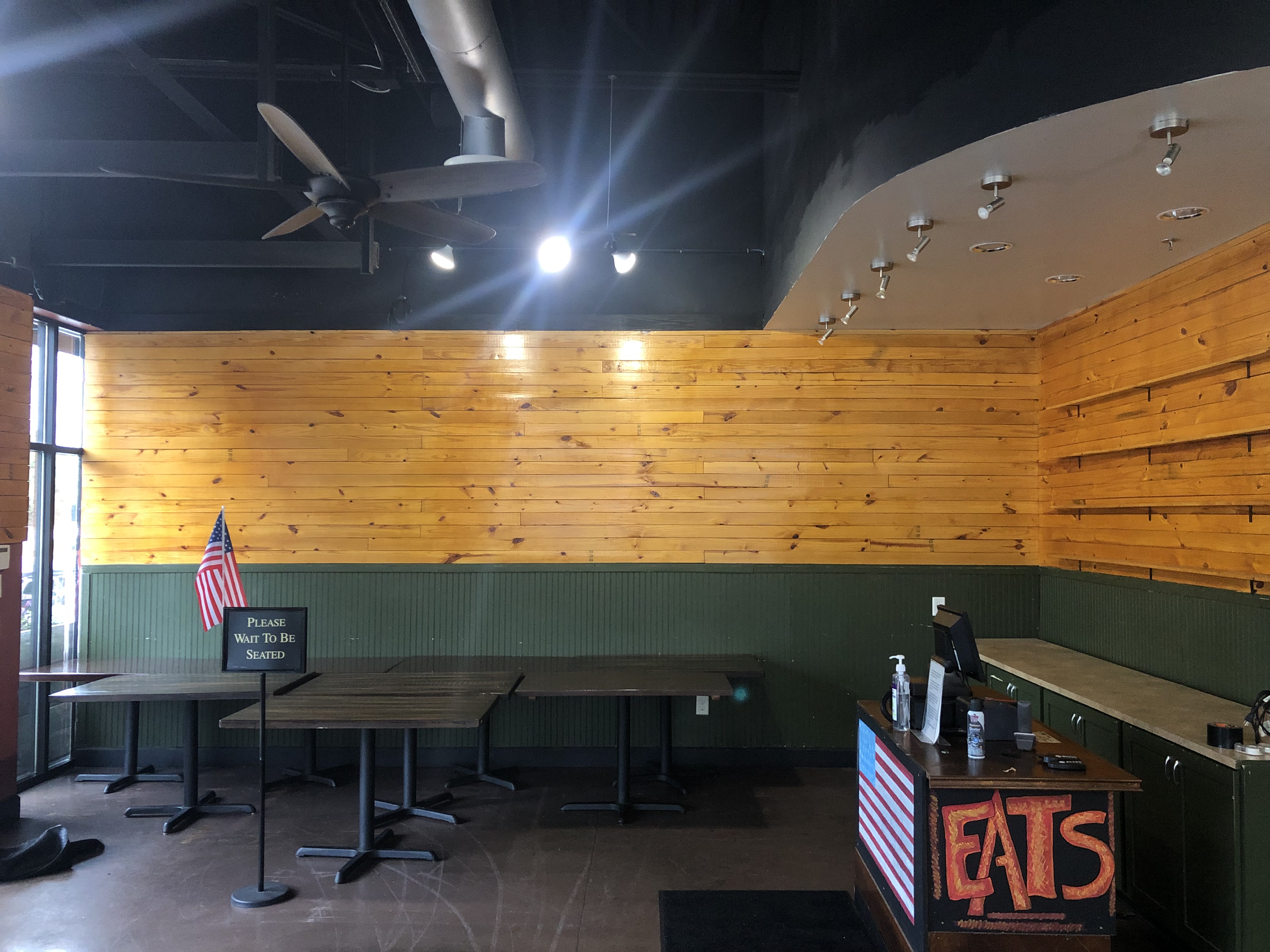

We have a client that wants several wall murals for their new restaurant. One 21 feet, another 31 feet and another one at 12 feet long. The first thought was to do a wall wrap, but the walls are made up of uneven wood planks, some lifted a bit. I'm not sure it's going to look great. The other option may be to mount the graphics on 4x8 ACMs with stand-offs. It would look a lot cleaner, but also cost a good bit more. What other options are there? Dye-sub with frames?
TIA!

I'm no wall mural expert but I should would not apply a vinyl wrap to that wall. I think your idea of ACMS or something similar with stand-offs is the way to go. It will also give that long boring wall some dimension.
I think by the time you calculate your cost of ACM/stand off installation and the time you will have in installing on planks it should be a wash. Just imagine how nice that would look with stand offs!!
Also, if I was sitting there waiting to eat I would poke my fingernail in the grooves and put a hole in the vinyl, I wouldn't mean to but it would be hard to resist...my son would probably use a knife or a toothpick. Of course that's besides the point but just saying...

I agree, mounted with standoffs. Don't cover that beautiful wood with vinyl. Is it indoors? Why ACM? Ultraboard would be less $$, and lighter.

Less $$ would be a net positive. Wouldn’t Ultraboard dent a bit easy though? What thickness would you use?
Ya can't use any kinda foam boards, especially in an eating place. Hafta be careful with the metal ones, too. Someone could run their hand along it, like a customer's kid or even an employee cleaning it and cut themselves real good. Ya also hafta consider using the right kinda inks and whatnot, cause you're close to people eating. There are food regulations directing you on what you can and cannot use around food, while serving and/or eating.

It won't dent like foam core. It's got a polystyrene face on it. I don't see why you couldn't use it on a wall in a restaurant.

This is one of those jobs that is perfect for sub-contracting out the work to an Old-School "Sign Writer".
You know... those guys and gals that know how to swing a brush loaded up with paint and make magic happen.
Mark it up and everyone wins!

You could try 3M Envsion which is made to go on bricks and everything uneven. Would probably look pretty cool over that wood. I have used in many occasions when the surface is very uneven.

1. What is their vision? What do they want on those walls?
2. Who's idea was it to use vinyl wall wrap on there?
3. Where did your client come from?
It sounds like they went to someone, who recommended a vinyl wall wrap, didn't like the price and are now tire kicking based on that initial stupid suggestion.
