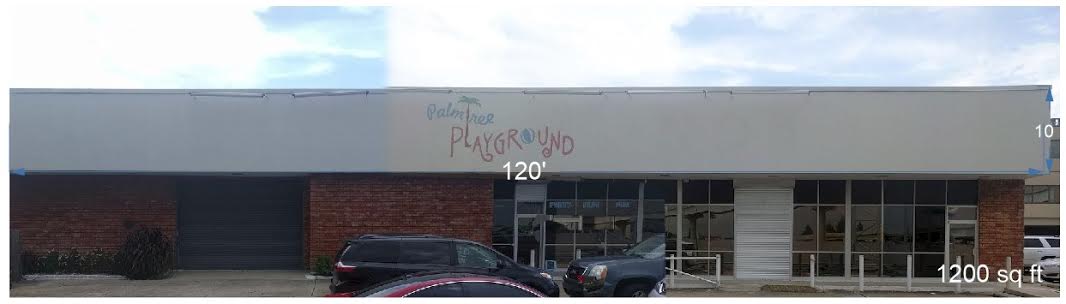

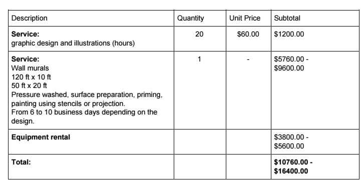

I am looking for some guidance/reassurance on a plan I have developed for a wall mural project. It is for two walls that need to be pressure washed and prepped (spot primed) then fully repainted with a new design. We are thinking that the project will take 2 weeks labor with 2 workers at $60/hr studio rate ($960/day) plus cost of rental equipment, a bucket truck for instance, and $1200 for hiring out for the new design. We are planning on painting it with either a stencil or some sort of projection of the design onto the wall. Does this seem like we are headed in the right direction? confirmation or input would be great.
dimensions:
wall 1: 1200 sq ft
wall 2: 1000 sq ft

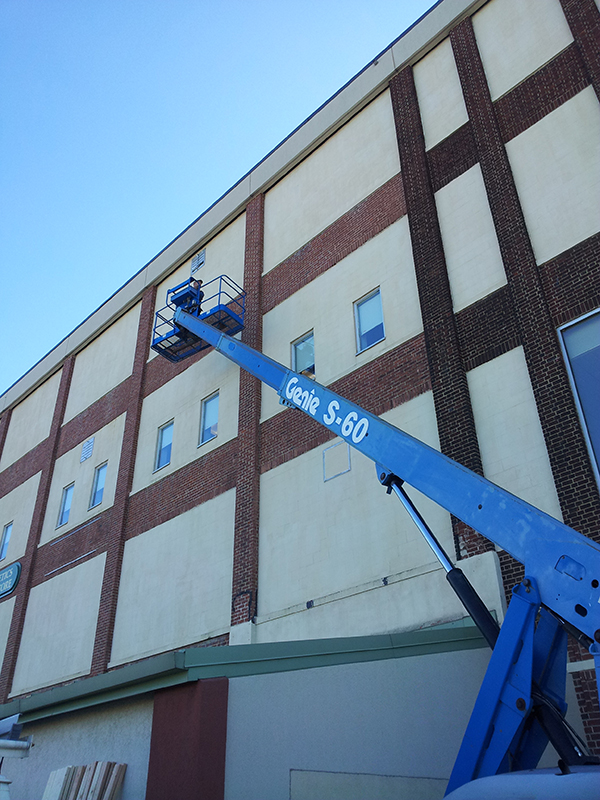

We weren't painting, but installing banners this day, but even this would be overkill, however much much easier than scaffolding or a bucket, plus you have about a 42" x 96" platform from which to work. We were both up there all day and it is so secure, it's unreal.

I think that is the layout with the deminsions in post #1 with the Palm Tree Playground on the wall. If it is, then scaffolding, ladders, bucket truck, whatever, should not take that long to do. A scale drawing is all you need to do that, You might be overthinking it.

I am glad to post the design but it does not exist yet.
I sent the estimate on Monday and have not heard from them yet.
How in the world do you quote on something and have no idea what you're gonna be doing ??

how did you quote 20 hours for graphic design and not design anything and if it took 20 hours to design these walls then your quote for painting them is way off. Im kind of lost on this post
