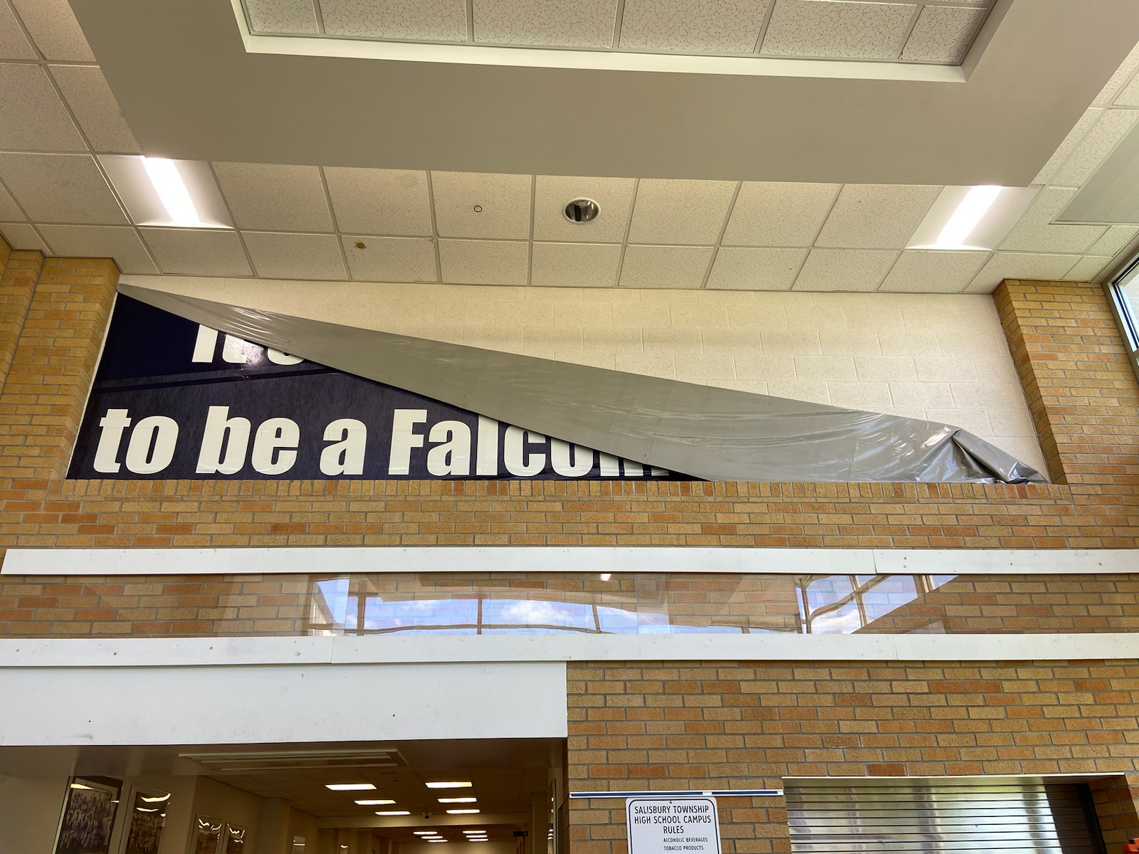

Installed for local print shop. No we did not adhesion test. Shop didn't want to pay. Material is IJ35C/8509 lam. We cleaned the wall with alcohol, rolled and post heated. We have done many of these with no issues, some in the same building. They want to know if we could save it. I said no. Would you try another material, or paint the wall with Guardz? Paste it back up with glue size? (horror)
Suggestions welcome, hold the sarcasm please.
