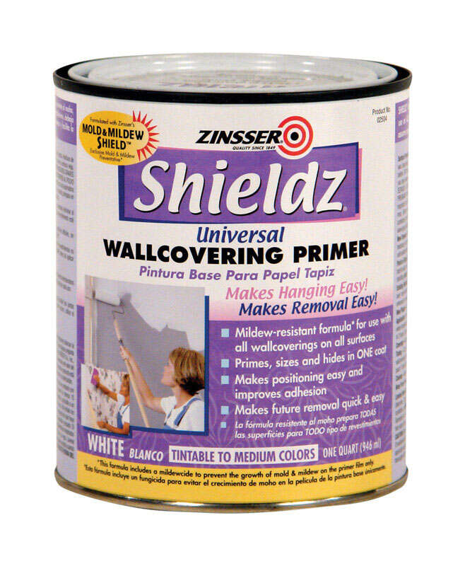

Is anyone using and having success with this product to prime Low VOC painted walls to accept self-adhesive vinyl graphics?

Do you have a wall test kit? Have you tried IJ180cv3? It costs more, but not really if you are going to spend time priming a wall. Give it try.
In California, almost every wall is painted with low VOC paints. I have found IJ180 to be quite versatile in many, many situations.
Give it try using a test kit, and see if it will work for you.
Hope this helps.

Yes. When we do wall wraps I tell my customers to paint the wall with Zinsser if they are remodeling anyway. If painting isn't an option, I usually use 3MIJ180Cv3 like Precision mentioned. I've also wrapped walls with Arlon 8200 which has a higher tack. But I always do a test for my customers so they can see the difference in the products and how well they will hold up.

What happens when you remove these wall wraps? It seems like you would almost have to re-sheetrock a lot of these.
We've had excellent results with Gardz (all big box stores carry it). It's a raw drywall primer, but it dries clear and cast vinyl (haven't tried calendared) sticks well to it. It will change the sheen of the wall slightly, so generally the entire wall has to be treated.
we have had fairly good results by tinting zinsser or kilz
it is still difficult to get real adhesion to certain paint formulations
