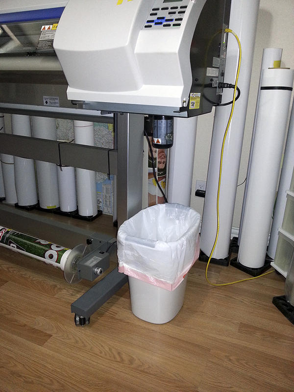

I always keep a Rubbermaid trash can under my printer just below the waste ink bottle, I have never had an over flow situation (YET), but I believe in being prepared (insurance), because of reading stories like this post. Very easy and will prevent the floor from being ruined.
