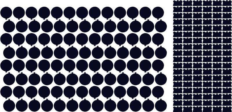

I contacted my local waterjet cutting place. Have a 4x8 sheet of lexan that i want to cut about 125 little ornaments for Christmas. It is just the outline of them because i will be putting decals on them later
Gave them the file and would bring the lexan..

Seems high, especially if you are giving them the cut lines...but I don't know much about that industry. The guy around here cut basketballs for us out of 18" X 24" Cor-X Blanks for $2 each. Maybe he was doing me a favor though.
We get our acrylic CNC cut all the time... I'm not sure that 1/4" lexan would be that different...?
Could you do this?

I know that CNC waterjets are incredibly expensive compared to a CNC router table. The quote you got may be based on and hourly rate. I run my table for $100 per hour but your waterjet company might run theirs at a higher rate if they paid $200k compared to the $70k I paid for my router.
So I can't really tell you if that's a high quote or not but I'm sure it would be higher compared to me just based on the price to get in the game.
yes you could cut those on a cnc router. i dont think the price you were quoted was out of line you are dealing with expensive technology that needs to be paid for...dont like the price hack up that sheet into more manageable pieces and get busy with the scroll saw.

It can be cut with a CNC router. Just the inside corners won't as sharp as waterjet or laser. My local guy charge me $100 per hour as well.

Laser cut them and go with acrylic, that waterjet price is astronomical. I had our laser folks cut something very similar to that as far as complexity out of 3/8" acrylic and it cost us $110 for a 4x8' sheet.

The last time I had Abrasive Waterjet cutting done was a few years ago. The price was based on inches of cutting distance regardless of thickness so we cut our substrate into smaller sections, stacked it and supplied a nested file based on our stacked cut size which cut our total costs for AWJC down to about 1/10 of the cost. Just an idea to explore....

Not sure where he sees 2-3 minutes a piece on those unless he's got a 25W laser. Find someone with a 60W or more laser and it's probably less than a minute each. Ideally, you'd want something in the 100W or more to do it. Ours is 50W so it will probably be slower, but it'll give you an idea.
If you send me a file, I'll run one and tell you exactly how long it takes.

If that file is on a 8' x 4' sheet it would take between 1hr-1.5hrs to cut on a cnc router..quarter to half that time on a good laser (1500 - 2000 watt)..try find someone with an industrial laser...take advantage of this and set up a relationship with them for future jobs...look for someone with a cnc router as well and do the same thing...advertise and push for more jobs like this...if customers say they didn't know you have all that equipment tell them you're in a 'pool'....less overhead means better pricing for them, they love the idea.
