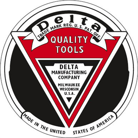

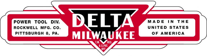

I have made a few for vintage Delta woodworking machine decals for restorations, they turn out great, but I have only used a HP photo desktop printer to do them. A few guys on an old woodworking forum I visit have vectorized a bunch of these old decals from other manufacurers as well. They really add to a machines restoration.
Auto retoration shops replicate decals too.
You can buy it in clear or white. There is a spray clear coat as well.
