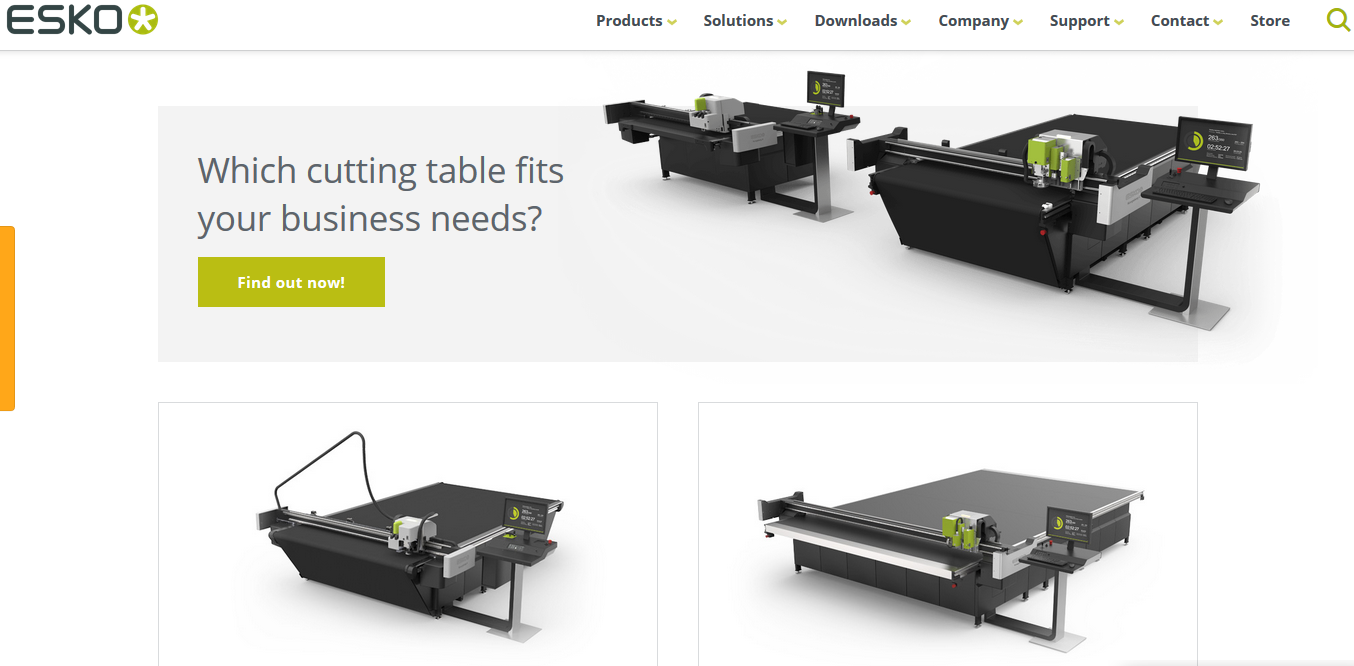

We are needing more finishing options outside of a panel saw. We are torn between a Router and I don't even know what you'd call this...flatbed cutter? Personally I'd think the router would be more useful day to day, but I don't know anything about flatbed cutters. We mostly do coro acm pvc the usual stuff but want to increase our productivity and make more shaped signs versus square with the current panel saw setup (and jigsaw)
Thanks!
