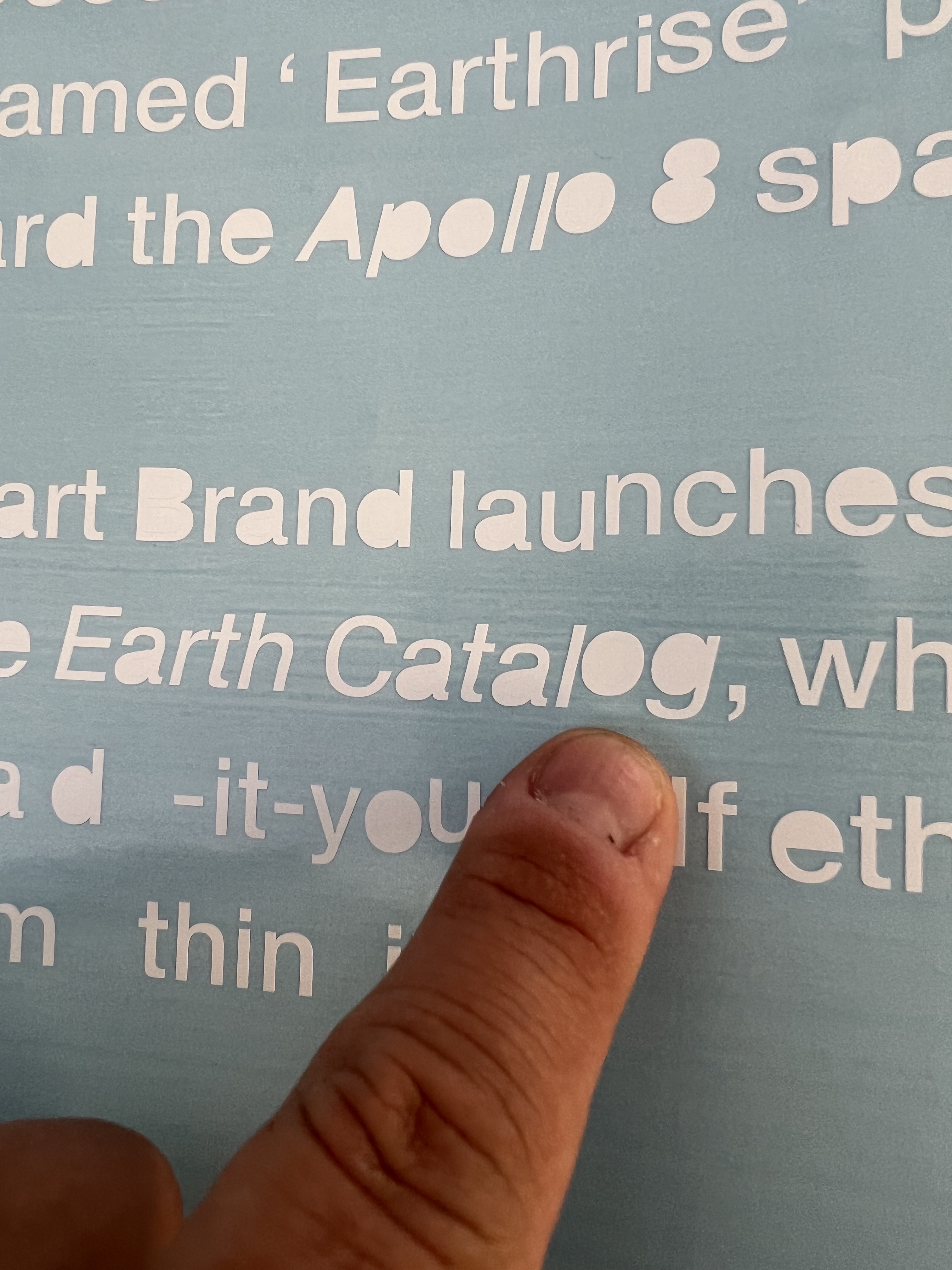

my Graphtec being cranky cutting lines off level, see pics not even sure how to describe this. Material? pinch rollers? machine old?

Is the cutting blade attachment screwed in tight? Mine got loose recently and cuts were all the over place like that.
ikarasu
Is it cutting line by line, orndod it cut that u at the end?
I've had it happen where it cut every letter BUT the insides.... Cut like 7 ft of letters, went back to do the insides and the material shifted and ended up cutting way off.
Theretically you should be able to cut something, have it go 8 ft and cut a letter, have it come back and cut the next and it should still align... But it's a roller fed plotter and sometimes it'll stick or catch and not be perfect. So my guess is it's not cutting in order, came back and then cut the letter in a different spot
