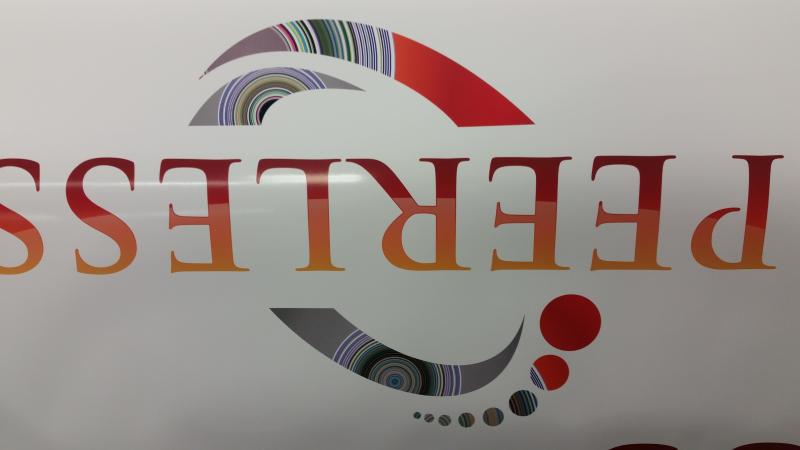

We have had Onyx11 for about a year, and recently had a problem with it. so, after an uninstall and a re-install I'm having an issue with fade/gradients.
Files are saved as an eps with a cutpth. Color should fade from red to orange to yellow. I'm plum out of ideas...and of course, customer is coming in tomorrow morning to have his vehicle lettered.
Thank you for any ideas

Not a fix for your problem but couldn't you rasterize the gradients into bitmaps?
Get your customer out the door and then go back and trouble shoot what looks like an eps parsing error.

I JUST had this happen for the first time EVER about two weeks ago.
(Exact same circles in the radial gradients from Illustrator)
I have even printed from the same artwork in the past w/o issues.
I rasterized the artwork and overlaid the cut paths and everything was fine.
*this was also on Onyx11 with an EPS coming from Illustrator CS5.1

would it be possible to change the artwork to a .pdf format? Onyx and other RIP providers are migrating towards a .pdf format print service. We have had similar issues here and have solved them in various ways. By changing the file to a .pdf seems to be the quickest and easiest.

+1 for PDF solution. My Onyx has a host of issues with EPS files that Versaworks has no problems with.
Made the move to exporting designs in PDF and all problems have disappeared.

So, after siting on the phone with the corporate help desk, he contacted Onyx, and apparently Onyx11 has issues with radial gradients. They said to go under setup, rip configuration, configure Jaws rip, and to check the CCADL box. They also said that if that didn't work, to save gradients s bitmaps, and to save s pdf.
