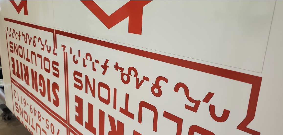

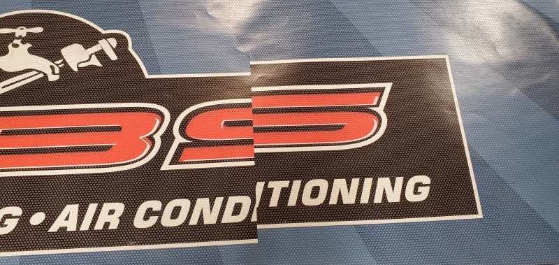

Anyone ever seen this issue on an HP 360. For that matter it may be a Flexi problem (presently using the cloud verson). see the attached print. (this happens to be on perf).
Seems to be happening randomly near the end of prints. This last one happened three time in a row on the same file.

In theory the encoder could be at fault if he was printing on something less than the max width of the printer. Though it would be pretty magical for debris to float into a solid enough pattern to cleanly offset an inch, then to dissipate before the printer did the next full rail sweep at the end of the print. Cloud based RIP sounds like a tremendously stupid idea on Flexi's part.
I tend to agree. The error is too clinical. I've had many encoder strip problems over the years but for the sake of abundance of caution I did a thorough cleaning today as well as changing my ethernet cable from cat5e to cat6. Problem still persists.
My spider senses are telling me software also.

and this is after a thorough encoder strip cleaning ( and this is a clean machine to start with).
Again .. near the end of a print. This was a jpg imported from CorelDraw
