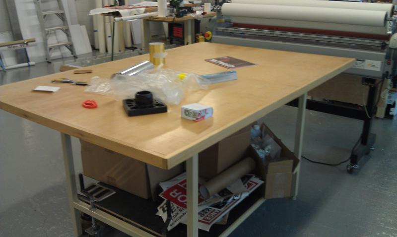

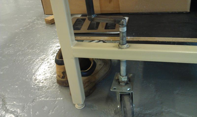

SIGNTIME
utilize the underneath of your table with a shelf or two and we made wheels welded to treaded rod with a handle so we could screw them down to move the table and screw them up so the table is planted firmly on the ground I will post pics when i get a chance... we are also going to be building another couple of tables here soon when we get the addition finished up
SIGNTIME
here are a couple of pics(shop it a disaster and will be for another month) we plan on building 2 new tables 1 5x12 and 1 5x10 for each side of the laminator and put a couple of latches to latch them together when needed but we may only make them 55" wide to match our laminator as anything over 54" is considered a specialty in this shop... the table in the pic is our small table 4x6

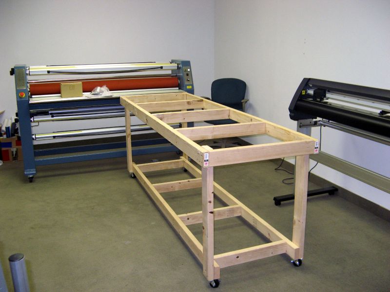

pjfmeister
Our main table is a 6'x24' built with 2x4's and 3/4"MDF, top covered with 2 - 6x12 large self healing cutting mat....lots of room underneath the top for large open flat shelves, sliding drawer style shelves and substrate racks....

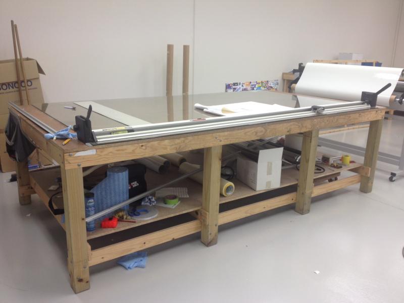

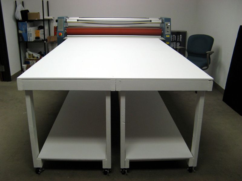

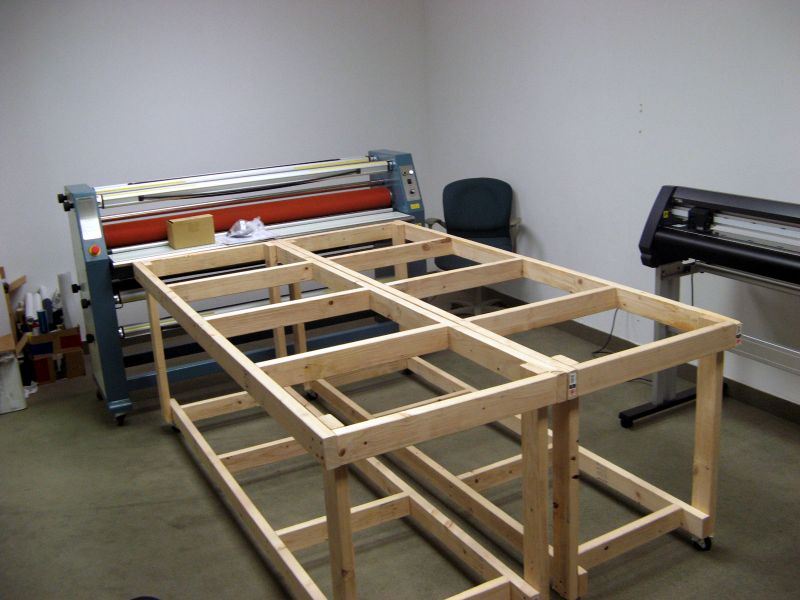

mnapuran
Old pics... but you will get the idea.
I built these as 2.5'x8' rolling tables. Bolted 2 together side by side to get a 5'x8' work table. You can add more to get more length as well. This give quite a bit of flexibility, and you can roll them individually through a standard door (if you ever move, or need to)
Topped with a 5'x8' cutting mat, and shelf space underneath for storage.
