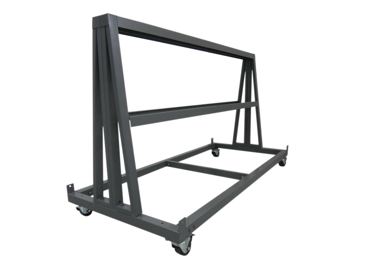

Thread revival, now it's my turn to move and set up shop. Eventually I'll build shelving to hold large sheets flat but for starters I'm needing a rolling substrate rack to hold and move around larger panels. Signworld has one I like, and Uline has a couple models as well. These are all around $500. Does anyone use anything like this and do they work for you?

We do. I LOVE it! Ours just has one rack/handle, but it's like the orange one.

I use a drywall cart. I added some 2x4's to extend it to make it where I can move 5x12s on it without too much flop.

We have old wood A-frame carts that we use constantly. We do a lot of acrylic work too so having an anti-static air gun has proved immeasurably helpful.

We built our own cart, which looks a lot like the red one
It is loaded with substrate or I would take images
Used 2x2x3/8 angle iron for the frame, scrap MDO for the floor, welded sucker-rod on each end to create "trays" put oversized PVC pipe over the sucker-rod so the substrate slides in/out without damaging
Hindsight
* Should have made the wheels larger and locking
* Used a "slick" material on top of the MDO so the material slides more easily
